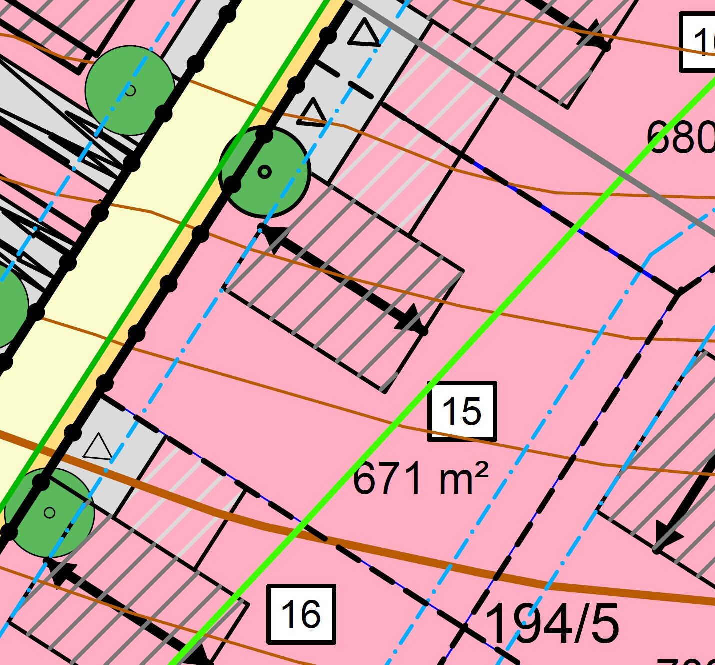

after purchasing the plot in February last year, which was fully serviced by the end of last year, we have been gathering inspiration and planning ever since. Despite rising costs and interest rates, we are excited about building our house, including some DIY work.
Plot size: 669 m² (7200 sq ft approx.)
Slope: South-facing slope, 3.90 m (12.8 ft) diagonal (approx. 7.3° incline at the street side)
Site occupancy index: 0.4

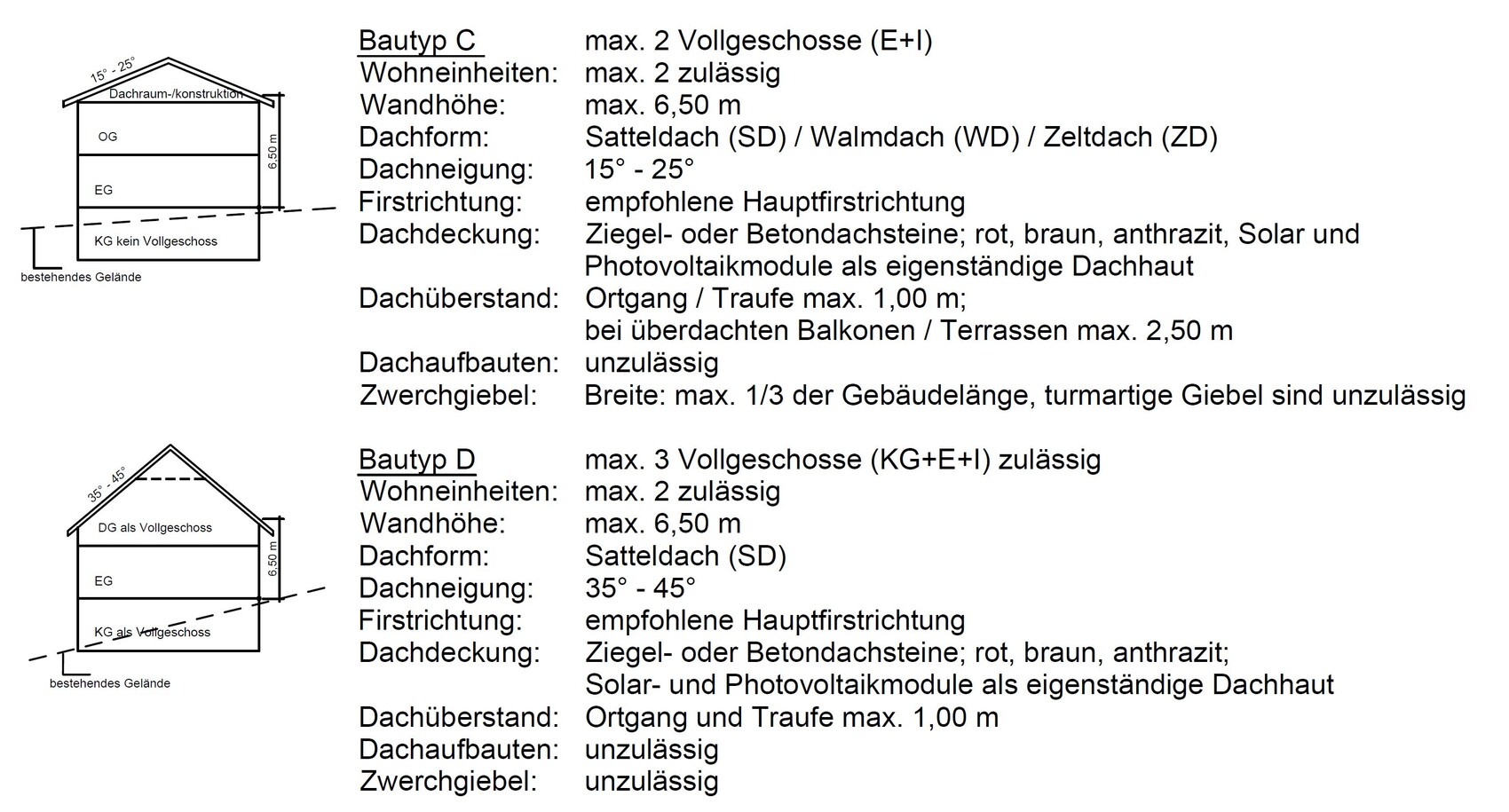

Number of stories: 3 full stories (basement, ground floor, upper floor)
Roof style: gable roof with 35° to 45° pitch (if basement is not a full floor, then 15° to 25°)
Architectural style
Orientation: see draft sketch
Maximum heights / limits: wall height 6.50 m (21.3 ft) measured from finished floor level of the ground floor to the junction of wall and exterior roof surface

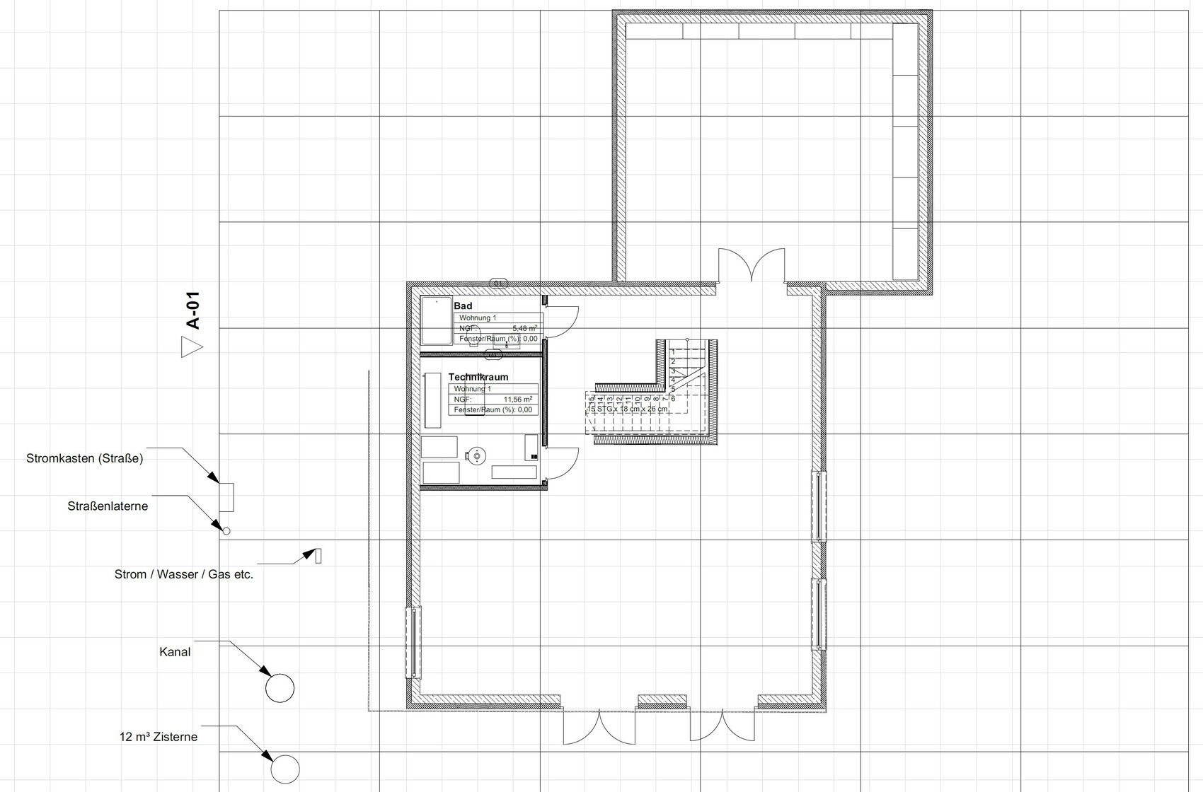

The basement plan is not finalized yet. In addition to utility rooms, storage, possibly a bathroom (for quick cleaning and a potential future granny flat), a space-intensive hobby needs to be accommodated here. We are considering adding a basement under the garage or terrace or both. If you have any preliminary tips or rough cost estimates, please share.

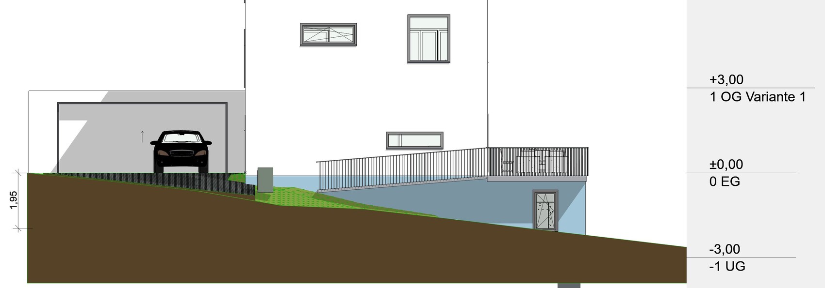

Cross-section of a house on a slope with garage, ramp and terrace.

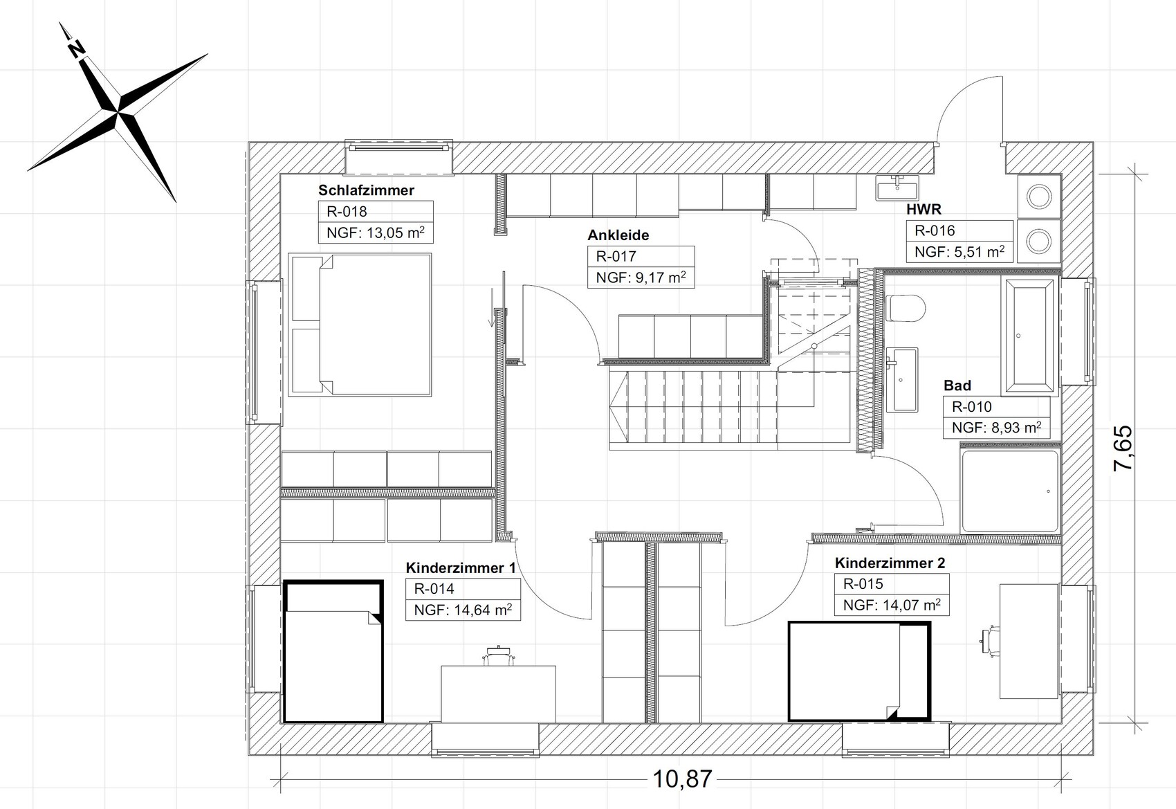

Rough sketch of house floor plan with stairwell, bathroom, and multiple rooms

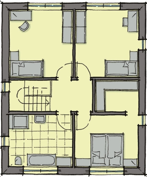

[...]Floor plan could look efficient, here is an example[...]
That actually looks quite good. I would be interested in the ground floor for that. Do you happen to have the ground floor plan of that design? For the upper floor, it would make sense to position the two children’s rooms facing south.

From where would you make the hobby room accessible? The equipment weighs several hundred kilograms (up to about 800 kg) and must be brought in and possibly taken out again.
Does your suggestion include access from the garage into the house?

Where would you provide access to the hobby room? Some of the equipment weighs several hundred kilograms (up to about 800 kg) and needs to be brought in and possibly taken out.
Does your suggestion include an access from the garage into the house?
These are just initial thoughts. For rough layout sketches, you would need the precisely measured plot including all building boundaries, setbacks, or any other zoning plan details. I saw the contour lines somewhere already.
Basically, the basement floor is constructed as a single unit connected to the garage basement, for example, via some kind of airlock or vestibule. This way, you have a connection but at the same time a separation. Of course, this also depends on the available space.
