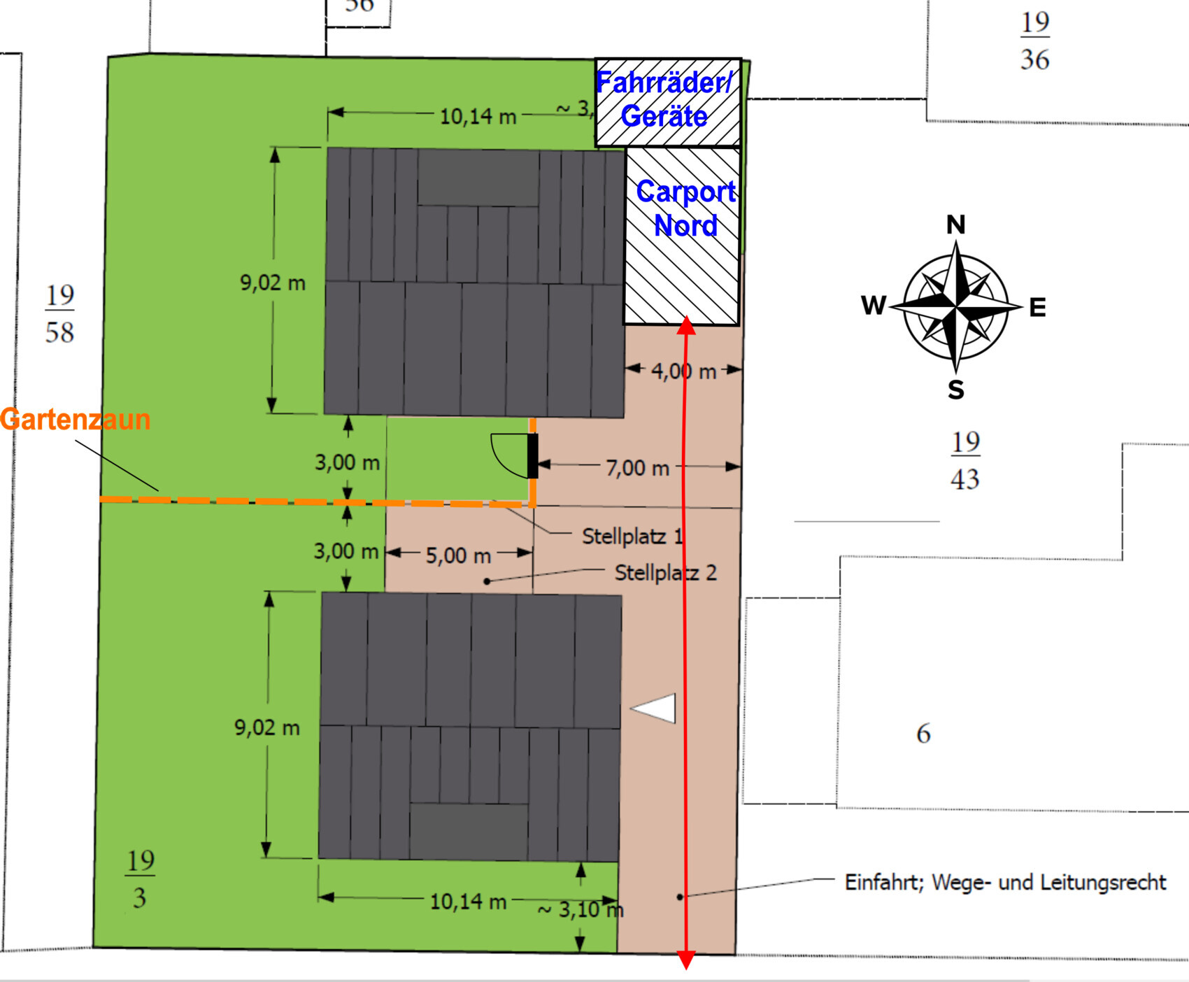

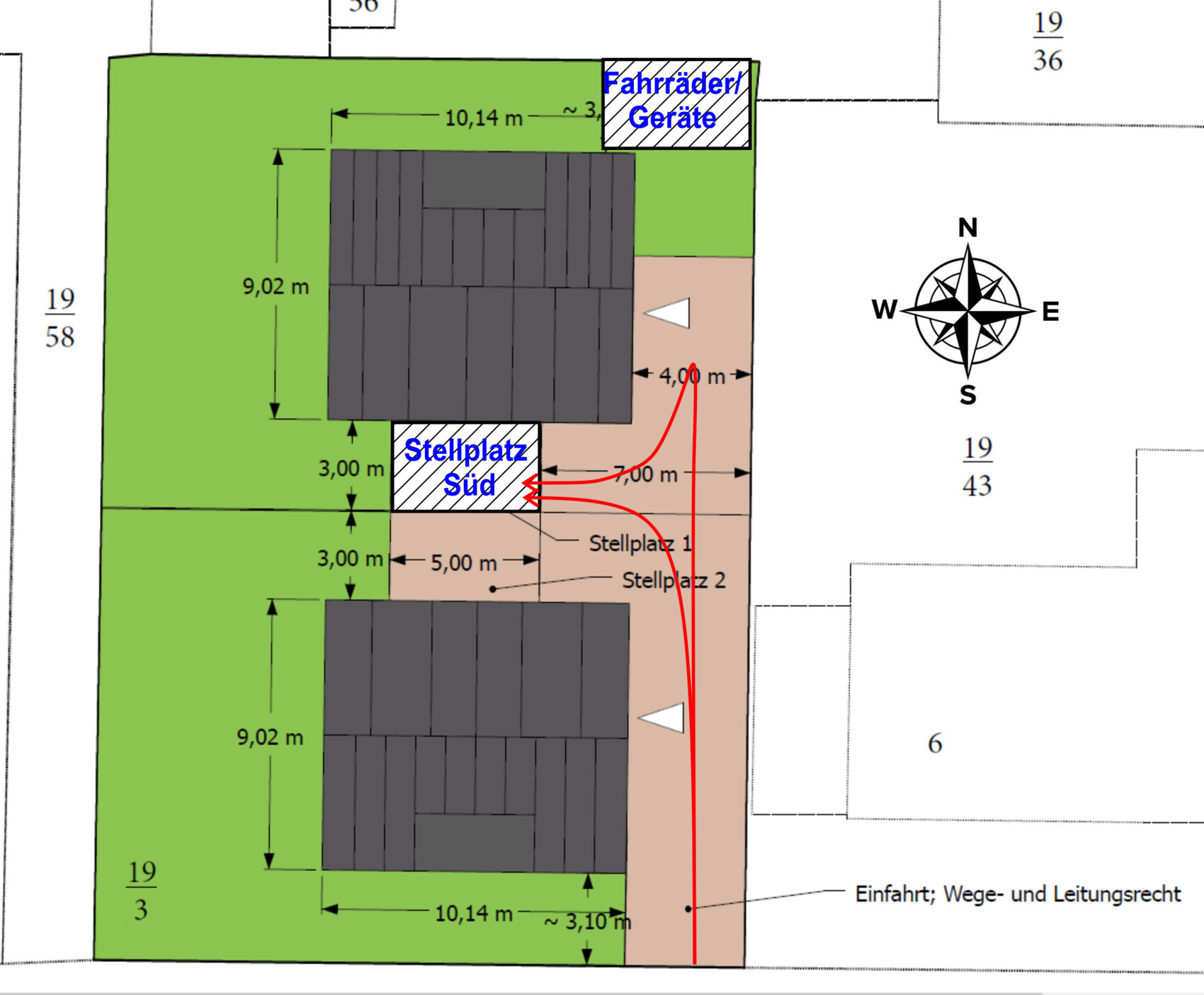

The maneuvering area is, as expected, officially planned as such. Accordingly, the parking space should be placed on the south side. It’s unfortunate because of the sun, but it can’t be changed. The crucial question is whether the parking should be covered. If you want to keep the car dry, you would have to come to an agreement with the neighbor. Everything else, in my opinion, is nonsense. This also affects how much light you can get from the south and ultimately the overall planning. Is the land seller also your builder or general contractor?
I’ve sketched out the two possible options again here. In option A, the carport or parking space is on the south side. What I find particularly disadvantageous is that quite a bit of garden area is lost, and from the living room or kitchen you would be looking directly at a parked car. I’m still undecided whether maneuvering will be easier than in option B (carport/parking space on the north side). I marked possible driving paths in red. Either you have to drive quite far through and then reverse into the parking spot, or somehow park directly forwards.
Floor plan of a plot with buildings, green areas, parking spaces and driveway
Option A
Of course, in option B (carport on the north side), driving in and out is also a bit inconvenient since reversing is necessary, but you retain the garden area on the south side and could even place a garden door there. This way, the designated maneuvering areas are not compromised. Or am I overlooking something important here? We also considered that the car doesn’t necessarily need to be covered. This would allow more light into the house entrance area. The downside, of course, is access to the bike/tool shed when the car is parked. However, with a 4 m (13 feet) wide driveway, there should still be enough space to pass the car on the left. What do you think? By the way, is the bike shed in its current location really sensible? The choice between these two variants is really not easy. We also have to plan somewhere for trash containers, but I’m not sure yet where they can or should be placed… 🤨 Maybe at the lower corner of the house, on the right? So, at the southeast corner.
Plot plan with house, garden, carport and driveway
Option B

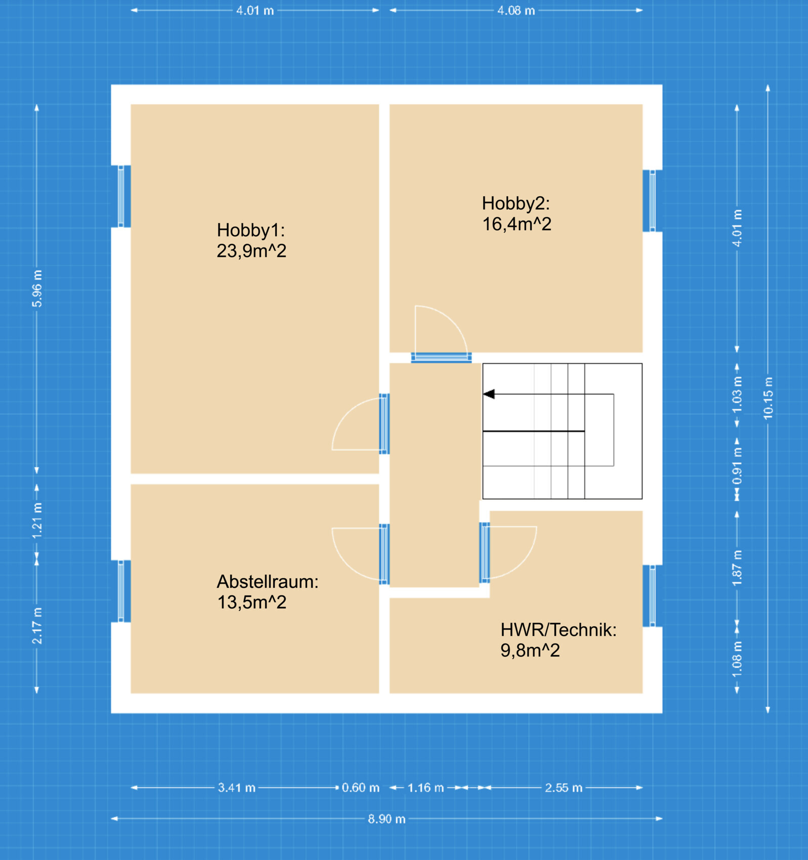

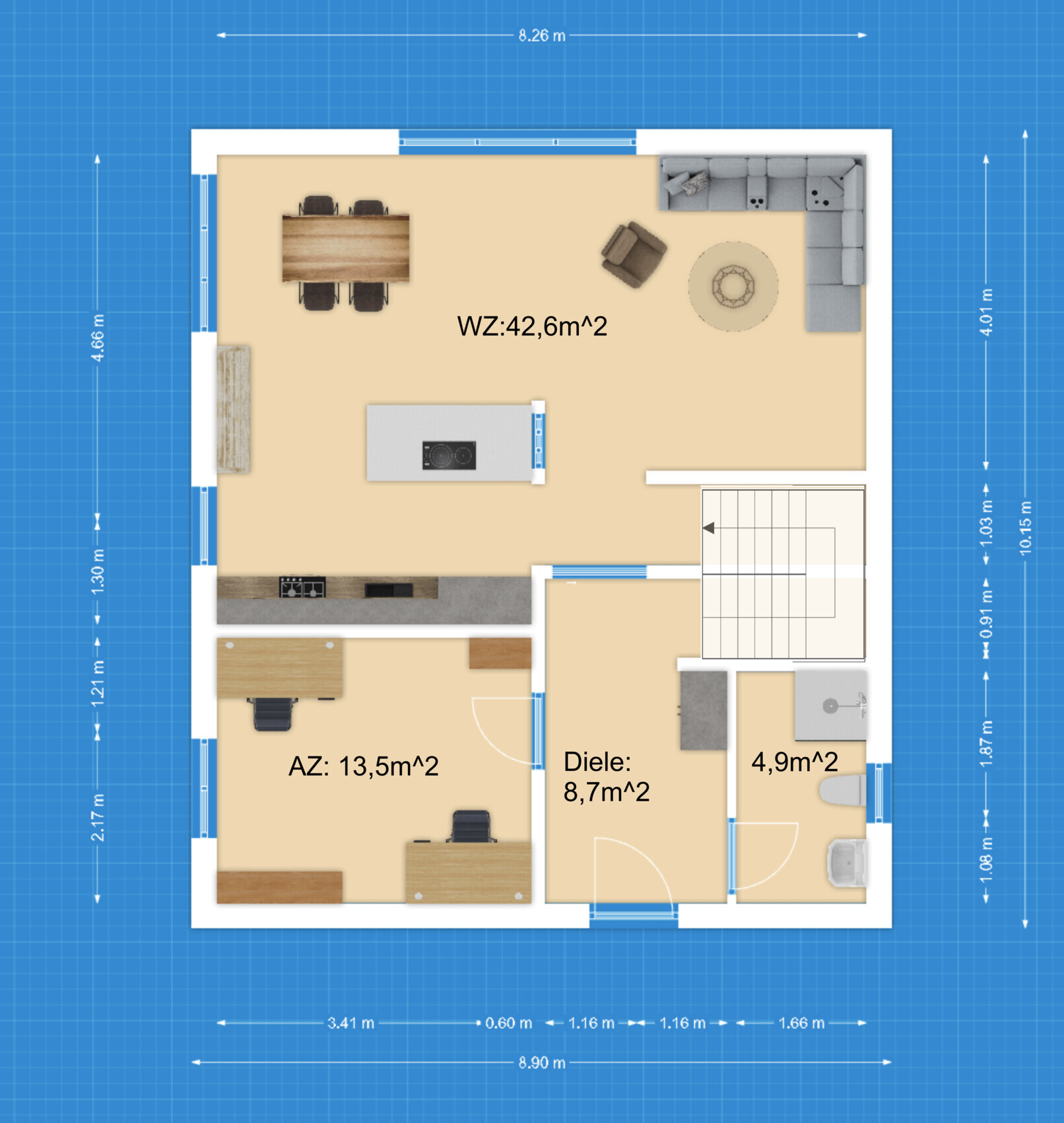

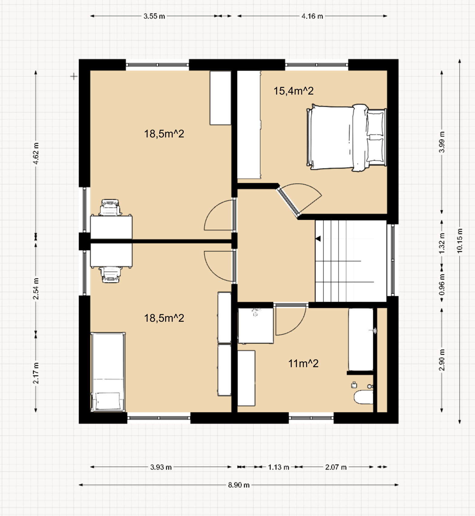

Thanks again for the measurements @K a t j a. I redrew your design based on those and placed some of our furniture.
2D floor plan of an open living and kitchen area with dining table, sofa and bathroom
Floor plan: Hobby room 1 - 23.9 m2 (257 sq ft), Hobby room 2 - 16.4 m2 (176 sq ft), Storage room - 13.5 m2 (145 sq ft), Utility/technical room - 9.8 m2 (105 sq ft)
Floor plan of a house: four rooms, hallway and staircase; furniture like bed and desk visible.
Ground Floor and First Floor
The area for the living/dining/kitchen space has turned out quite generous at 42.6 m² (458 sq ft) 🙂 I actually like the solution with the small partition wall. Depending on the sofa's orientation, you don’t look directly at the kitchen island. After all, things aren’t always tidy and put away 😉 Our highboard fits in quite well too (on the short side of the kitchen island).
The children’s rooms upstairs are also very spacious now, which we really like! The bedroom is definitely large enough for us. We played around a bit with the bedroom door placement to be able to position a large wardrobe on the left wall. The sloping ceiling at the bottom wall gets in the way there. I’m not sure whether this angled wall makes sense or if it’s a short-sighted idea. Regarding the bathroom, we need to think about the layout of the shower and bathtub. Maybe a corner bathtub would have advantages here.
Stairs
I have a few questions about the stairs. You placed the basement stairs on the kitchen side, @K a t j a. Are there specific rules or advantages, or could it be swapped so that you enter the basement from the hallway? Also, I wanted to ask at what height (e.g., relative to the upper floor level) the additional window by the staircase landing will be positioned?
Basement
I think there isn’t much room for flexibility in the basement design since the layout is defined by the walls above. We’re not sure whether the utility/technical room is a bit too small now. We actually want to use it for drying laundry as well. 😉 Also, I’m not fully clear on how the water connections for the kitchen would be routed, since it’s now on the opposite side. 😀

K a t j a10 Jul 2022 17:57
As far as I know, the minimum requirements of the energy-saving regulations are already so high that a 32cm (12.6 inches) wall probably won’t be sufficient. Only your general contractor knows the exact wall structure they will use. Just ask them.
Only you can decide whether to change the staircase direction. Generally, when children are involved, it’s advisable to separate living spaces from bedrooms for more quiet. It’s usually less about the kids making noise and more about the clattering of dishes by the parents when the kids are already in bed. With a knee wall height of 1.50m (4 feet 11 inches), I positioned the window at the stairs almost at floor level—about 20cm (8 inches) high. But these are things you have to decide for yourselves. You should look at and try out window sizes and heights in other houses of similar size. This is also what your architect is there for—to advise you.
I wasn’t too rigid about the bedroom closet. I have a 2m (6 feet 6 inches) wardrobe up to the sloped ceiling. The rest were highboards. Sloped walls are not really my preference and are more of a last resort. People often place a highboard in front of the bed instead of a wardrobe to have a spot for a screen. But of course, that’s your decision.
I would always plan the basement last. It needs to fit in with the rest. We can review that again once you’ve finished planning the other floors. I had planned a laundry chute in the bathroom, which should of course lead all the way down to the laundry room.
10 Jul 2022 22:29
Ilski30 schrieb:
I have marked possible driving routes in red.
Does the right of way apply beyond the 3 meters (10 feet)? If there is a neighbor’s fence there, a smooth curve is not possible.

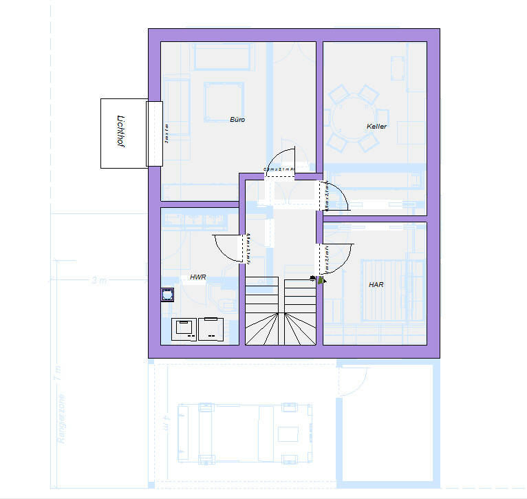

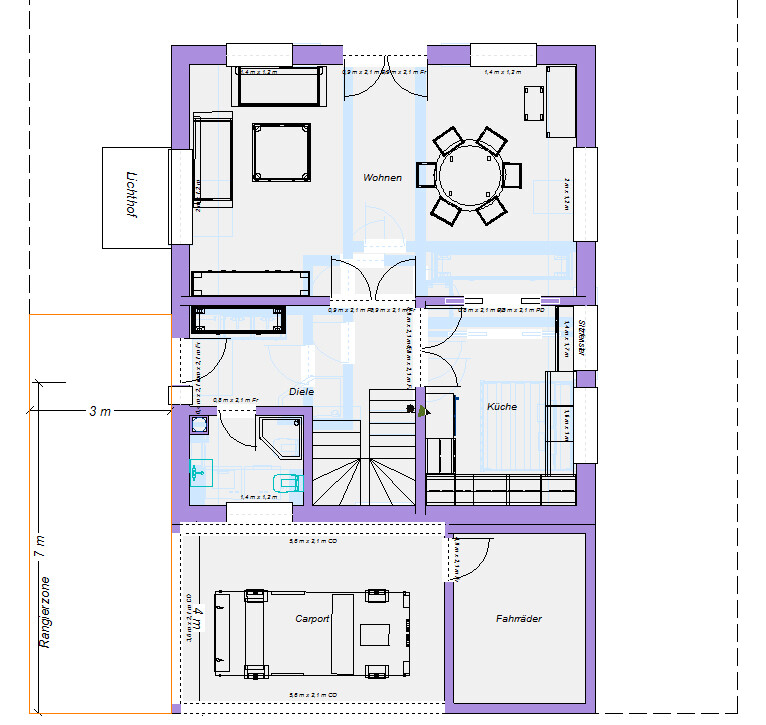

K a t j a12 Jul 2022 22:51
Here is a proposal with an office in the basement and a light well facing south (north is to the right on the plan):
Floor plan of a house from above: living room, kitchen, hallway, carport, bicycles, staircase.
Floor plan of a house: central staircase, corridor, several rooms, kitchen and dining area.
Floor plan of an upper floor with office, basement and utility room as well as staircase
If you are already digging the basement, creating a light well is quite easy. Since the rooms in the basement have a ceiling height of 2.44 m (8 feet), and you are not entirely sure what all will go down there, I would try to place the office downstairs. Of course, the office would need underfloor heating, and you should also find out how the office insulation can be implemented. In return, you gain a nice area for living space and kitchen on the ground floor.
The plot is small and requires some compromises. In the example, I positioned the bike shed directly next to the carport, creating a 9 x 4 m (30 x 13 feet) space for the car and bicycles. As a result, the kitchen only has windows facing north. That’s a bit unfortunate, but to make up for it, I added a window seat.
Also, I would use the otherwise unusable turning area to locate the main entrance here, keeping pathways short.
At first, I had the kitchen facing south and the entrance on the north side, but that layout is simply too wasteful and impractical here. Possibly, you might also need to swap the heating system room (HAR) and the utility room in the basement. However, the laundry chute must remain where it is.
One remaining question is the structural stability. The walls are quite irregularly distributed. It might be necessary to use at least some light partition walls (drywall) in the upper floor.

Many thanks @K a t j a for your ideas, drafts, and especially your time. Sorry for the late reply.
This is definitely a very interesting suggestion from you. If I understand correctly, we would have to do without the dormer with this solution, right? How does it work with the light well? Does the 3m (10 feet) distance rule to the neighbor also apply there, or is it exempt? A separate kitchen also has its advantages. Now we have the difficult choice 😉
Last Monday, we had your first draft worked out by our builder. I think it has improved enormously compared to what we had before. We now have a practical hallway, the kitchen is nicely spacious, and the children’s rooms upstairs are also quite generous. I have attached the new drawings. The carport is still shown in the elevations, but we are considering leaving it out and keeping only the bicycle/tool shed on the north side. The car doesn’t necessarily need to be covered, and there is usually a spot free on the street anyway. And if no space is available or if we need to load the car, we could still park it in front of the entrance. The green strip on the south side could then be used entirely as a garden from the end of the turning area.
A few open questions remain about the attached floor plan. For example, in the living room, the small wall to the right of the kitchen island creates a rather narrow passage between the stairs and the island. It may also be possible to build without this small supporting wall. This would require the living room ceiling to be slightly more solid. We are still waiting for our builder’s response about any additional costs this would involve. It would, of course, make the living room much more open and spacious.
We also need to consider whether the laundry shaft could be moved slightly toward the bathtub. From my point of view, it’s not ideal so close to the toilet. But maybe that impression is deceptive. Furthermore, we still need to decide whether the door of the north-facing children’s room should be moved slightly downwards. This would create a somewhat more symmetrical look in the hallway, although the current solution is probably better for the room itself.
It might also be possible to combine this floor plan with the light well proposed by @K a t j a.
Well, please have a look. Maybe you’ll spot something else. We appreciate any advice that brings us closer to our final floor plan 🙂
