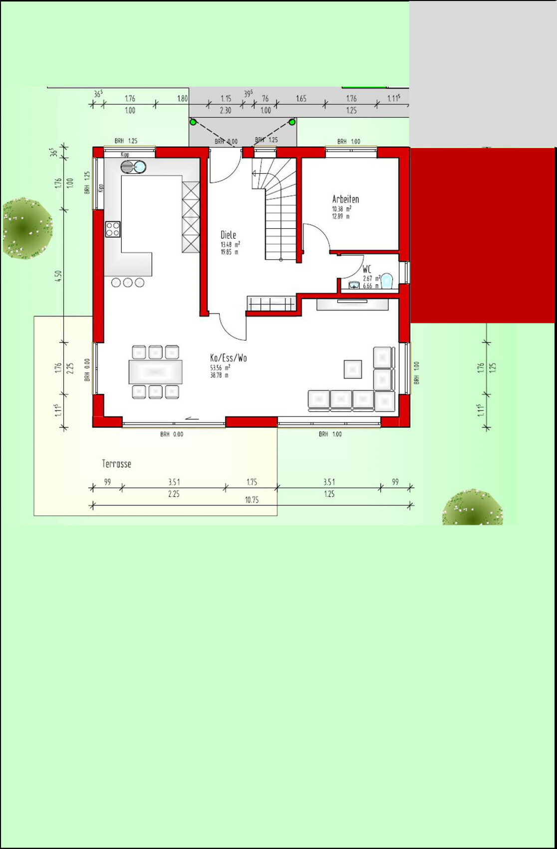

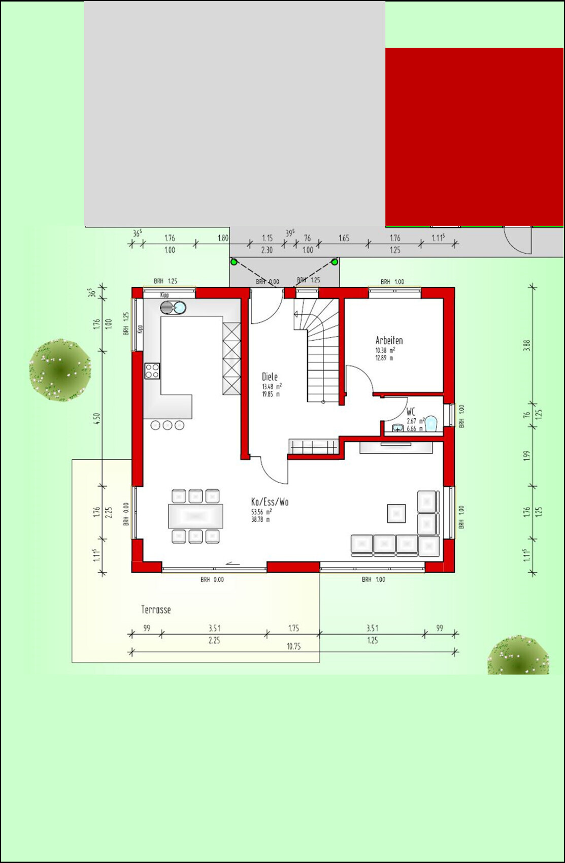

Are your cars or the double garage really that important to you? I made a comparison with a wider single garage, which would give you significantly more space in your south-facing garden. Car 2 would then have to be parked in the front yard on a separate parking space or in front of the garage. It’s crazy how much area you’re paving just to make that 90-degree turn... We also have a 550 sqm (5920 sq ft) plot, and there isn’t much left if you take away so much space at the front like that.

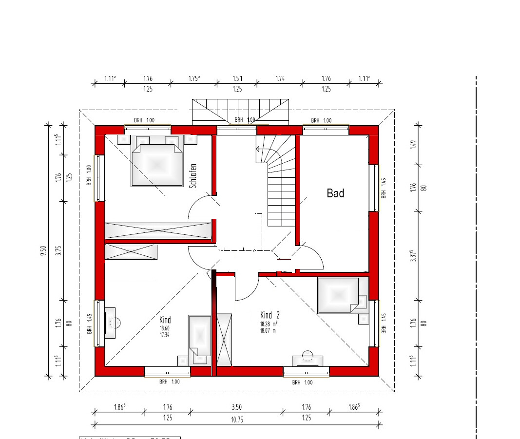

I like the upper floor, even though a bathroom over 20 sqm (215 sq ft) isn’t really necessary. On the ground floor, I have the same criticisms as others. It’s the typical L shape, but drawn with a very fine pen, meaning the legs are very narrow and long. I would try to shift the staircase a bit to the right to distribute the space better. In my attached idea, I referred to my own floor plan. We also have an L-shaped open space with the kitchen, WC, and cloakroom arranged as shown here. The entrance area would look nicer and more symmetrical with your layout this way. The window at the upper floor gallery could be placed directly above the front door.
I would move the terrace in front of the living room window, which is not floor-to-ceiling. Otherwise, from the dining table, you’ll just see the legs of your garden furniture instead of the garden. The exit with a small path to the terrace can still be through the dining room.

I like the upper floor, although having over 20 sqm (215 sq ft) for the bathroom isn’t necessarily required. For the ground floor, I share the same criticisms as others. It’s the typical L-shape, but it’s drawn with a very thin line—meaning the legs of the L are very narrow and long. I’d try moving the staircase a bit to the right to improve the layout. In my attached idea, I used my own floor plan as a reference. We also have an L-shaped open plan living and kitchen area, with the WC and cloakroom arranged as shown here. Your entrance area would look nicer and more symmetrical this way. The gallery window on the upper floor could be positioned right above the front door.
I’d relocate the terrace in front of the living room window, which is not floor-to-ceiling. Otherwise, you’d only see the legs of your garden furniture from the dining table instead of the garden itself. You could still have access with a small path to the terrace from the dining room.

Really great solution, especially regarding the kitchen and hallway cupboards. The kitchen in particular. That would be MY floor plan!

A double garage is definitely a must-have for us. Otherwise, we would also have considered attaching the garage to the house, but in terms of size this is only possible with a single garage. I find our yard pretty impressively large (honestly, I’m a fan of big yards) – plus later the kids will also have a parking space, and so will visitors (parking situation in the new development area isn’t great...). In my opinion, we also have a garden that is more than large enough for our needs. The more garden you have, the more work it is, but I think the ratio here is quite balanced.
The bathroom is not 20 sqm (215 sqft), but 15 sqm (160 sqft).
The idea with the floor plan is really good – but we don’t want the typical kitchen island. The stove will be placed against the wall, so a true island setup is out of the question. We’re also going to add a door to the kitchen, which would be very difficult with this layout. The door will really open up our floor plan. The kitchen will then be exactly how we imagine it – with a very long, large countertop on the west side. We already have pretty clear ideas that we’ll go through with our kitchen planner. 🙂

- Even if you have indicated “-” for overnight guests, this will likely change once children come into the picture. As long as the children are small, a babysitter might occasionally stay overnight, and later friends might do so. Therefore, it might be advantageous to plan the guest toilet with a shower. Also, having only one bathroom for a four-person household seems outdated, as we learned from selling our house this year.
