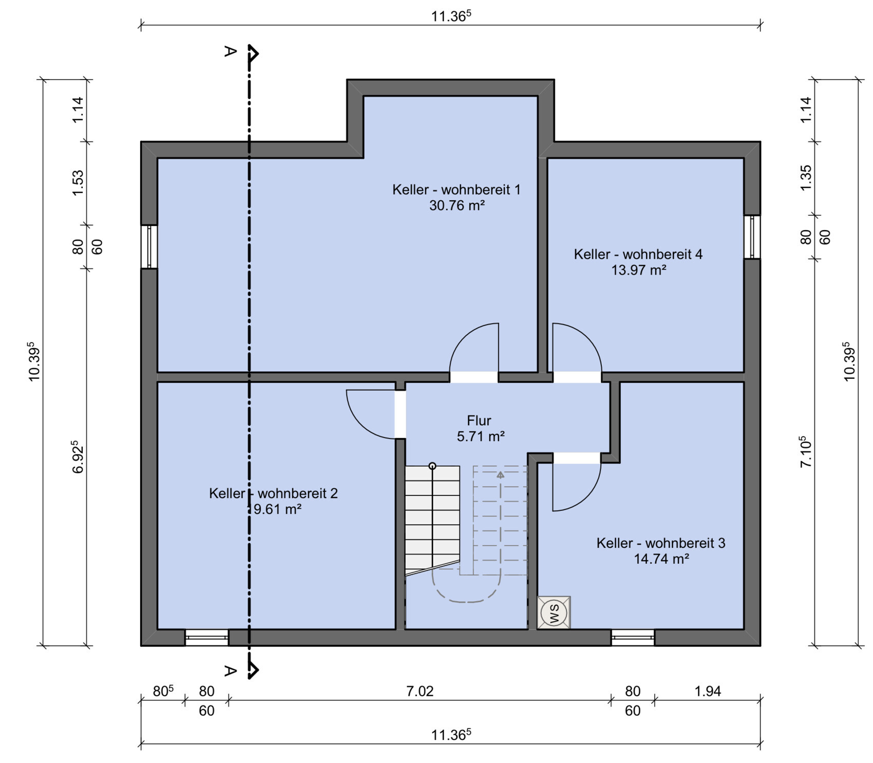

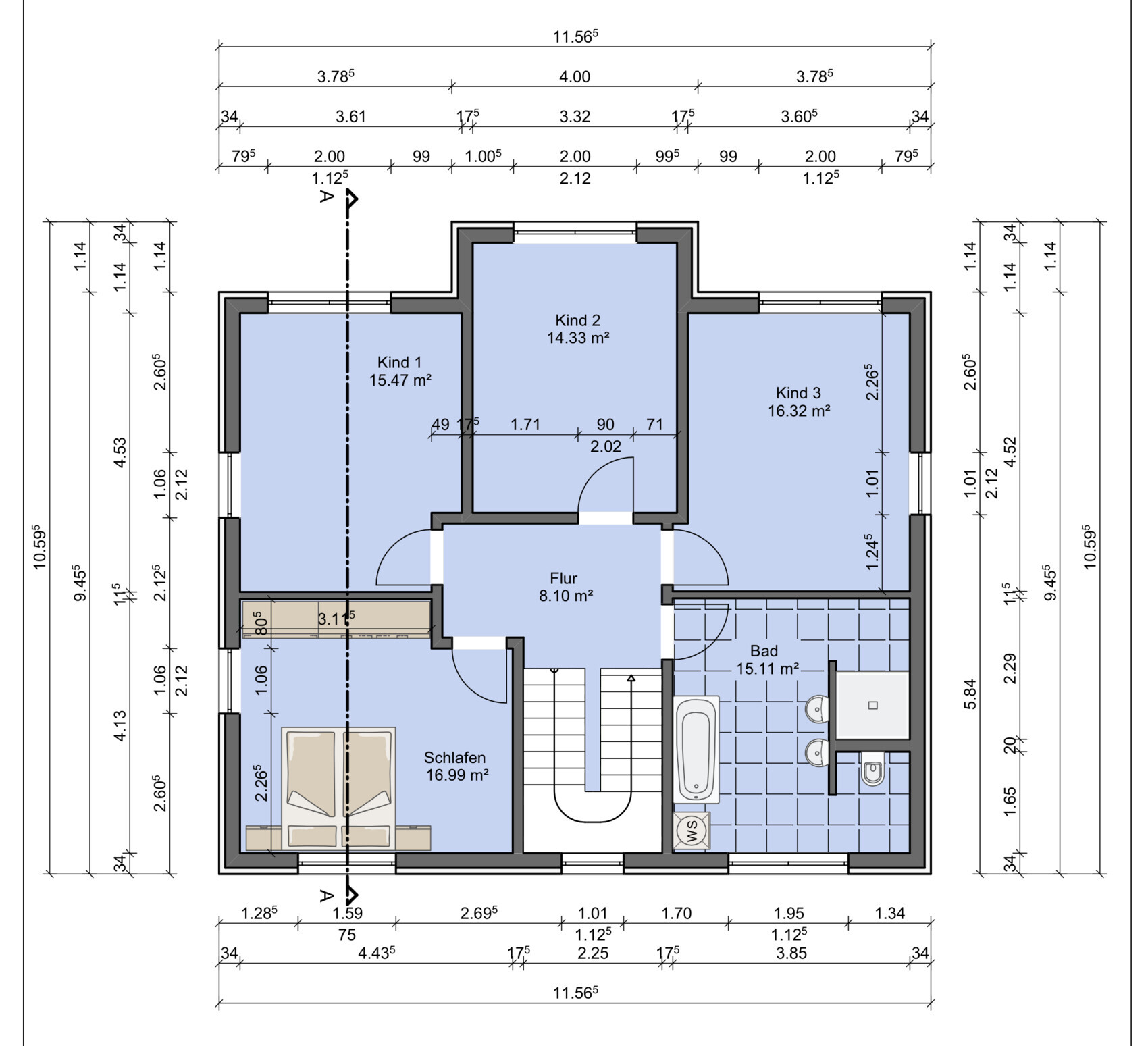

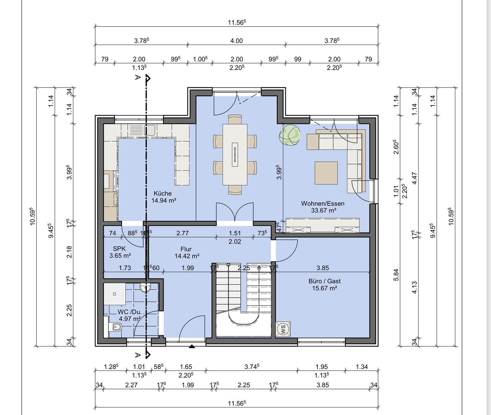

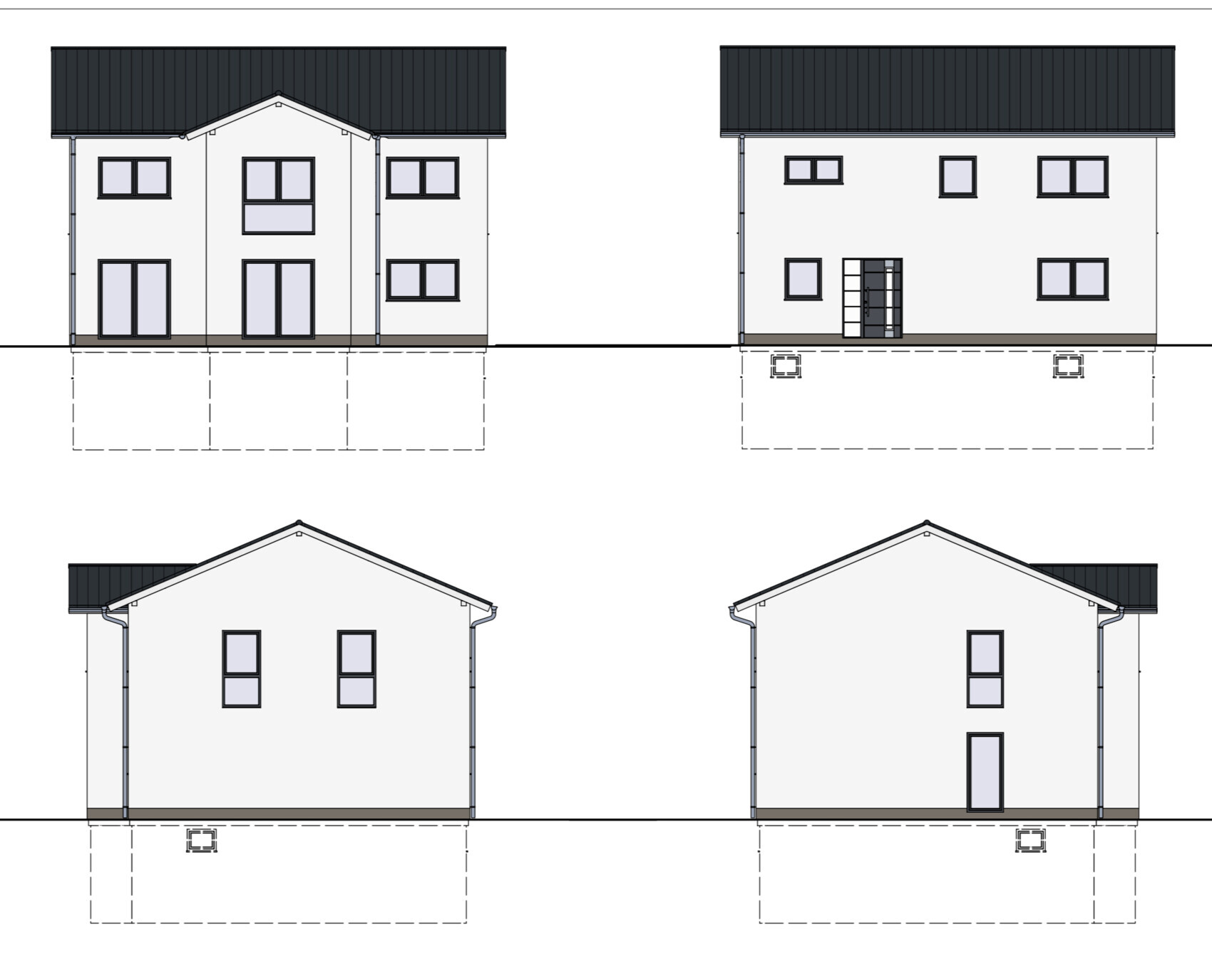

Can the staircase be placed further away from the entrance? What do you think about making windows in the bathroom, master bedroom, and office narrower (window sill height)? Are the basement windows well positioned, especially those near the terrace?

Kellergeschoss Grundriss mit Hobbyraum, Abstellraum, Vorplatz und Installation
Grundrissplan des Erdgeschosses mit Kueche, Essbereich, Wohnzimmer, Buero/Gaeste, Duschbad
Grundriss Obergeschoss eines Hauses mit drei Zimmern, Bad und Treppenzugang

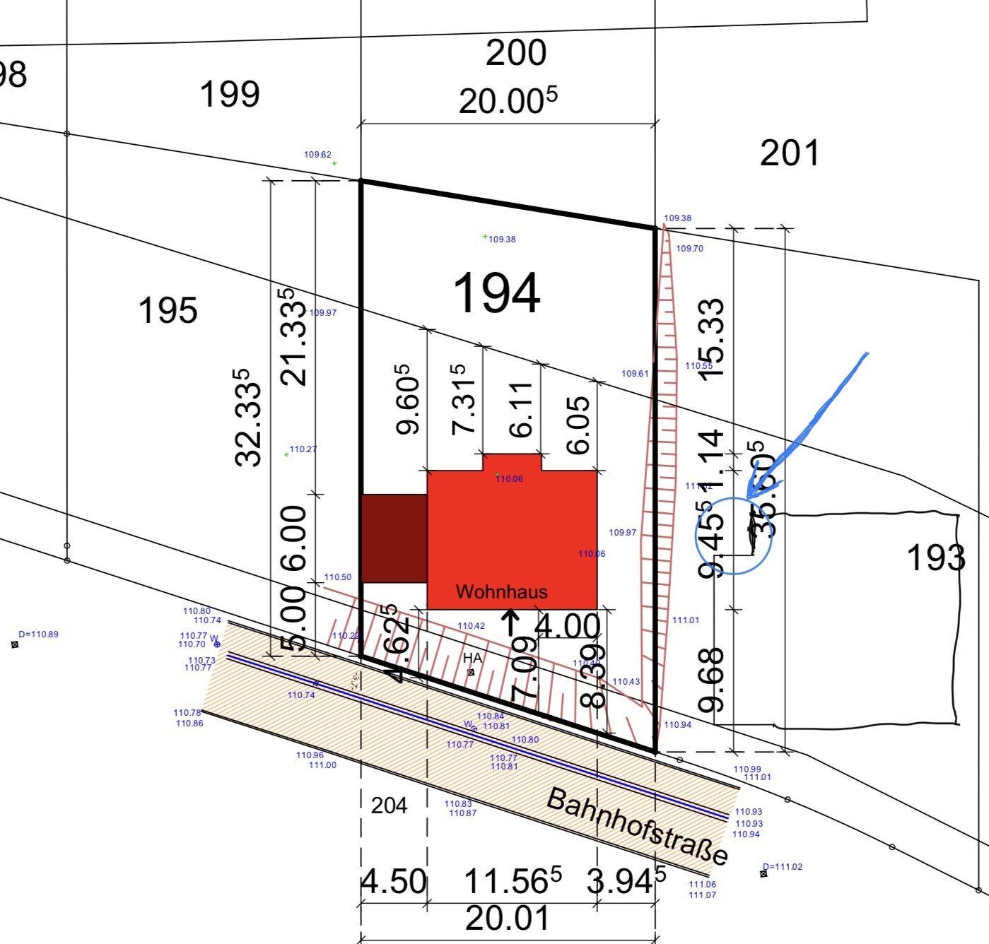

The plot is 680m² (7,300 ft²) in size
I was actually referring to the lengths of the property boundaries, especially the width along the street.
Gregor_K schrieb:
He didn’t yet know if the neighbor on the left would fill in the remaining land.
What is he like? Is he approachable? If so, I would invite him for a beer and coordinate the plans to avoid any issues with L-shaped retaining blocks, rainwater running onto the neighbor’s property, fences collapsing, or similar problems. Of course, such agreements may ultimately be worthless if push comes to shove. But it’s worth trying.
1 Sep 2022 11:49
Gregor_K schrieb:
The plot is 680m2 (7313 square feet) in size, and garages/carports are allowed to be built up to the property boundary.

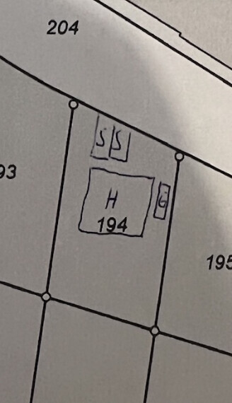

But that refers to the side boundaries of the property, not the front boundary at the street, right?!
Gregor_K
1 Sep 2022 12:13
But this refers to the side property boundaries, not the front one on the street, right?!
I want to place some grass pavers / paving stones where it says S S (parking space) and not designate it as a garage / carport / parking space. I would still park my cars and my children’s cars there (once they turn 18). The building permit specifies a garage with a 5m (16 ft) setback from the street. Since the curb is not very high, it’s easy to drive from the street onto the property. I once read somewhere that only one driveway is allowed per property.
What’s he like? Can you talk to him? If yes, I’d invite him for a beer and coordinate the plans so that none of you have to install any L-shaped retaining blocks, or have rainwater running onto the neighbor’s property, or the fence falling over, or similar problems. Of course, such agreements can become meaningless when it really matters. But it’s worth a try.
My neighbor is approachable. I’ve already had a beer with him. 😀 That was right after buying the plot, though, and I hadn’t thought things through properly yet.
The dimensions of the property are as follows: the side along the access road is about 21.03m (69 ft) (north), the sides approximately 35.5m (116 ft) (west) and 32.34m (106 ft) (east). At the very back, on the south side, it’s about 20.26m (66 ft). I took these figures from the geoportal.

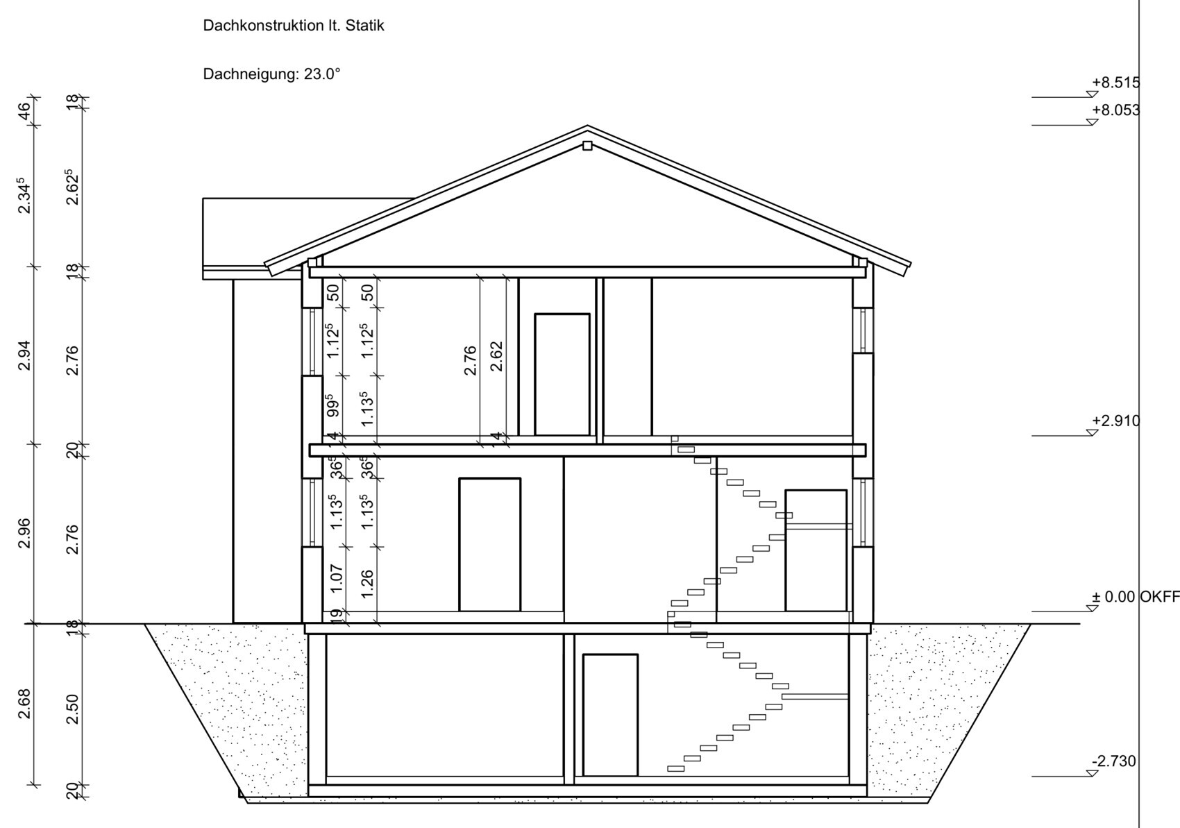

Attached is the section drawing of the house.
I really don’t like the cantilever of the bay window: if executed as roughly as shown in the plan, you won’t be happy with it, and even if done properly, you will save at most a few hundred dollars compared to building the bay window starting from the basement. In this specific case, the seemingly cheaper option is actually more complex.

Christian 65
12 Oct 2022 15:22
Well, I’m not sure if the stairwell window really makes sense there. You stand on the landing at about 1.65m (5 ft 5 in).
That leaves almost no height above you. Or is the elevation just drawn incorrectly?
And in the bedroom, try placing your bed first and then a wardrobe.
Maybe the gable window in that room will have to be removed.
