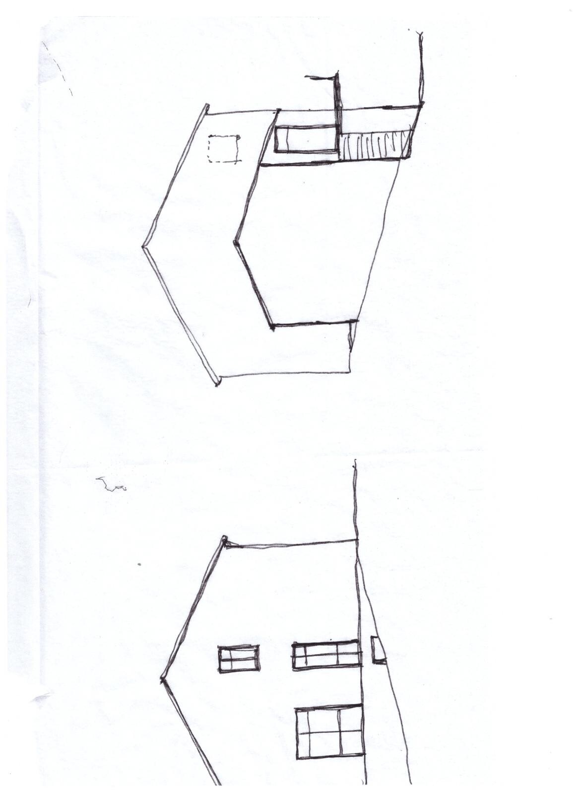

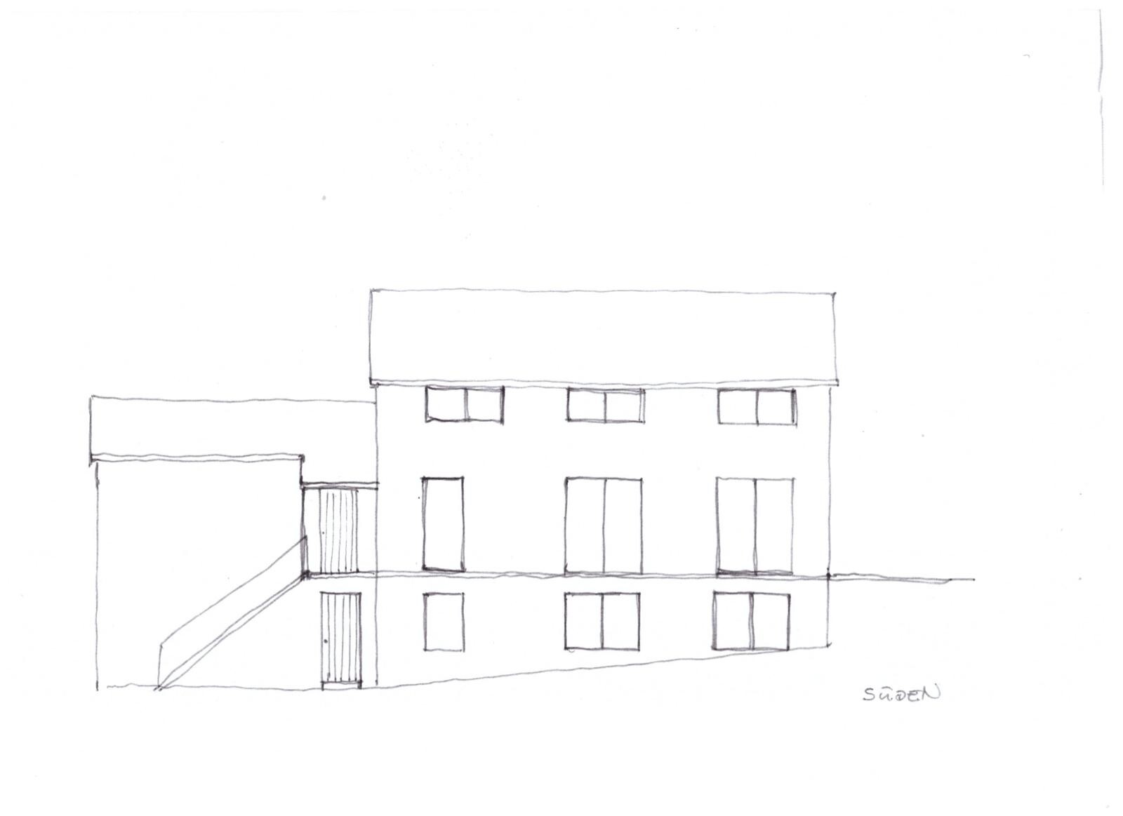

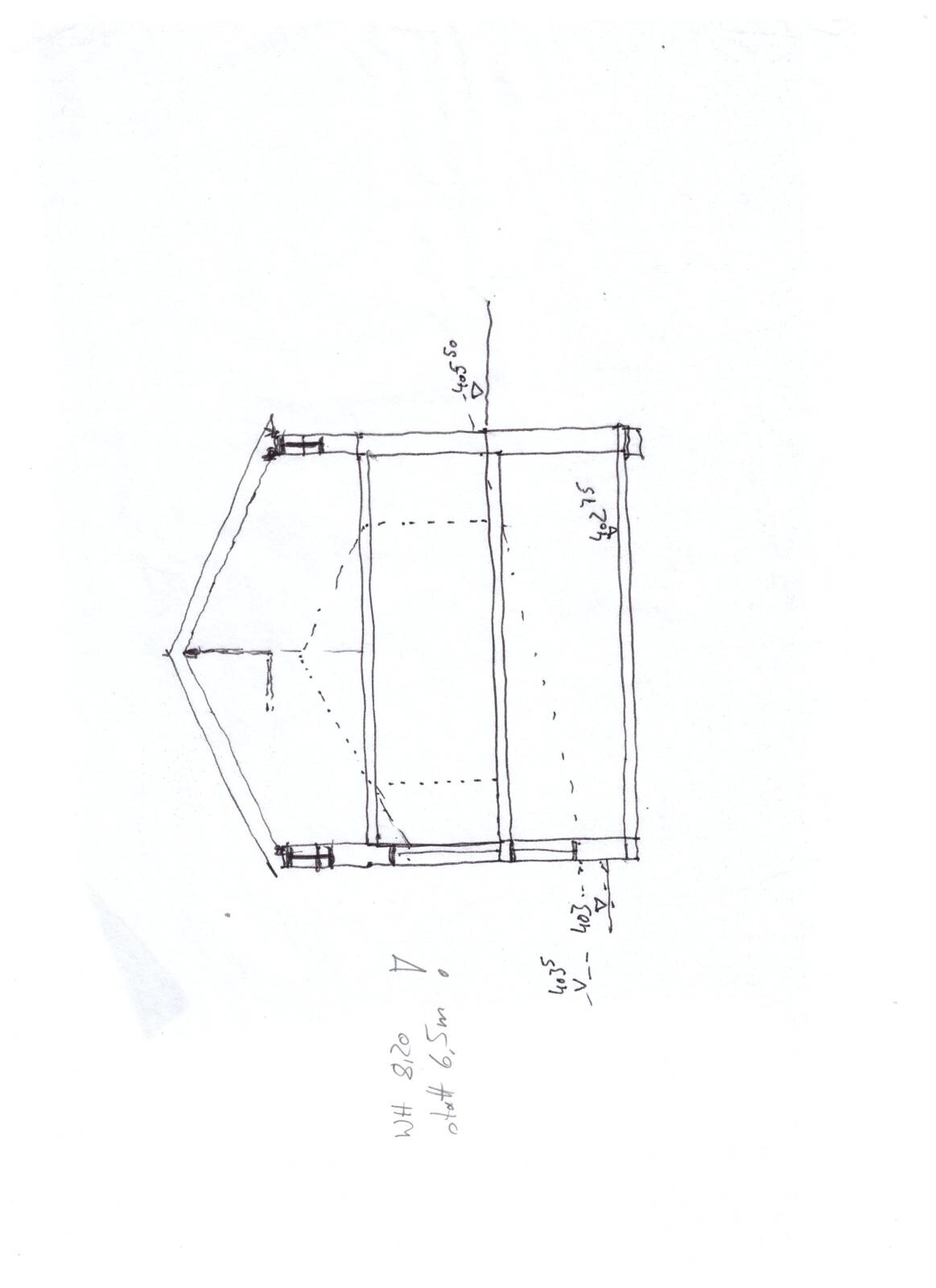

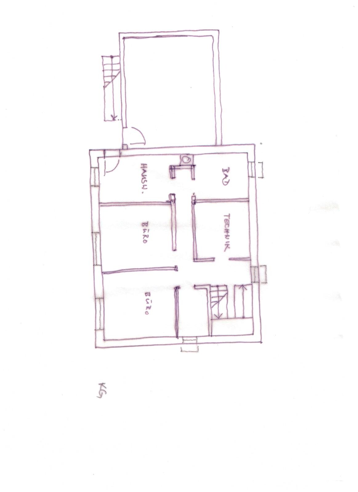

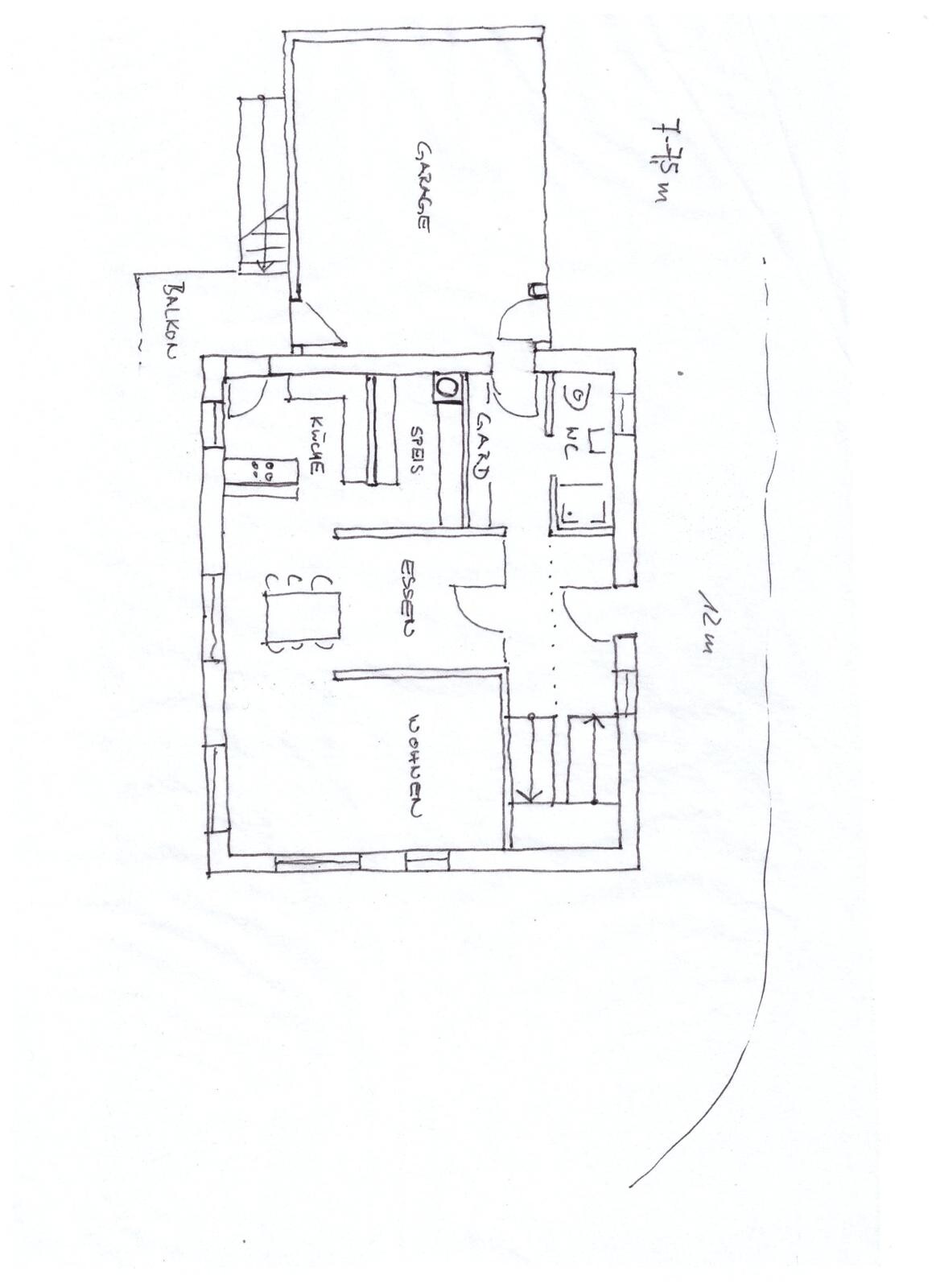

familie_s26 Feb 2024 09:37
Good morning,
we now have the first rough drafts from the architect. We did not show her our initial floor plan; we only shared our room program and ideas. The only thing we forgot to mention is that we did not want the children’s rooms and the bedroom next to each other, and the bathroom should not be adjacent to a bedroom either.
Interestingly, the floor plan turned out similar. Especially the terrace. The concept of a terrace with garden access is clearer here.
What we like:
- Direct access from the garage into the house. The platform staircase on the north side.
- All bathrooms stacked vertically
- Access from the utility room to the garden
- Exterior view: The south façade looks more balanced, and we also like the roof pitch better.
What we don’t like:
- Children’s room in the middle with only one window, difficult to furnish and next to the bedroom
- Children’s room next to the bathroom
- Bedroom too large compared to the children’s rooms
- Dining room as a walkthrough space
- Long distance to the pantry
- Living room difficult to furnish well
- Kitchen located on the west side
Sketchy floor plan of a house: kitchen, dining, living room, bathroom, WC, hallway, garage, garden
Sketchy multi-story building with several windows, a large door, and side extension.
Sketch of a house floor plan with bedroom, children’s room, bathroom, staircase and terrace.
Sketch of a building: plan and front view with windows
Sketch of a geometric building plan: left hexagon, right rectangle, interior lines showing edges.
Sketch of a two-story house with side extension, external staircase and windows.
Hand-drawn house floor plan sketch with rooms, bathroom, technical room and staircase.
K a t j a26 Feb 2024 12:35
Hmm, besides the flaws you mentioned, the kitchen would probably feel too small for me as well. Setting aside the details, the design somehow feels kind of “meh.” There’s zero wow factor or that “I want to live here” appeal. It’s not a solution that’s economical, efficient, or particularly elegant either. It’s not bad, but it’s not great either. Just “meh.”
In general, I’m always in favor of direct garden access from the main living areas. To quote Müntefering: “Stairs are a nuisance.” I can see this in my father’s neighbors’ houses and his own home. In summer, everyone spends time on the lawn, and any obstacle getting there just gets annoying. Eventually, the rooms downstairs almost always get repurposed, gradually turning into substitute kitchen space, substitute dining areas, and recently even a bathroom. What’s funny is that the neighbors in the new build next door started with the same design mistake and are now going through the exact same process.
11ant26 Feb 2024 14:08
familie_s schrieb:
We now have the first rough drafts from the architect. We did not show her our initial floor plan and only communicated our room requirements and ideas. The only thing we forgot was to mention that we didn’t want the children’s rooms and the master bedroom to be next to each other, and that the bathroom should not be adjacent to a bedroom.
I like the sketch-like quality of the preliminary design; often at this stage, things are rushed and measured in (often flawed) detail. Unfortunately, the dining table is already obstructing the plan in the drawing. The garage does not suit the house, and the rear view doesn’t match the front: the front has a regional style (but with a wide double garage door), while the back has a typical federal style—this reminds me a bit of a mullet haircut [hheh].
