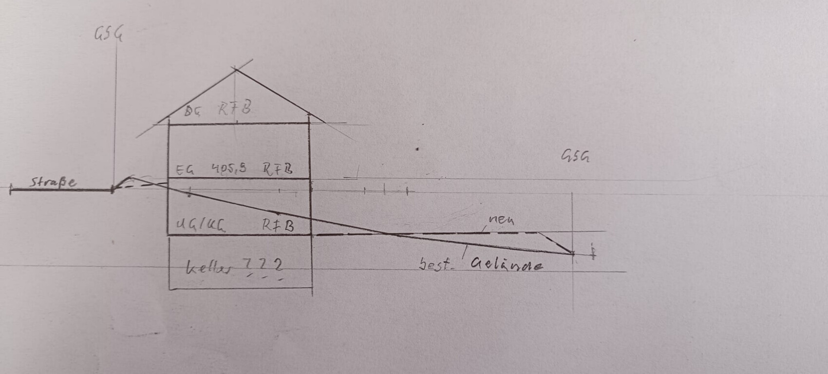

hanghaus202319 Feb 2024 15:43A fairly new development plan, and you’re allowed to build a tower like that? The 6.5 m (21 feet) height limit will never be complied with. Apart from that, where do you want to place the terrace?
For this plot, a ground floor and basement level make sense. But without a cellar, if you definitely want to convert the attic.
Here is a sketch.
This respects the 6.5 m (21 feet) limit. You could set the finished floor level 50 cm (20 inches) lower to gain a bit more knee wall height in the roof.
Here is a sketch.

A relatively new development plan and you are allowed to build such a tower? The 6.5 m (21 ft 4 in) height limit will never be met. Aside from that, where exactly do you want to place the terrace?
For this plot, a ground floor plus basement is appropriate. But without a cellar, if you definitely want to convert the attic.
That way the 6.5 m (21 ft 4 in) limit is respected. You could set the ridge beam 50 cm (20 inches) lower, then you get a bit more knee wall height in the roof. Thanks, it won’t be a tower. Once I receive the elevations in the next few days, I will upload them here. The 6.5 m (21 ft 4 in) measurement starts from the ground floor level, as this is closer to the natural terrain on average.

We would like to have direct access from the kitchen to the terrace and from there at ground level into the garden. To the south, the terrace would be elevated and offer a great view facing south. According to your floor plan and the slope information, the access from the kitchen/dining area would not be at ground level.
Therefore, the elevations and cross-sections would be helpful.
If you define a separate apartment (even without subsidies), parking spaces will be required, so it is better not to define one.
