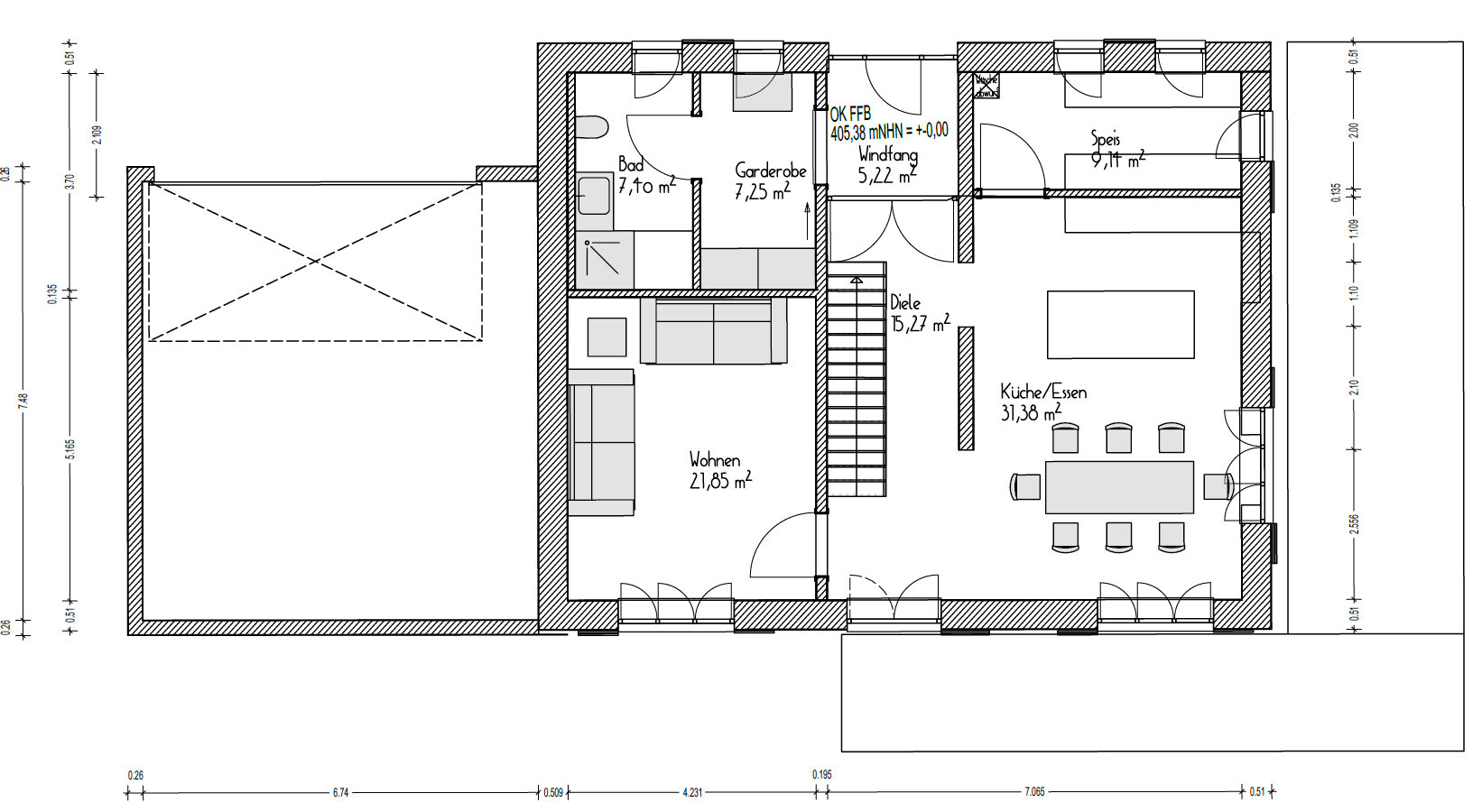

Floor plan of a house: garage on the left, living, hallway, kitchen/dining, pantry, bathroom, cloakroom, entrance vestibule.

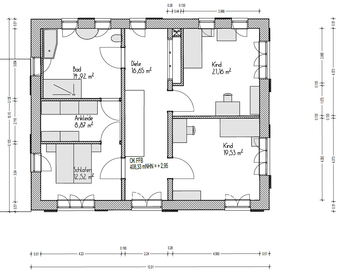

Floor plan of a residential house: hallway, bathroom, dressing room, bedroom and two children’s rooms.

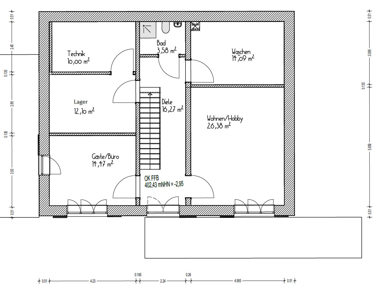

Floor plan of a house with staircase and technical room, storage, guest/office, hallway, bathroom, laundry, living/hobby room.

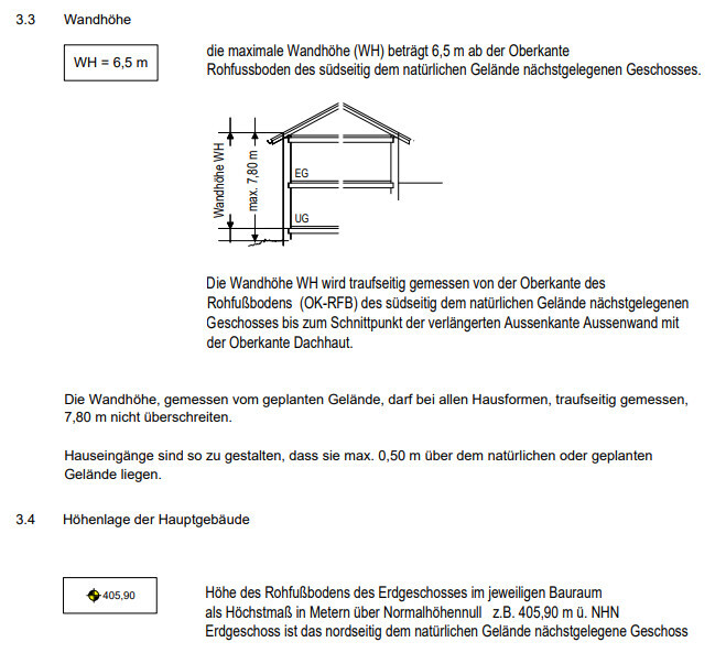

Throw the plan and the planner away immediately. He hasn’t even read the development plan.
Technical drawing showing wall height and floor details ground floor/basement in house construction.
For a hillside location, you need an architect who has experience with this kind of project. The sketch in the development plan clearly shows what the planner envisions.
In my opinion, model homes are not suitable for steep slopes.

We are not violating the zoning plan. The basement will only extend to the south. However, this is not clear from our floor plans, you are right. Among other things, the mistakenly drawn western window contradicts that. We have already confirmed that we are allowed to build to this height.
