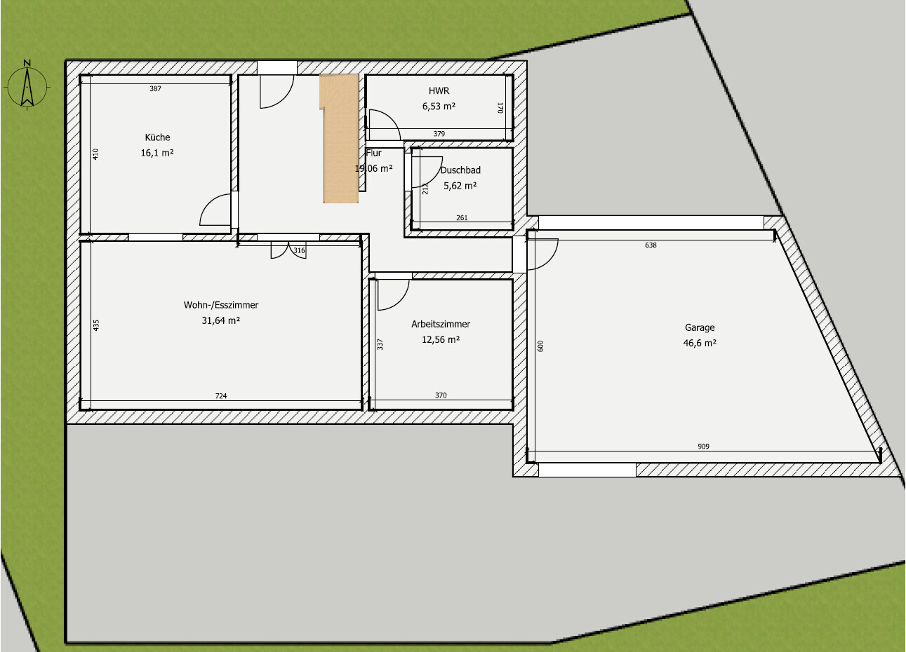

á Initial floor plan draft of the ground floor including a double garage
Created on: 19 Nov 2018 19:15
g00dyHello everyone,

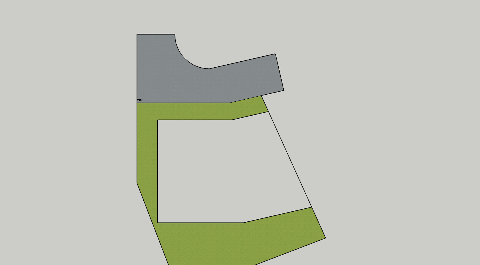

we have just purchased a plot of land (see image) on which we want to build a single-family house. After looking at quite a few houses and floor plans, we have arrived at the attached first self-designed draft. I would appreciate it if you could share your opinions on it â especially regarding where you would place windows. At the moment, we have mainly planned the ground floor, as the upper floor will be large enough to accommodate all the required rooms anyway.
Best regards and many thanks for your time
g00dy

Plot size: 544sqm (5855 sq ft)
Slope: no
Site coverage ratio: -
Floor area ratio: 0.3
Building window, building line, and boundary: see image (gray area = building window, green area = plot, dark gray area = street); a small stream runs 15m (49 feet) away along the southern boundary of the plot (-> nice view, no construction allowed), no trees
Adjacent development: only possible on the east side
Number of storeys: none specified
Roof type: none (flat roofs must be greened if less than 7°)
Architectural style: none specified
Orientation: none specified
Maximum height/limits: 9.0m (30 feet)
Other requirements: max. wall height 6.5m (21 feet)

For heavenâs sake! Thatâs a fail for sure 😀
The hallway is a disasterâfar too narrow and awkwardly shaped. There is no cloakroom at all. Kitchen faces south. Study faces north.
Where is the basement staircase?
The living room with dining area is too small.
In short: nothing fits at all.
O
Obstlerbaum19 Nov 2018 19:52How about having the entrance from the garage side, with the shower bathroom facing north? This way, you can eliminate the unnecessary second entrance from the garage...
I would relocate the entrance.
Put the utility room in the basement.
Take the room layout to the architect.
For every design, whether created yourself or by the architect, accurately draw in the desired furniture to scale.
There is no wardrobe; the narrow hallway is terrible and a waste of space.
Uh⌠floor area ratio 0.3 (excluding ancillary buildings)
Do you know what that means? You might want to calculate where you end up with the desired knee wall height and roof pitch.
The ground floor is already over 100sqm (1,076 sq ft).
What will happen in the basement? What kind of rooms are planned there?
The spiral staircase isnât very appealing⌠and considering the size of the house, everything feels a bit âunattractive.â
Unfortunately, none of the Balance 300 remains either 🙁
