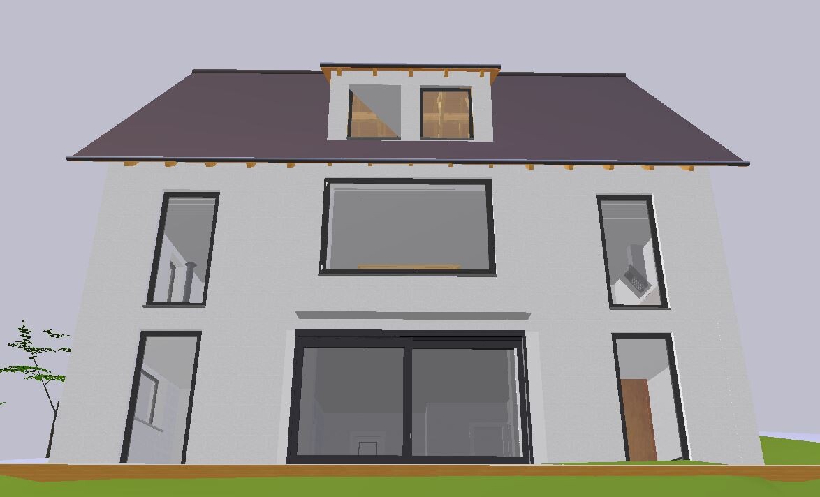

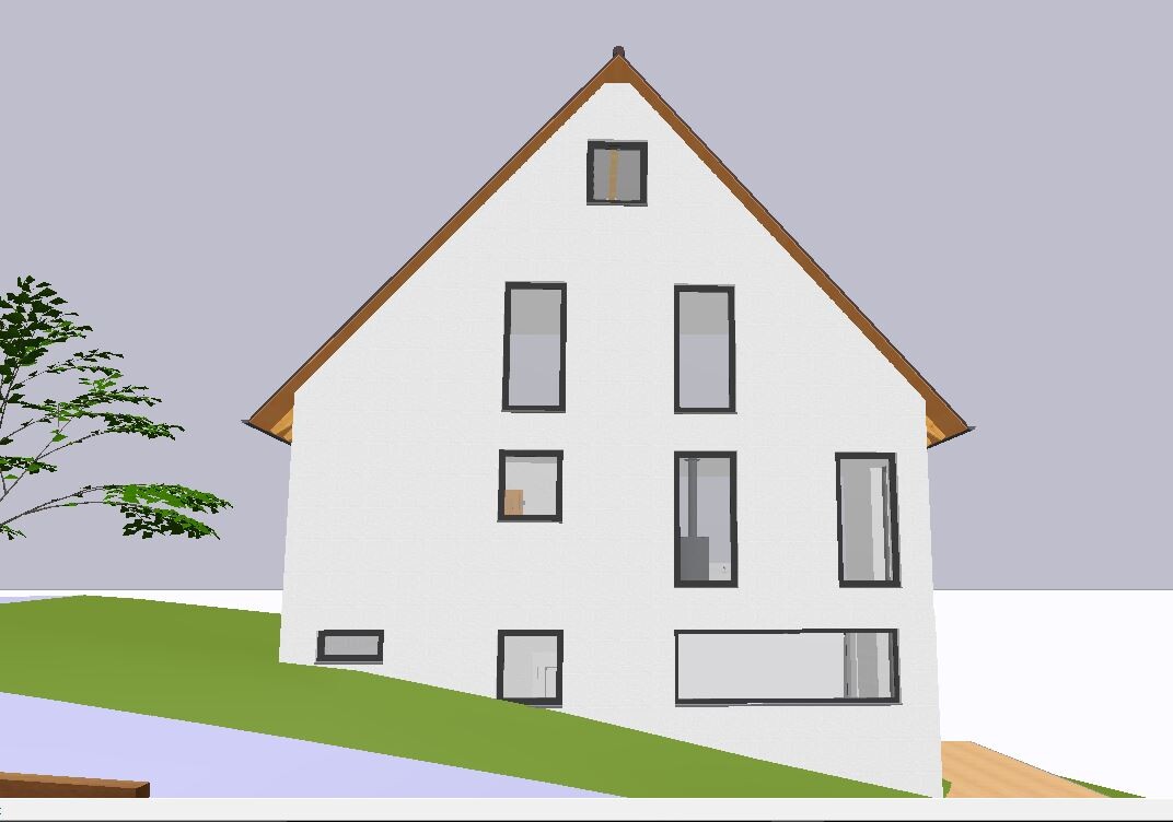

Currently, we are still considering the following questions:
- Floor-to-ceiling windows on the south side: single- or double-leaf? Originally double-leaf with 150 cm (60 inches) width planned. We prefer the look without the division, but then probably max. 120 cm (47 inches) wide would be possible.
- Fixed glazing as a large light strip on the southwest corner of the basement or rather two windows aligned with those above on the west facade?
- Omit the window in the small basement room on the northwest side to improve facade appearance?
- Add 2 extra roof windows next to the dormer on the upper floor to bring more light to the children’s rooms?
- Flooring on ground and basement floors: upper floor will have parquet; still undecided between parquet, continuous granite flooring, or exposed screed/smooth floor for the other two levels
We look forward to your comments!

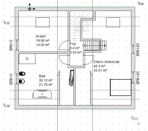

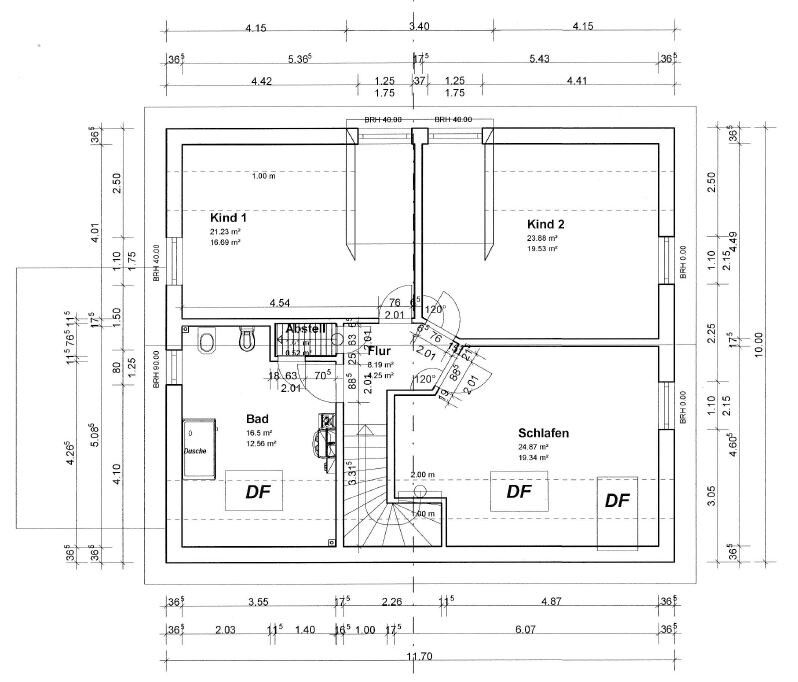

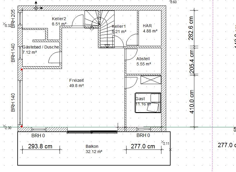

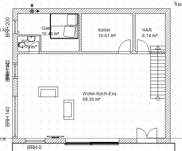

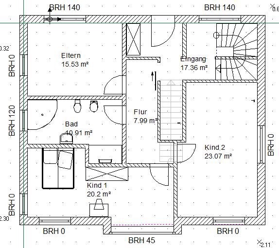

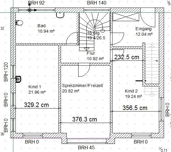

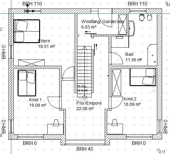

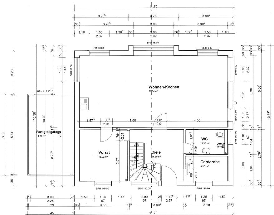

Unfortunately, I don’t find this design coherent. Overall, the rooms are poorly laid out and, in my opinion, way too large.
- A rectangular hall with 60 square meters (645 square feet) as a living/dining area? 60 square meters (645 square feet) is okay for this, but the shape is very uninviting.
- Pantry 13 square meters (140 square feet)? For what purpose?
- The upper floor has only 4 rooms on about 100 square meters (1076 square feet) of floor space – nobody needs a children's room over 20 square meters (215 square feet).
- The basement is not really fully planned; the cellar rooms are all very oddly shaped – where is the utility/technical room? (If that is supposed to be the heating/utility room, 8 square meters (86 square feet) probably won’t be enough).
Furthermore, I don’t think your budget will be sufficient. The basement also includes some areas at living quality, and you may also want to finish the studio.
You should discuss your requirements with an architect and have a design created for you.

I remember the planning back then: you focused on having access from the hobby room to the garden, while keeping the living room and kitchen closed off. I didn’t understand that at the time.
Now, I also don’t understand quite a few things, sorry, for example, the window placements.
Why don’t you hire an architect who can professionally implement your wishes?

I think the washing machine will go in the utility room. So, the longest possible route. Storage rooms and basement are really confusingly laid out.
Garden/terrace and main living area separated is and remains a no-go for me.
The budget will be very tight.
Are you planning to build with masonry or timber frame?
