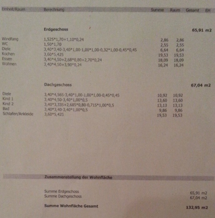

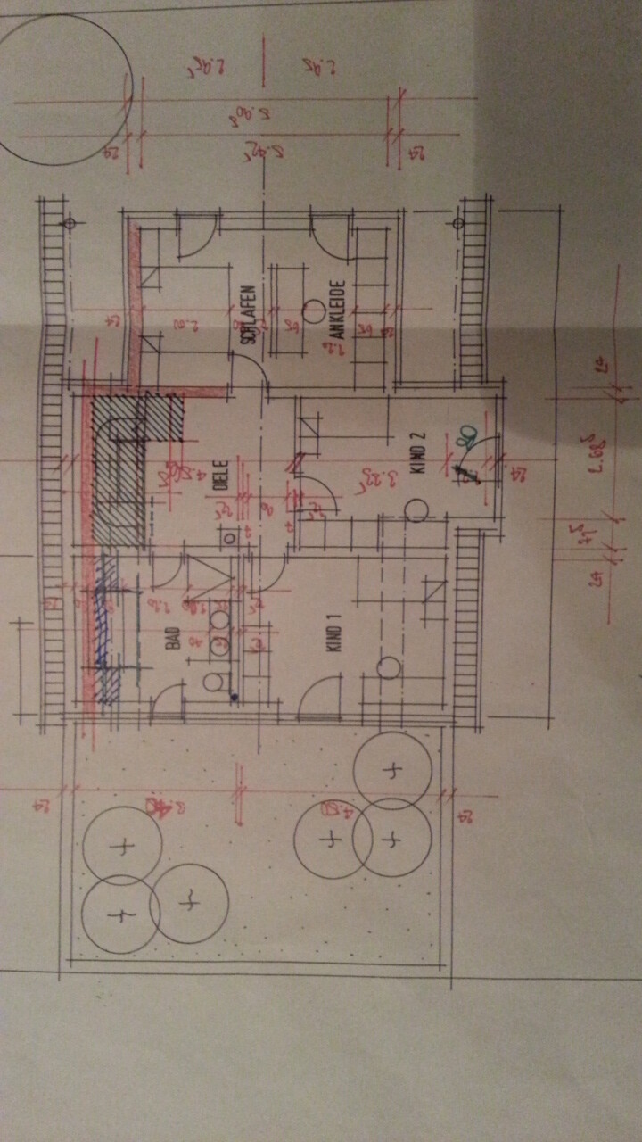

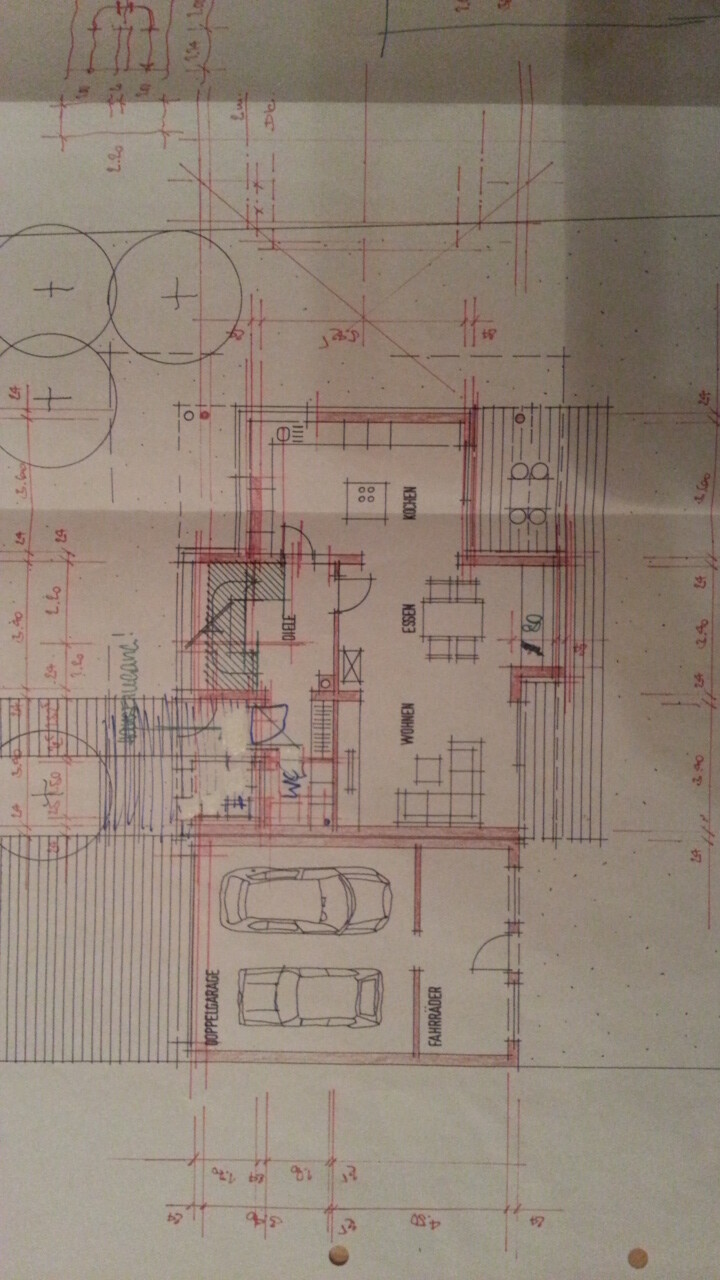

Thelocalwiseman26 Oct 2014 20:37Hello, we are currently planning our floor plan. We want to build a single-family house with about 130 m² (1,400 sq ft) (no more is possible due to the Bayernlabo subsidy, but we don’t need more anyway). Our house will have a basement. On the ground floor, we want an open living / dining / kitchen area. A pantry or storage room is not necessarily needed. Upstairs, it is important to us that both children’s rooms are about the same size. A walk-in closet in the bedroom is also important for us.
What do you think about the current floor plan design? I hope all important details are visible. The main entrance is recessed.
Do you think the rooms are arranged sensibly, or do you have any suggestions for improvement?
Thanks for your help
Thelocalwiseman26 Oct 2014 20:45Sorry, but now ;-)
Who is going to use the staircase area for storing brooms, cleaning supplies, laundry, etc.?
I find the entryway much too narrow. Unfortunately, I can't determine the depth of the hallway. I would estimate about one meter (3 feet 3 inches) without the wardrobe. It will be tricky to receive guests like that.
The location of the staircase is good.
I imagine the house might be quite dark overall – where is south?
Regards, Yvonne
Regards, Yvonne
:-D Yes, now I see more.
The cloakroom area is too small. Just imagine coming home with your family and everyone has to take off their jackets and shoes – it’s going to be cramped.
How do you access the terrace? Do you go past the sofa, squeeze by the dining table, or go through the kitchen?
I find the bay window for the dining area too narrow. Either make it wider or leave it out. In terms of space, it doesn’t add much on the ground floor.
I like the staircase in that location.
I would miss some kind of storage space for various small items that you often need.
I also like the recessed terrace by the kitchen.
The upper floor looks pretty good as well.
