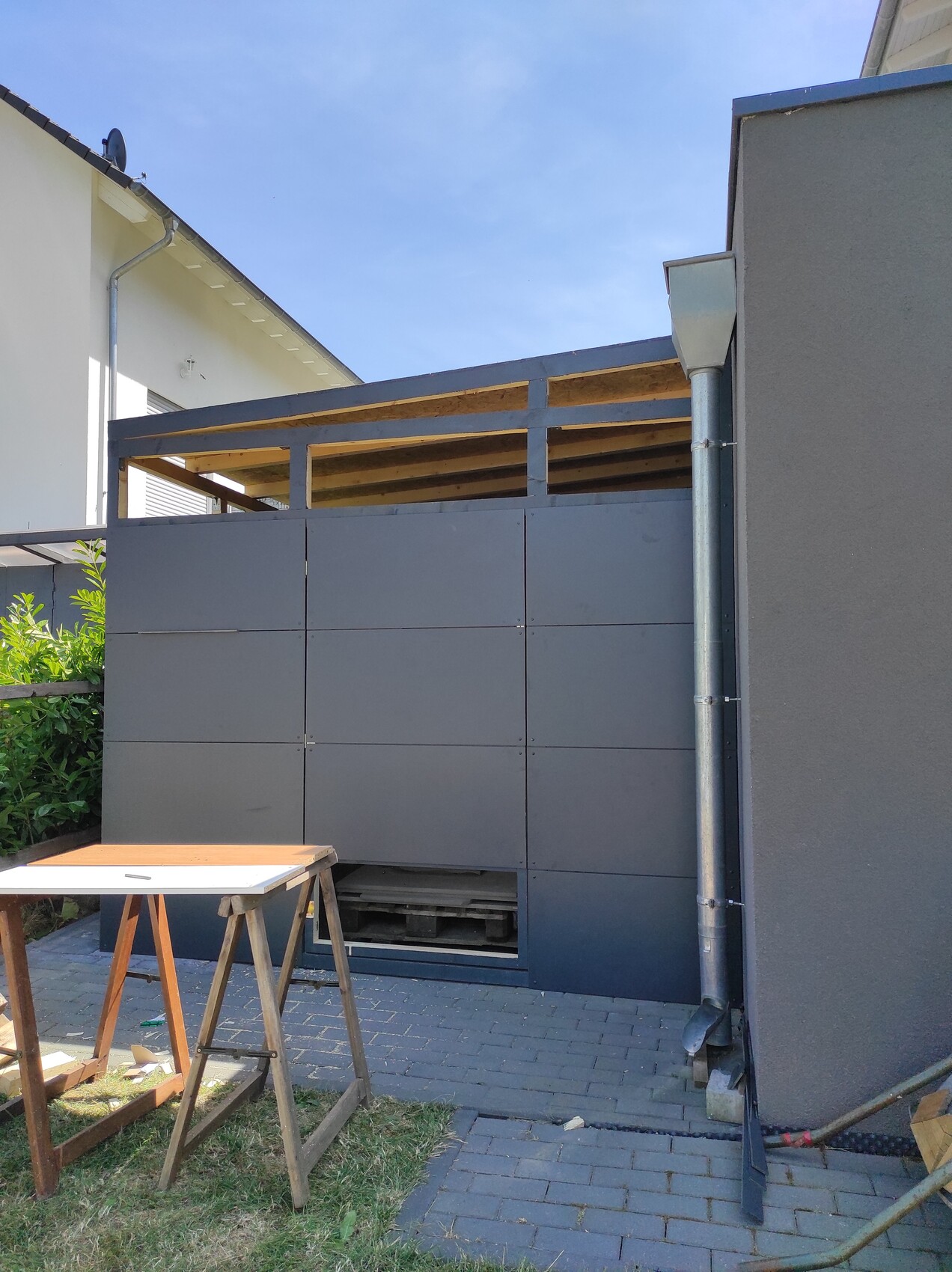

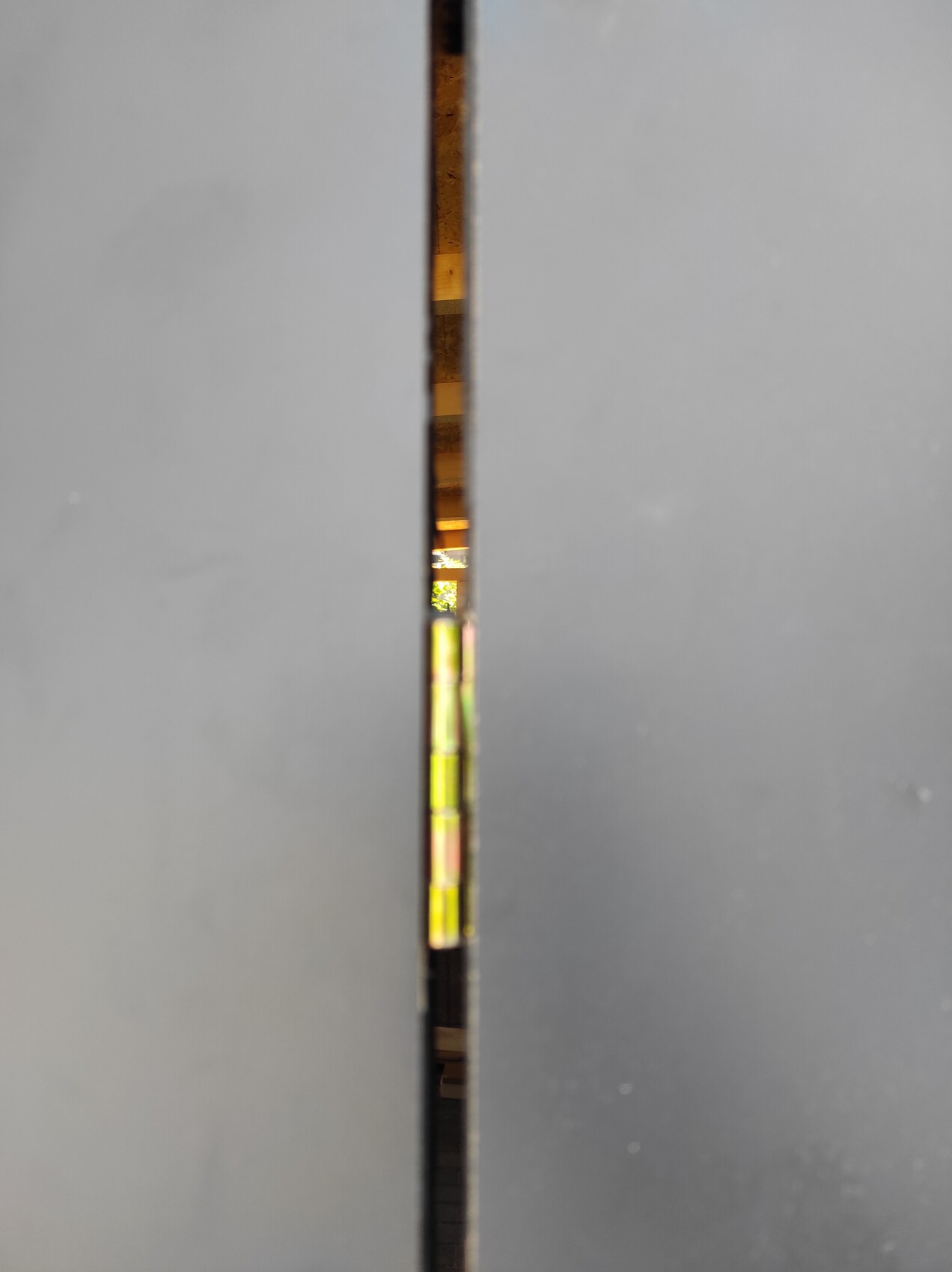

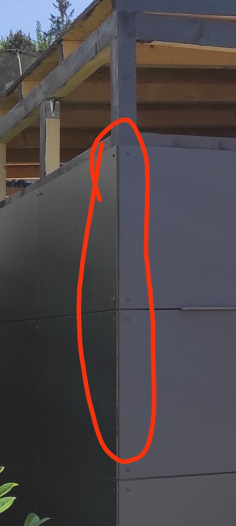

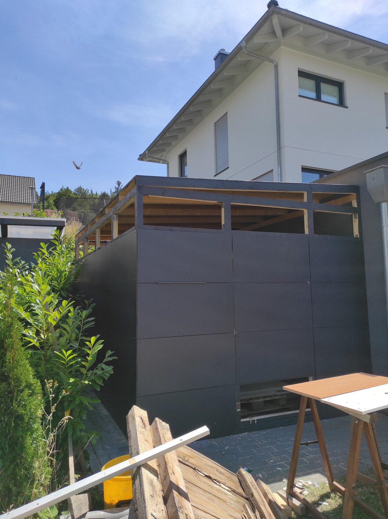

Benutzer 100118 Jul 2022 15:22Today we continued working, but encountered two major problems.
First, one corner, which was supposed to be vertical according to the spirit level, was not. This became clear when aligning the panels edge to edge, with deviations of 3-4mm (about 0.1-0.2 inches) in some places.
Since I didn’t want to use corner profiles here, we cut the panels at an angle on the edges. Luckily, I had ordered the panels 1cm (0.4 inches) longer.
The second problem concerns the door and the hinges.
I bought three hinge straps; ideally, to have equal spacing on the outside, hinges that swing outward like kitchen cabinets should be used. With standard hinges, the door only opens to a 90-degree angle. Currently, there is about an 8mm (0.3 inch) gap on one side, and we had to chisel out a bit of the frame. I think I will also install a weatherproof membrane there to prevent rain from coming in.
A carpenter probably had a better detail solution for this, but it would have been more expensive.
Here is the provisional result.
Taking a break now, my girls have to go to handball practice.

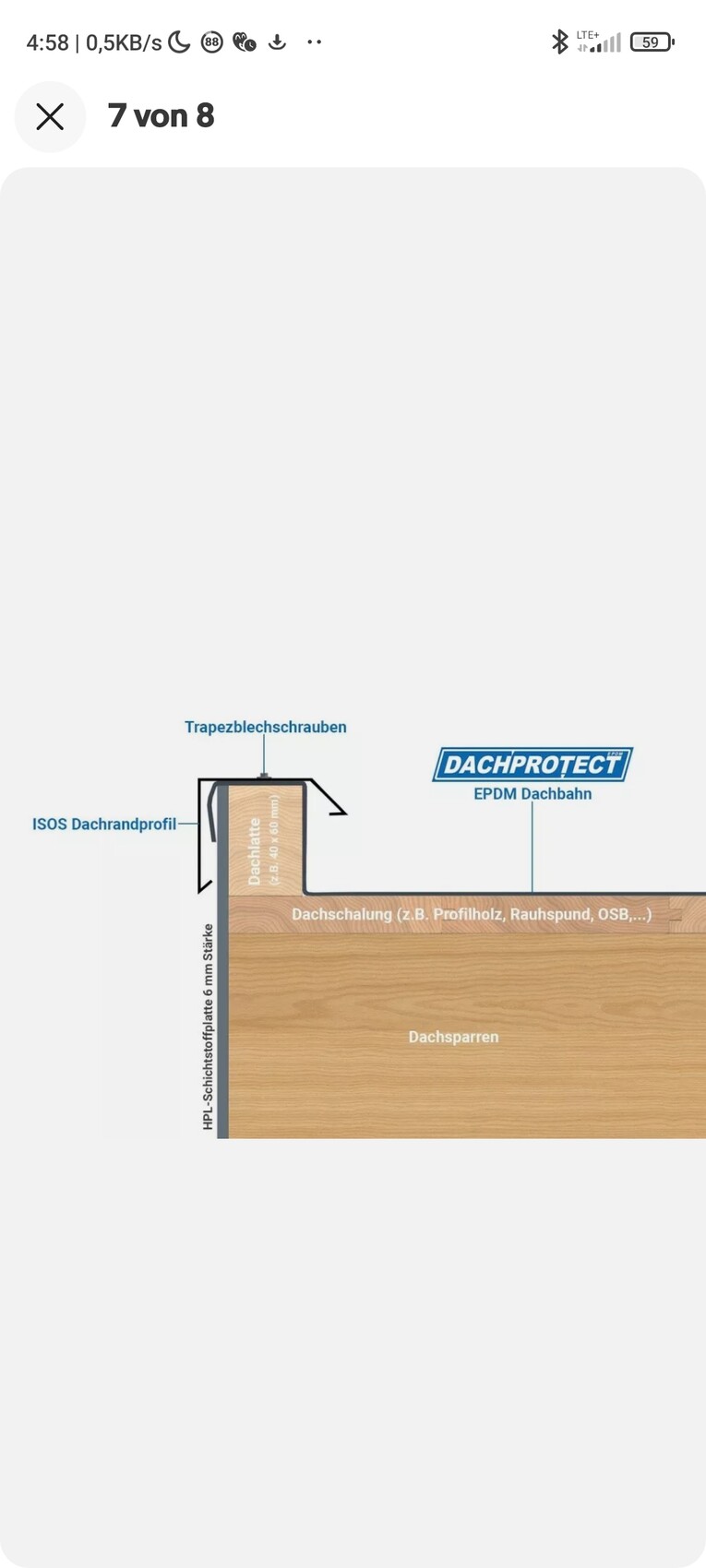

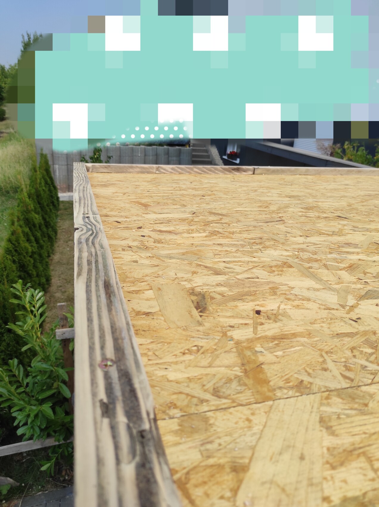

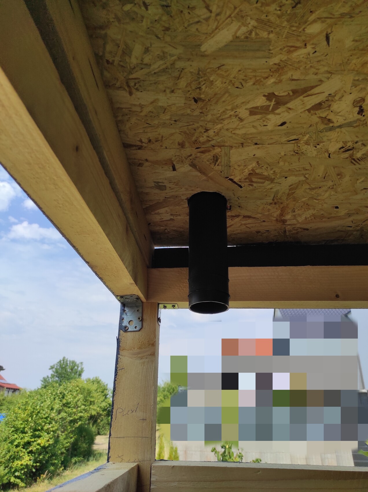

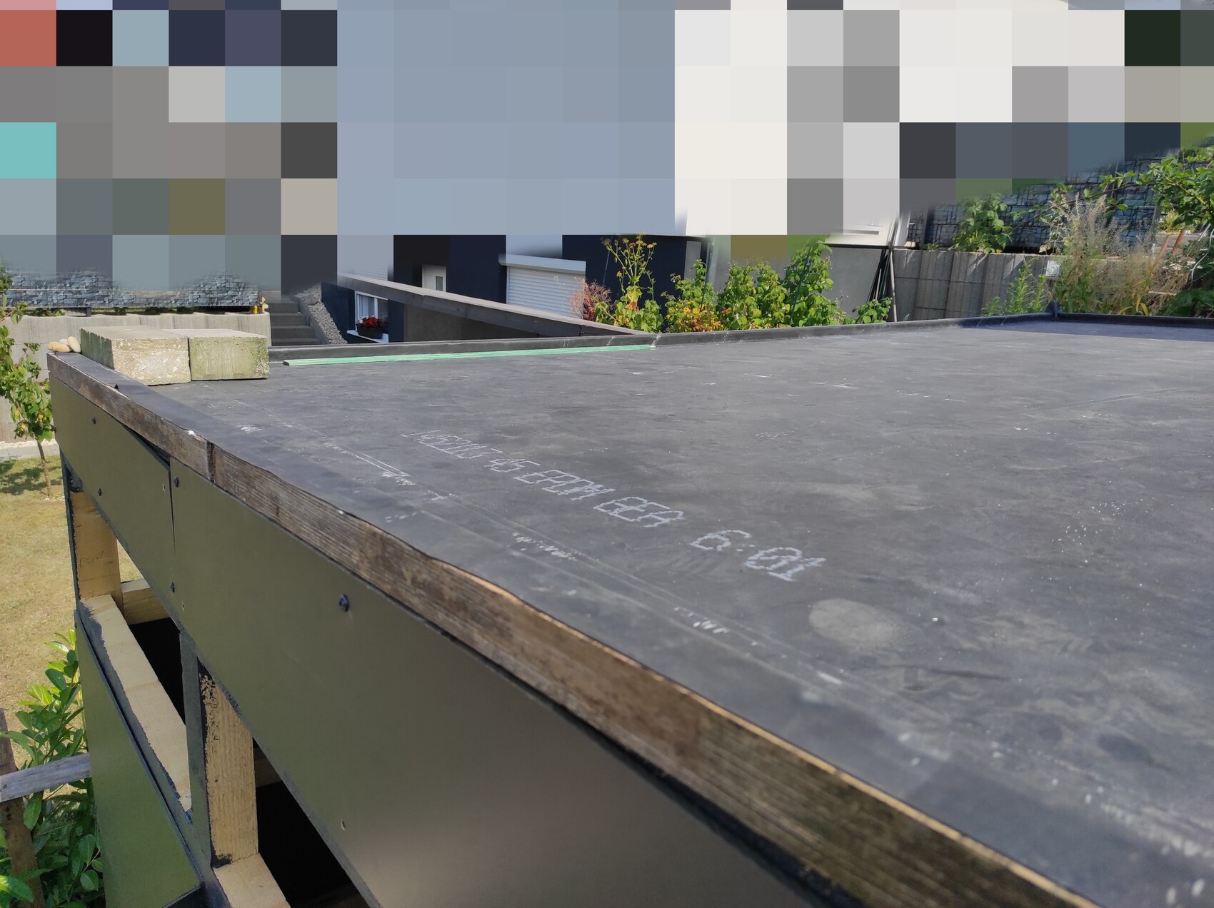

Benutzer 100120 Jul 2022 17:43Today I glued the EPDM membrane and first screwed on the upstand for the verge flashing.
Then I drilled the internal drain and glued it right away. My wife complained about having an internal drain... You can’t place a rainwater barrel there. I’m not doing an HPL facade and installing a gutter there.
Gluing the EPDM was easier than expected. A tip: don’t use too much adhesive, otherwise it won’t stick immediately when pressed down.
The plexiglass is expected to be delivered on Saturday. Then work will continue.
