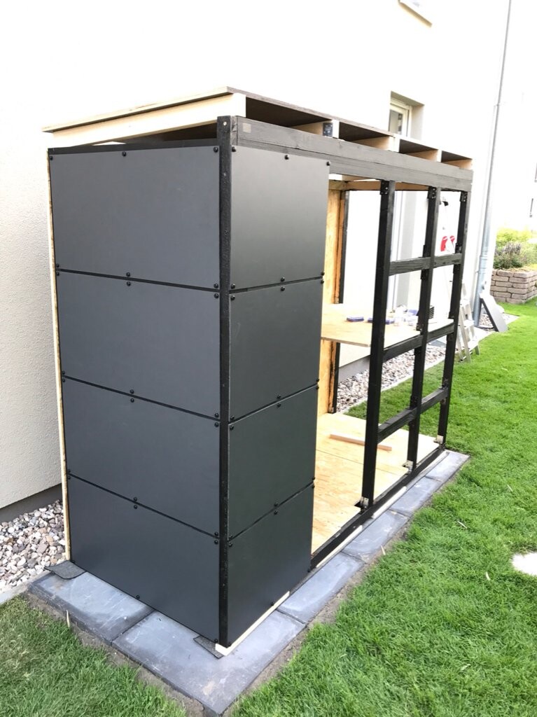

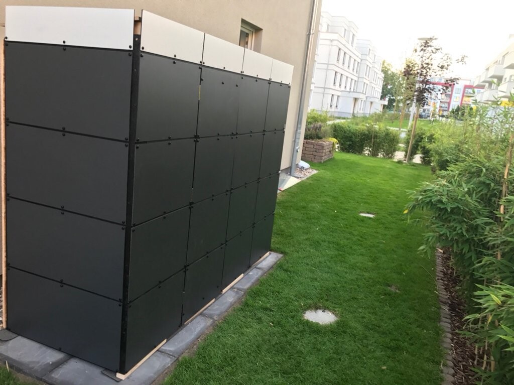

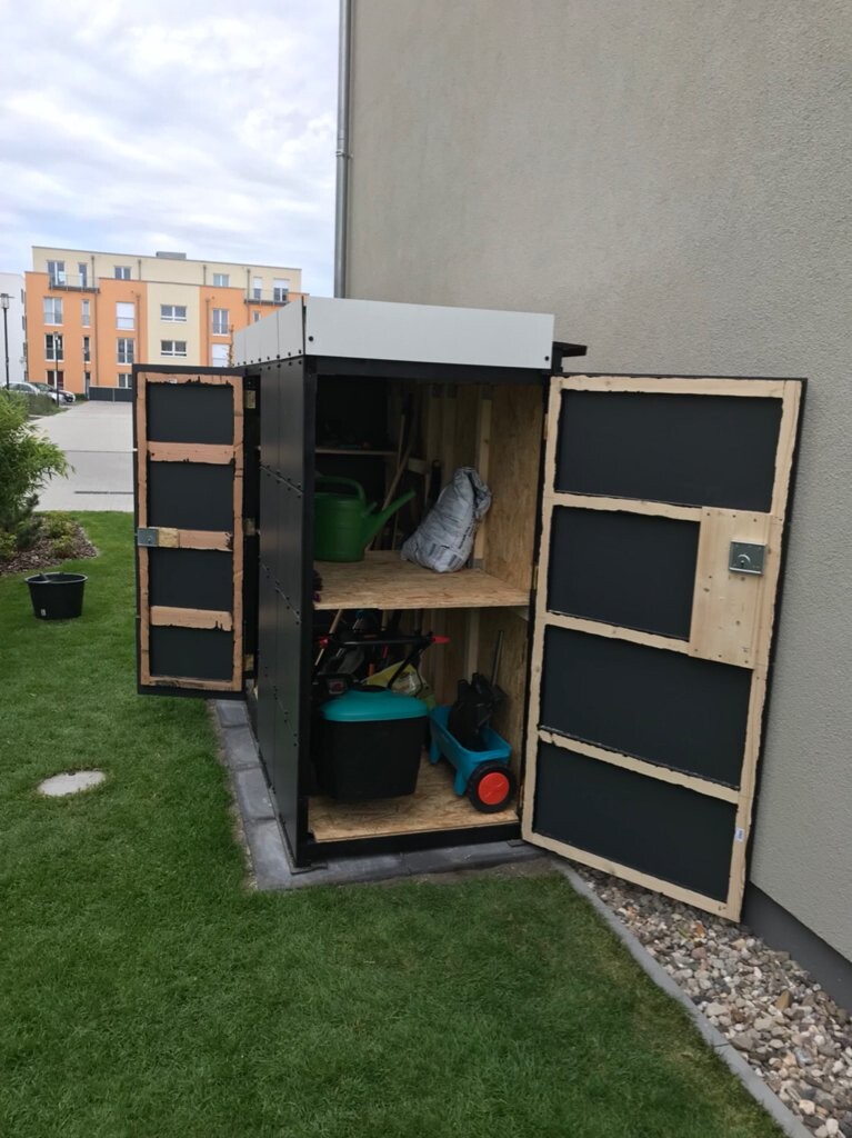

@77.willo
Are those OSB boards in the photos?
Original
And modern!

Olli,
That will be quite a large project. But it will certainly fit well with your place.
