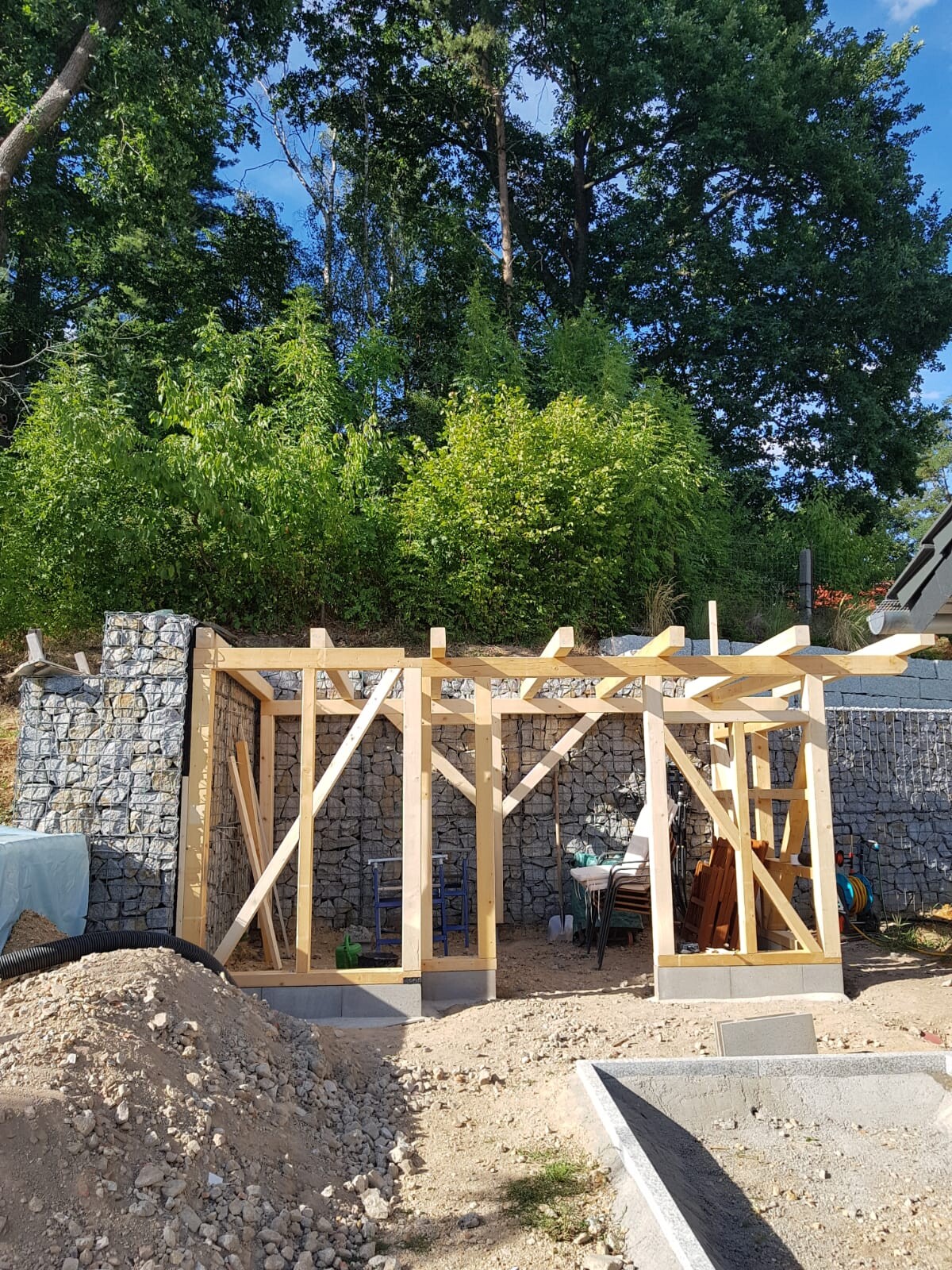

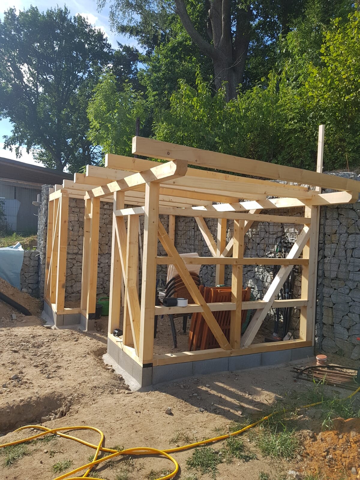

Hello everyone 🙂
I’m currently working on the same project. I had a local timber construction company assemble the garden shed according to my plans and set it on concrete block foundations. Basically, like a kit.
I placed the foundations 10cm (4 inches) above the finished floor level to keep the structural timber (KVH) away from moisture.
I want to build the roof overhang as a boxed soffit to install recessed spotlights. This means there will be several HPL panels where precise measurements are crucial, especially for the joints.
@Offtopic where did you get your panels from and what is the name of the “color”? It looks really good on your build. Your basic concept is similar to mine, except I have two walls made from gabions.
Looking forward to seeing how it progresses. I’m also curious about the plexiglass inserts – they’re on my list too.
Best regards, Bodo

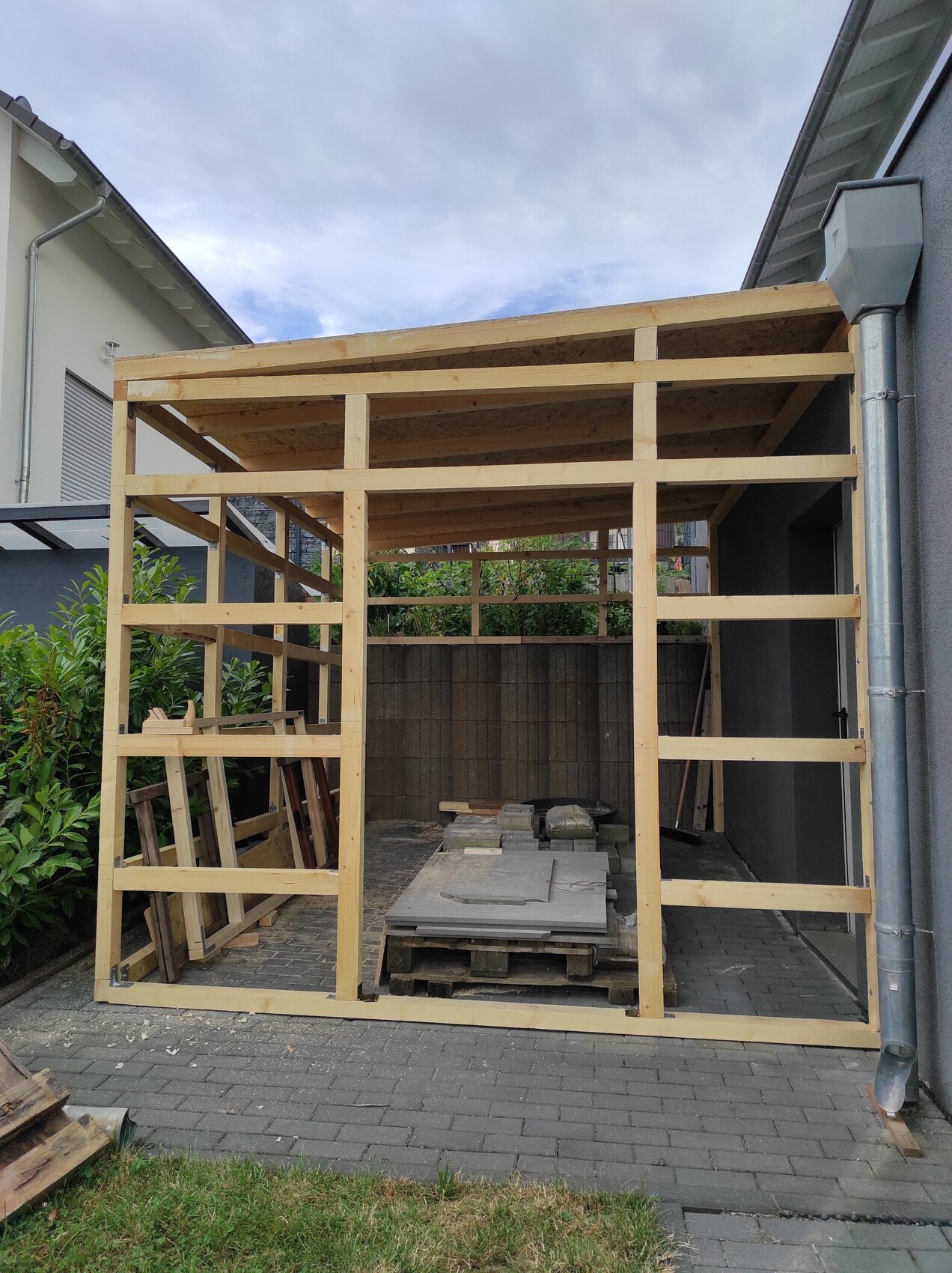

The frame is up so far:
Benutzer 100112 Aug 2022 21:45Good evening
How large are the panels on your side? I don’t see any cross bracing yet.

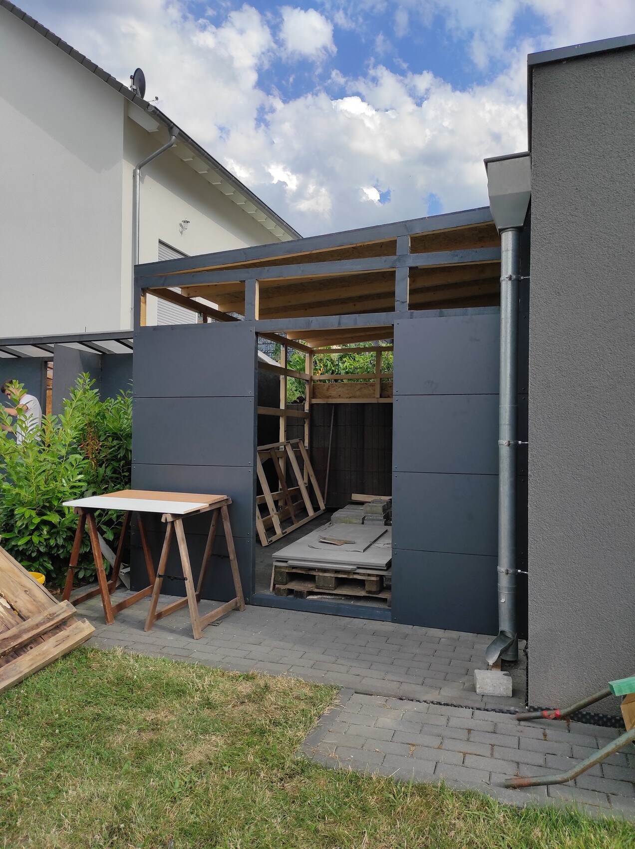

The panels are from Hornbach, color is RAL 7016. Item 10390383
However, Hornbach recently advises against using them outdoors, as the panels tend to warp when exposed to sunlight.
The cut was clean and very straight, though.
By the way, Bauhaus also offers them.
If you need to cut the panels yourself, they can be easily cut with a table saw. I got a fine-toothed blade specifically for this, so the edges hardly chip.
Work will continue in the middle of next week; I’m currently still in Turkey.
