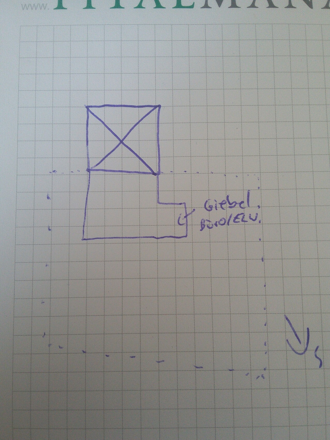

Basement living space costs more than building above ground.However, the house must be mirrored, at least the basic width, roof pitch, and eave height. Optionally, you can extend the length or the width up to the property boundary on the left.
Of course, I can build the house deeper, but then I’m quickly close to the street and have no garden at all.
Do you mean something like in the sketch?
The driveway/entrance would also need to be considered here, which complicates things again. Also, the sun generally comes from the south.
