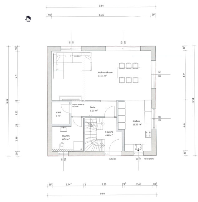

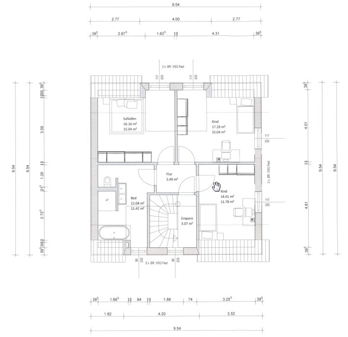

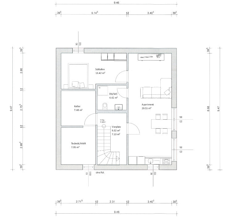

the small plot of 18m by 18m (59ft by 59ft), totaling 324m² (3,484ft²), is located in sunny Baden-Württemberg in a highly sought-after area where there are hardly any plots or available apartments. Therefore, we won’t complain about this "small plot." We have planned for a long time, and the structural engineering should also work out as designed. Now, of course, we are interested in your opinions, especially your helpful suggestions for improvement, criticism, or praise.
I will address technical details separately.
Thank you very much.
Best regards, Freiburger2020

Basement = Separate apartment with private and internal entrances
Floor plan of a house including office/living room, sleeping area, kitchen, bathroom, basement, and hallway.
Isometric house floor plan showing living room, kitchen, bedroom, bathroom, and staircase.
Ground floor:

Upper floor:
Floor plan of a house showing balcony, kitchen/living area, master and children's bedrooms, bathroom, hallway, and sloping roof.

Choose an architect experienced with building infill projects. Without legal requirements, I would have positioned the house quite differently and oriented the garden not toward the street, but toward the parents. This would make it appear larger and possibly be usable without a fence.
