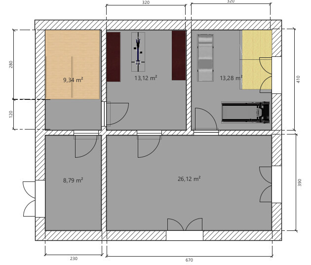

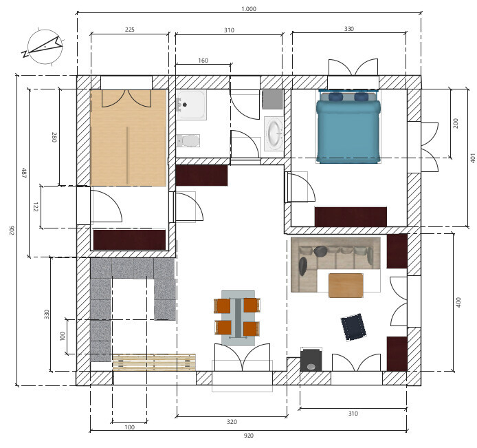

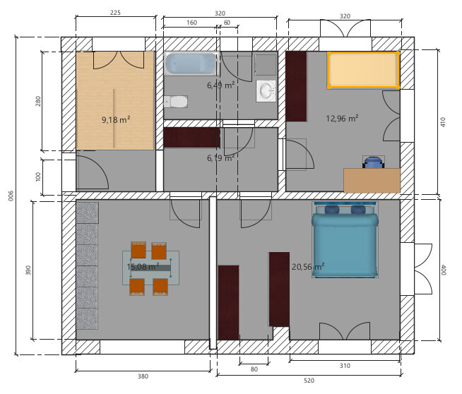

we are planning to build a single-family house and have already thought further ahead. We would like to be able to divide our house into two separate living units if needed. This way, an older child could move into the apartment above while we continue living on the ground floor, or we could rent out the upper unit if necessary. The ground floor should be accessible without barriers, with a shower in the bathroom. I would really appreciate your opinions on the floor plan I have drawn and any suggestions for improvement. Here is the floor plan:
Could you please fill out the questionnaire? The original poster can find the questionnaire here but is also welcome to fill it out in the "Grünen" section. The original poster and post have the same name there.

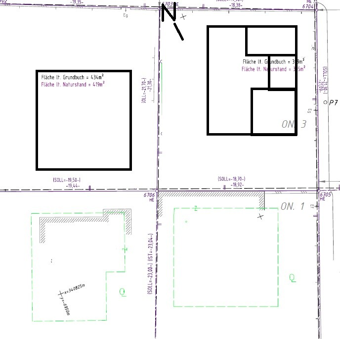

hanghaus202324 May 2025 14:03Site plan without reference to the street?
Is there no zoning plan? With a granny flat, definitely 2 parking spaces.
Building services?
Building services?
