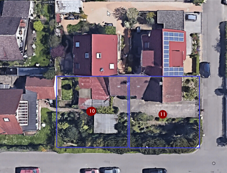

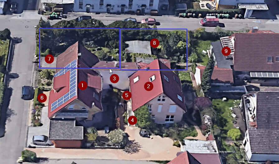

Here is the photo of the plot upside down so you can also see the partition wall in the middle (fire protection wall), as well as the normal view with descriptions. If the fire protection wall were removed, I would have no privacy from the neighbors, hence the extension. Everything that is already there can stay as it is, so we would be really unwise if the wall were removed.
Legend:
1+2: Neighboring houses to which the extension has to be properly connected. Houses need to be aligned.
3: Fire protection wall, excellent privacy screen as the neighbors have their entrances there.
4: Entrance to the neighbor’s granny flat / secondary apartment.
5+6: Entrances to the neighbors’ main apartments.
7: Entrance to the existing old building that is to be demolished and subdivided into two plots.
8+10: My plot, alternatively, the corner plot (No. 11) could have been used, but it offers less privacy.
9: Parents’ plot.
We do not own a car because we use carsharing and don’t need a private or work vehicle. So far, the granny flat also doesn’t require a car. We both had cars but rarely used them. We want to have minimal car parking spaces (probably 2 because of the granny flat).
PS: South is in the upper left corner in the top image and in the lower right corner in the bottom image.
