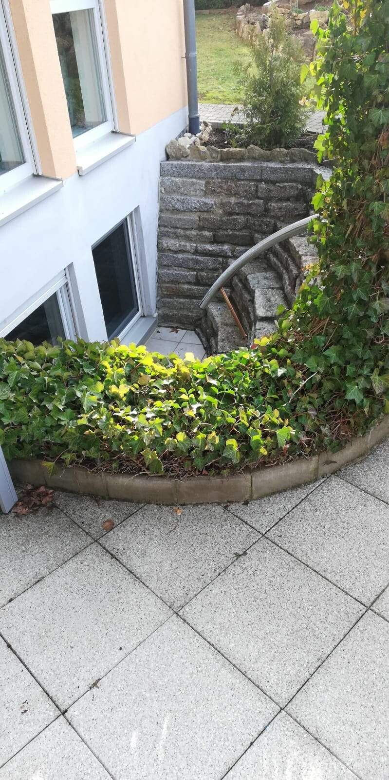

The only thing I see differently from others is the light well.
We also have a light trench right next to the terrace. You just put a railing there and that’s it. I don’t understand the problem. My parents have a light trench by the terrace and so do several friends of ours.

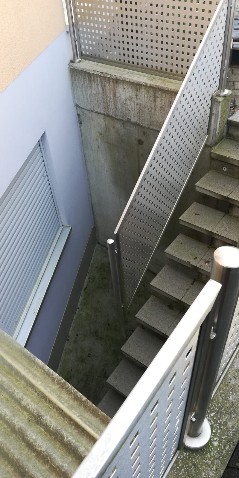

It also has a granny flat in the basement that is also rented out. My project is supposed to replicate this house exactly, with the only change being a small annex in the center as before. In the middle of the plots is a fire separation wall, which will of course remain. It provides excellent privacy and shields the opposite halves of the house.

b) Do you have a good suggestion on how to get more natural light into the granny flat and still make use of the top floor/terrace/garden areas?
A light well isn’t that bad. You even planned a fall protection for it. I also have a light well right next to the terrace. See picture.

An outside staircase is a complex matter. My experience says it’s best to cover it.
2. The light well is essentially unnecessary, but how else do I get light down there?
See above. I combined the outside staircase with a light well. That light well was meant for the office. Today, I prefer to work on the laptop in the living room. That means an office doesn’t belong in the basement. Alternatively, a light shaft with a glass cover also works.
The second door to the office on the ground floor was actually meant to be functional. Private use is the door to the living room, use in connection with the basement stairs is the other door. I understand that’s overdoing it. If the granny flat is later used by ourselves, the internal staircase from the ground to basement is ideal. A closed opening is enough for now, then obviously only one door and perhaps optionally an archway/opening.
Stairs are expensive, outside stairs very expensive. They require many design ideas.
