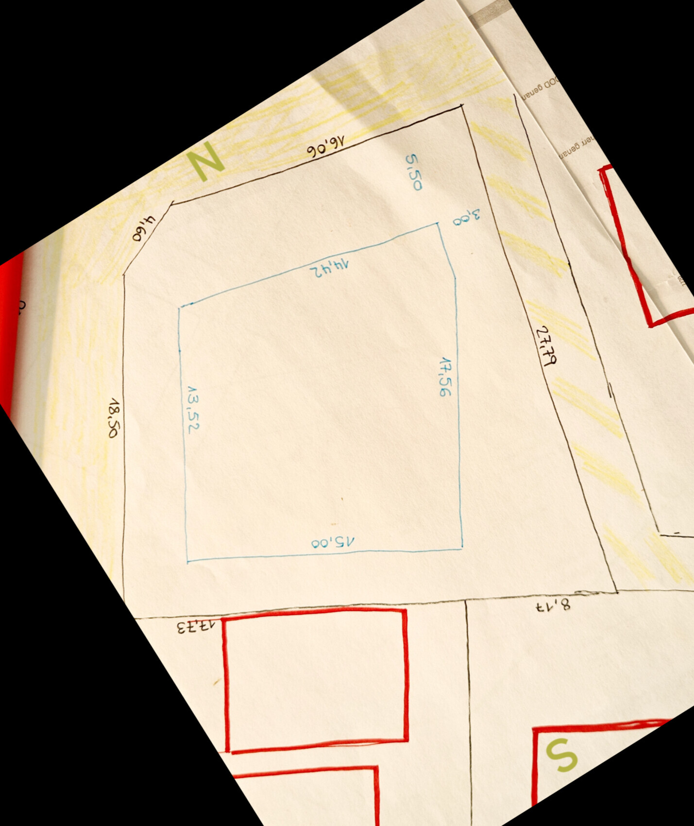

After reading a lot here and planning for three months now, I’m trying to get some help.
The plot is complicated, maybe a bit narrow to also fit a separate apartment on the ground floor.
We are unsure how to “split” the plot.
Who should get the west or east side?
Which street should the house face?
The 5.5 m (18 ft) setback area on the north side suggests itself as the driveway/parking area. Also, no one wants a north-facing garden.
We all want sunlight somehow, but with further construction progress on other houses (marked in red) and the low sun angle, hardly any sun reaches the southern area.
The separate apartment really only needs a sunny terrace (because mowing the lawn will get harder with age).

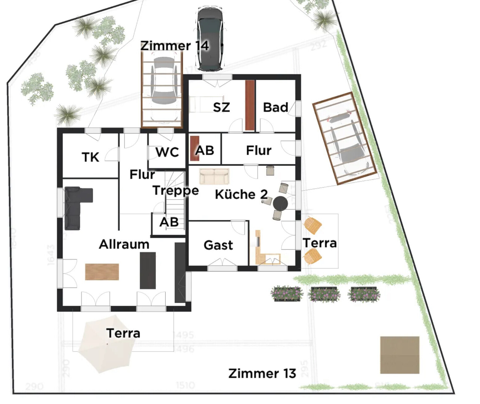

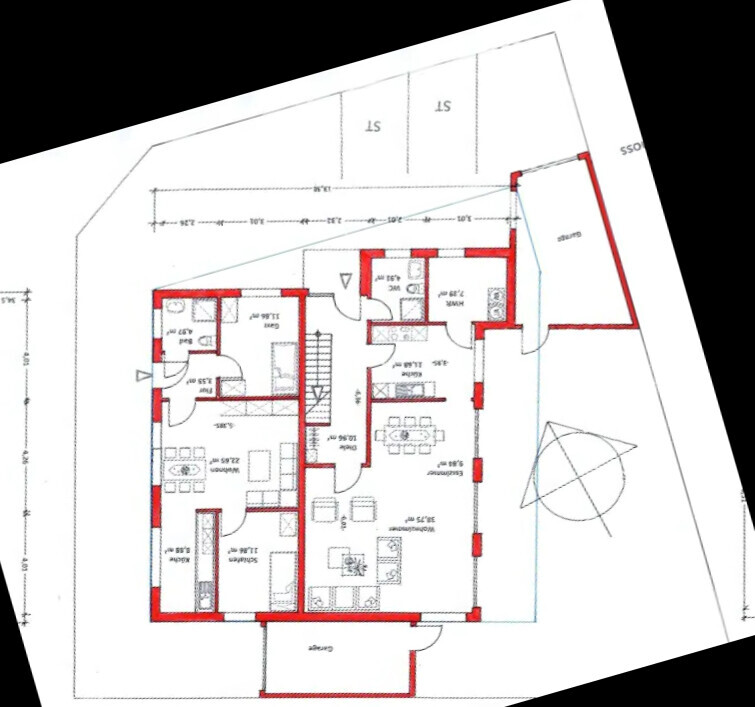

I’ve simply added the architect’s two drafts here.

Why ... @Hausmma had once mentioned somewhere that for the granny flat, having morning coffee on the terrace is actually important. And this east-facing terrace of the granny flat also receives southern sunlight. What about that? Do I have it wrong?
kbt09 schrieb:
What about this? Do I have it wrong in my mind?If it’s placed farthest south at the bottom, there should be sunlight in the morning, right?Ah, yes, it’s tricky. We need to discuss this again.
Hausmma schrieb:
And what I just don’t like is the long, dark, narrow hallway – don’t you have another idea for that? Maybe a different staircase design? Hausmma schrieb:
Okay, you’re right, I would have added a small wall between the kitchen and the hallway. Yes, and with that small wall to the hallway, you get your long, dark, narrow hallway! It has to be said: you can’t have it both ways.
Hausmma schrieb:
If it’s placed all the way south at the bottom, wouldn’t there be sunlight in the morning? May I ask which days and times you mean? I assume the mother is active and uses her day, which means in summer and winter she sits at the breakfast table around 7 or 8 a.m. And yes, in winter it’s still dark then and she’s sitting inside. In summer, she probably also eats inside but likes to go outside sometimes.
Hausmma schrieb:
Her biggest wish: dining table by the window to have breakfast with sunshine in the morning.
(She currently lives in an old, dark house of about 80 square meters (860 square feet) with a large garden that she uses a lot) The sun rises in the northeast in summer, so you might have to consider that.
I don’t read that she’s a terrace-breakfast person as I mentioned earlier, but that she enjoys the morning sun. And that means: the east side!
Hausmma schrieb:
Oh… yes, difficult… we need to sit down again. I find it very difficult to improve a design when hardly anything comes from the original poster except comments about long, narrow, dark hallways.
You want a chill-out area in a corner or niche, a separate kitchen, a short hallway, but lots of space.
You can’t have all of that – not within your budget, not in the building plot, and not on this property. And not with your mother involved.
Accept that and make your compromises. All the designs are good, feasible, and quite developed, even if some aspects remind me of Tetris. But if you want a niche for everything, it’s not going to work.
However, you also need to say what you dislike or like. We are showing you designs on the tablet that were not made in an hour. And Madame says: “Oh yes, difficult.”
Be more specific. Tell us what you find bad, what you don’t understand, what could be great.
So far, you have always pulled back on one aspect or another.
My advice would be not to build yet. You don’t know what you want and can’t decide.
Is it your mother or mother-in-law?
In the northeast, the sun rises in summer, etc., so you might need to consider that.
I don’t read anywhere that she is an early riser on the terrace, as I mentioned earlier, but that she likes morning sun. And that means: east side! Yes, that’s right, it was like that... all the more reason it has to be the east side. If the granny flat is on the west side, there won’t be any morning sun, at any time of the year.
So, I think the plan from post 79 actually meets all the conditions initially stated.
One also has to realize that 537 sqm (5,773 sq ft) with the desired room layout, 2 terraces, and 3 parking spaces requires a considerable plot size. And 537 sqm (5,773 sq ft) is not exactly small, but not very generous either.
I’ll summarize the plans again:
Site Plan:
First of all, the plot is surrounded by roads on three sides. The west side appears to be a larger road, while the east side looks more like a residential street.
Plan 1
Granny flat on the east… however, the summer morning sun in the granny flat is mostly blocked by the garage.
In the main apartment, the combined room is harder to furnish because the room width is about 550 cm (approximately 18 ft), which is actually too wide for a TV area and too narrow for cooking/dining.
Plan 2
Granny flat on the west:
The garage is in the south, actually intended for the granny flat, but access to the main apartment’s garden area is only through this garage. Also here, the kitchen in the main apartment is more like a small two-room apartment kitchen — very small. The living area in the main apartment feels awkward, with a lot of free space that doesn’t seem functional.
By the way, I think the utility room is too small in both plans, since the washer and dryer are also planned to be located there. Especially in Plan 1, it could be too small.
