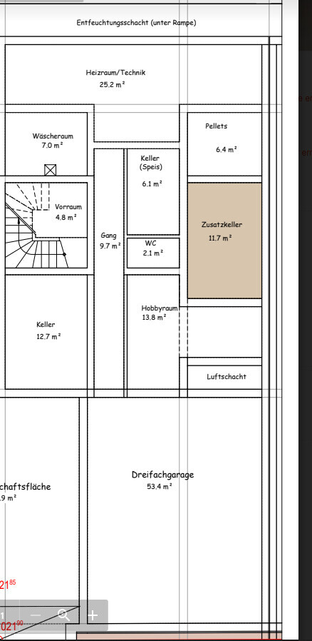

Attached is the basement level with cellar/garage and access road as well as the shared area with the neighbor.
On the east side, windows can be installed, and we definitely want to do that. The plan I posted is a draft of the interior layout. Once we receive the plan including measurements, garden, windows, doors, and furniture, I will of course share it. As I mentioned before, my current goal is just to get some general feedback on the ground and first floor layouts, so we can discuss them with our planner.
Basement floor plan: boiler room, cellar rooms, pellet storage, hobby room, garage.

Attached is the basement level with cellar/garage and access road as well as a shared area jointly used with the neighbor.
Regarding the hallway width, I recommend recessing the heating system, washing machine, and dryer into their designated rooms before the floor slab is constructed. In any case, it is a creative solution.
