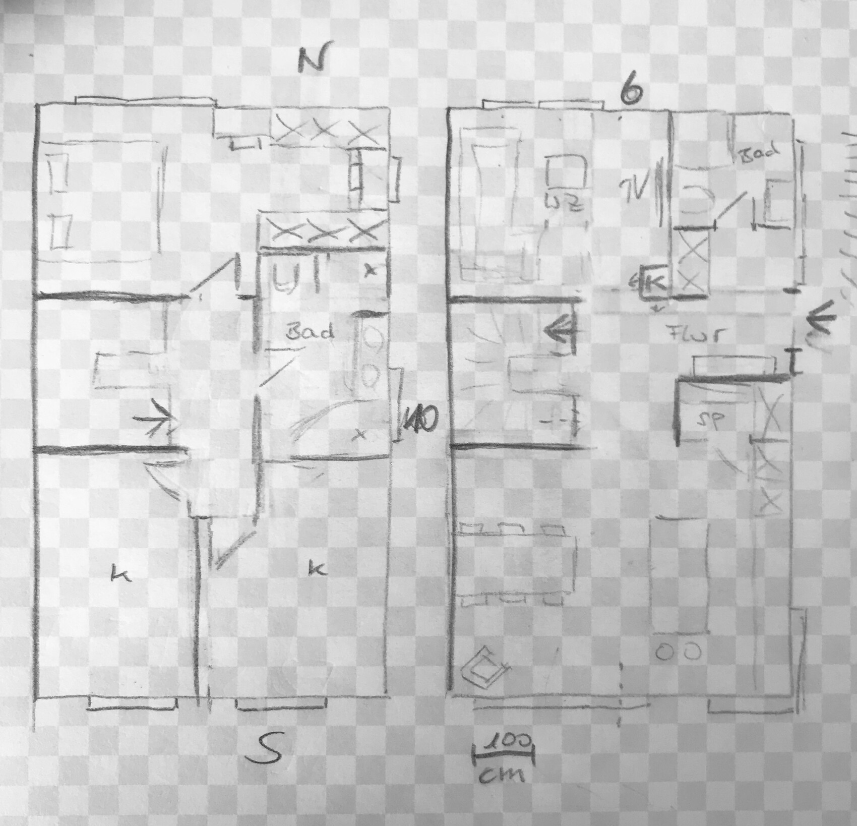

There seems to be a need for clarification on how to access it. Is it via your main staircase? Anyway…
ruebe87 schrieb:
As I said earlier, at this stage I was mainly interested in some rough opinions on the layout of the ground floor and first floor,
That’s clear. But when planning rooms, you also have to consider available window options. In a multi-family house you are much more limited than with a third exterior wall.
I’ll now share an idea where I was initially somewhat “blocked” mentally. Now I see it as quite well done if openness is prioritized. But it would also work if kept more closed off.
The staircase measures 220 x 250 cm (87 x 98 inches), entrance on the east side, to the left is the first floor with the later option to install a fixed staircase to the attic.
If you reduce the size of the closet niche, there would also be space for a small shower toilet there. Then I would make the bathroom on the ground floor smaller and enlarge the cloakroom.
The fireplace is an insert directly in the flue with two or three glass panels. It won’t get too hot. The laundry chute is the stairwell in the middle – which users here say works wonderfully. 🙂

There seems to be a need for clarification on how to access it. Is it via your main staircase? Anyway...
That is clear. But when planning rooms, you also consider the possibility of existing windows. In a multi-family house, you are much more limited than with a third window wall.
I'll share an idea that I was initially somewhat "blocked" on mentally. Now I see it as well executed if openness is prioritized. But it would also work if more enclosed.
The staircase is 220 x 250, entrance to the east, upstairs on the left with the future option of a permanent staircase to the attic.
If you make compromises on the closet niche, there would also be room for a small shower toilet there. Then I would reduce the size of the bathroom on the ground floor and enlarge the cloakroom.
The fireplace is an insert directly in the chimney with two or three glass panels. It doesn't get too hot. The laundry chute is the stairwell in the center – according to users here, it works wonderfully. 🙂
I really like the floor plan!
Yes, I also think it offers a lot more value compared to a long corridor with arbitrary widths. Of course, you can refine the windows and many other details, but the basic layout works well with nice sight lines.
The living room is a good retreat here, and if needed, you can find a custom door solution (sliding door) that keeps the open feel. There is also enough space for furnishings...
Myrna_Loy schrieb:
For that, you would need to know if there are any design regulations. Maybe balconies are mandatory, and the entrance must be on the narrow side.
If the balconies are required, that would still work. The entrance can be on the east side 😀
@ruebe87
Is it worth refining the sketch? Are you interested? If it rains this evening, I can try to "visualize" it.
Do you have any requests that I could try to include?
