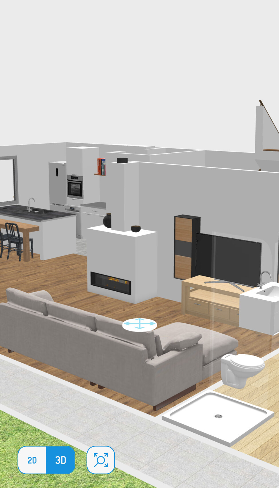

You’re right about that…
…but once the house is warmed up by the stove, the heat in a new build can usually last for 2-3 days during the transitional season. So it can work well as a heating substitute.
I find it a bit bulky for the relatively small room.
That’s correct, the new builds in our area have to meet certain insulation values, so heat hardly escapes from the house anymore.
Regarding the stove, I’m confident that together with our stove installer we can find a solution that fits the room without having more stove than room 😉
Attached is a possible solution (the stove window is obviously not accurate).
Open living area with sofa, stove, TV, kitchen island and bathroom with shower/toilet.
kbt09
19 Sep 2021 17:51
