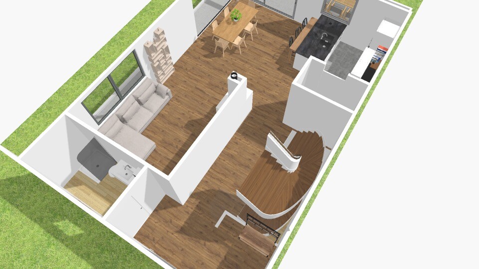

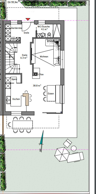

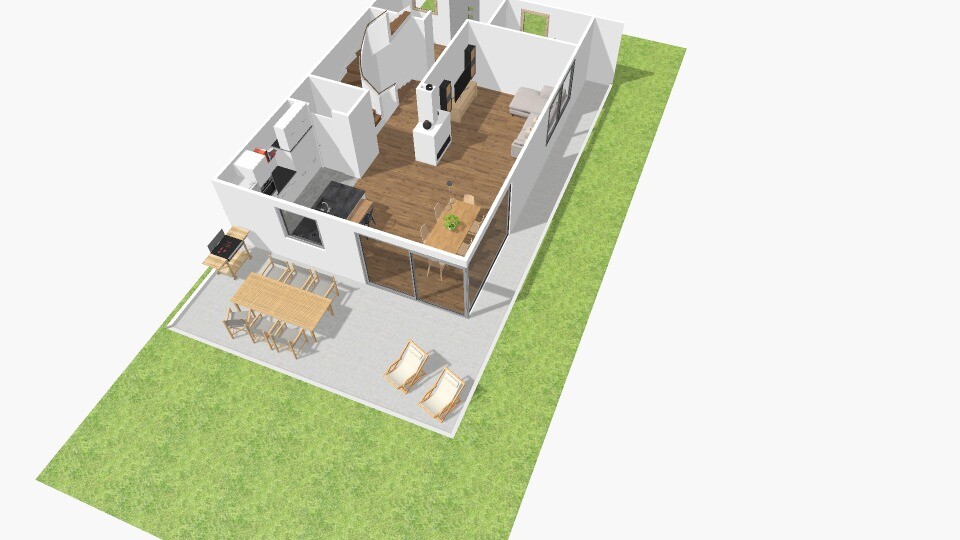

So, here is an update after some time. We have received the plans for Preliminary Project No. 2 and have made a few considerations:
Ground Floor
- We want the partition wall between the entrance hall and the living room to be straight
- The dining table will be freestanding, and there will be a glass corner facade, but with a pillar (because of the guide rail for the venetian blind)
- We are still undecided about the pantry, leaning more towards no (because of the cellar)
- The cloakroom and guest bathroom with shower fit well

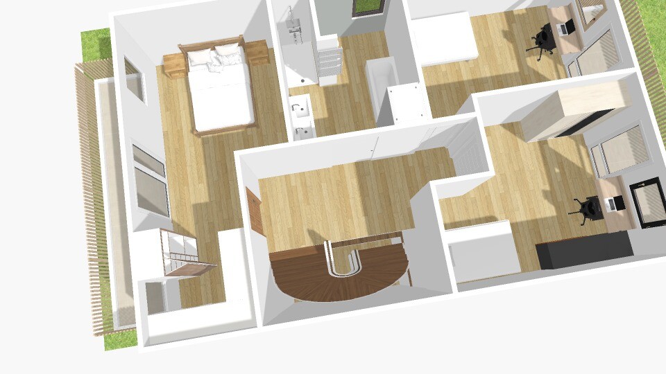

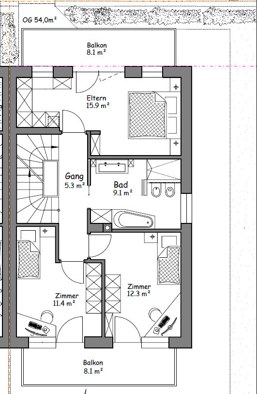

Upper Floor
- Master bedroom is okay
- Children’s bedrooms are okay
- Regarding the bathroom layout, I’m concerned that the sink area might get little natural light. How would you arrange the bathroom?
We look forward to your feedback 🙂

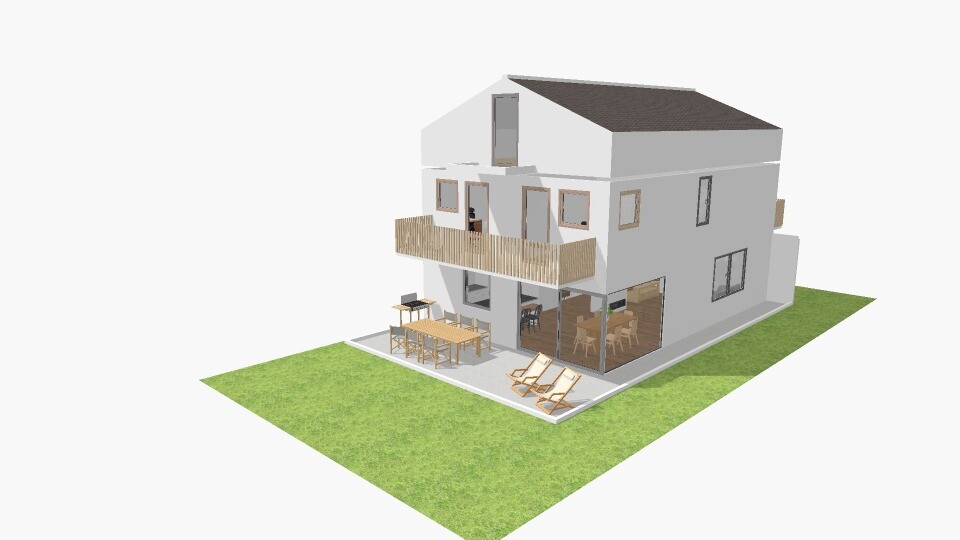

By the way, I can’t find any of the basement light wells above ground anywhere ...... not even now in the isometric view with the plot includedhttps://www.instagram.com/11antgmxde/
... still not included in the isometric drawing with the plotAs soon as the layout of the basement is finalized, these will be added. Currently, there are still some issues to resolve (light well, ventilation shaft, etc.)M
Myrna_Loy16 Sep 2021 15:54I would place the bathtub under the window and avoid using a space-saving coffin-style model. Instead, I would install a toilet and bidet in place of the bathtub.
