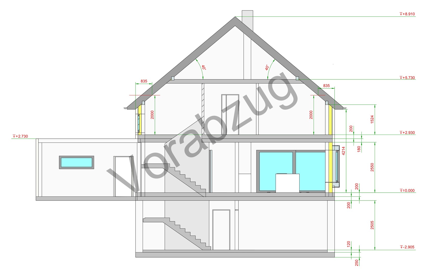

If the data here is correct with a 40-degree roof pitch, then your 2-meter (6.5 feet) mark is simply wrong! You have a maximum knee wall height of 130cm (51 inches)… with an interior recess of about 80cm (31 inches) you reach your 2 meters. And at that height, I definitely don’t see a shower fixture. Or do you want to say that your windows top and bottom are the same heights or that the two windows on the upper floor are 3 meters (10 feet) high?

If the data here is correct with a 40-degree roof pitch, then your 2-meter (6.5 feet) mark is simply wrong! You have a maximum knee wall height of 130cm (51 inches)… with an interior recess of about 80cm (31 inches) you reach your 2 meters. And at that height, I definitely don’t see a shower fixture. Or do you want to say that your windows top and bottom are the same heights or that the two windows on the upper floor are 3 meters (10 feet) high? I have prepared a cross-section view to show the situation with the 2-meter line more clearly. I will upload it shortly.

Hello, I have uploaded a cross-section and exterior views again.
I will soon upload additional exterior views. Simply moving the living room window might look odd. Currently, except for the large corner window, everything on the south side is symmetrical.

- The steep roof with a low knee wall is unfavorable and is neither required by the building permit / planning permission nor by space requirements. It would be better to have a (very) high knee wall with a 22-25° roof pitch, possibly executed inside as an exposed roof structure. This way, you won’t have problems with sloping ceilings and can plan windows on the eaves sides.
