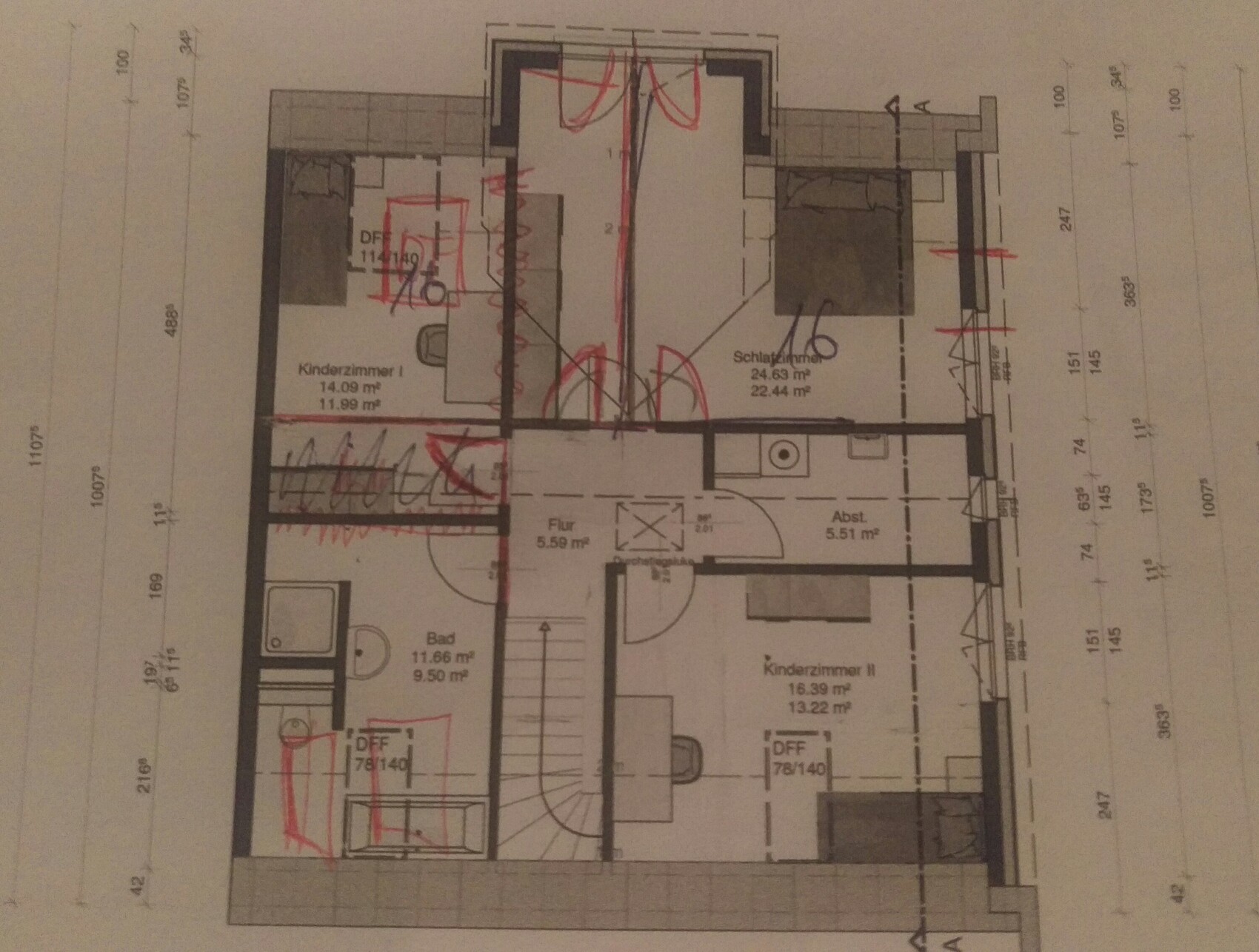

29 May 2017 22:26
The top part is not finished yet... more will follow..
E
Ev-Marie86
29 May 2017 22:29
I’m still not completely happy with everything... but I’m open to ideas. I know you don’t like the storage room, but I’d rather not give it up... even if it’s just turned into a dressing room. As I said, ideas are welcome...
Floor plan of an apartment: bedroom, two kids' rooms, bathroom, hallway, storage room.

About the upper floor (from #175): the bathtub must fit with the “head end” still within the 2m (6 feet 7 inches) zone, so it needs to be rotated 90°.
