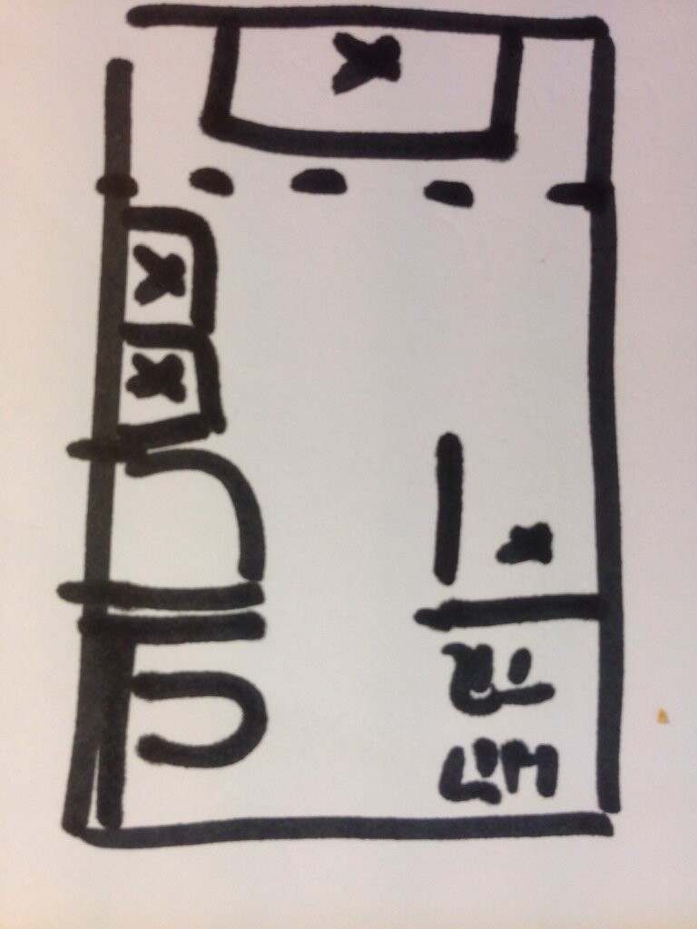

Ev-Marie8630 May 2017 11:01Under the stairs is fine... so just leave the bathroom as it is... ??
Ev-Marie86 schrieb:
Under the stairs is fine... so leave the bathroom as it is ... ??To be honest, I could barely make out anything on the sketch.

Ev-Marie8630 May 2017 12:56Sorry... I just don’t get it somehow

And another dormer is not allowed because of the development plan… the area would then be too large, and we are only allowed to build 1.5 storeys… I’m not quite sure about that: yes, the attic is relatively large due to the 45° roof pitch and the concealed knee wall, so you’d have to precisely calculate the “full storey” to see how much “space” is left. On the garden side, there is only a dormer on one third of the eaves length, and currently none on the entrance side – so there should still be some room for adjustment.
Ev-Marie86 schrieb:
Sorry… I somehow don’t get it Maybe that’s for the best.
The illustration in #198 probably shows your bathroom (rotated to true north, so “washing machine” and “dryer” appear upside down). However, I would interpret the bathtub to be where you want to remove it. I’d rather arrange the fixtures in the area with under 2 meters (6.5 feet) ceiling height.

Ev-Marie8630 May 2017 13:37The number of floors was checked... more than that is not possible... We had already asked about this... because I originally wanted two...
