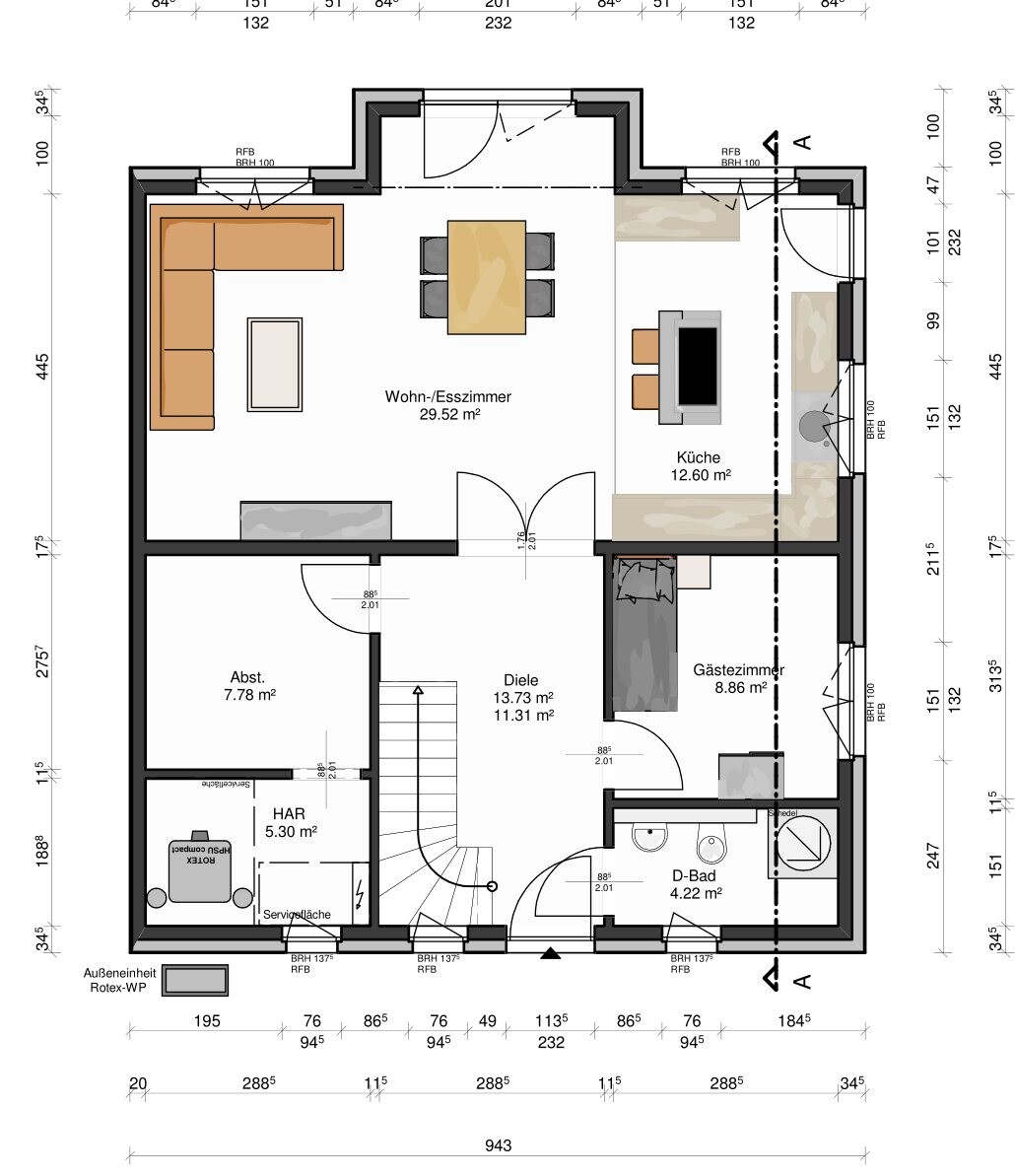

E
Ev-Marie86
29 May 2017 21:19
Hello everyone... Here is my new proposal... looking forward to your feedback...
Floor plan of a living/dining area with kitchen, hallway, guest room, bathroom, storage/utility room.
Nordlys
29 May 2017 21:39
Is it possible for the guest bathroom door to open inward? That way, they wouldn’t bang into each other. In my opinion, the windows on the front facade are too narrow and slit-like. Slightly wider windows would make it look less bunker-like. My beloved back door has been removed, but I know it was never that important to you. The pantry has now become a proper storage room with space. You could even install a utility sink in there for dirty tasks. Since there’s already a water connection, it wouldn’t be difficult. Such a sink costs around 150 (currency) installed. And when you harvest early potatoes and scrub them, you’ll be glad to have it. Karsten
29 May 2017 21:59
Yes, it’s definitely better. It reminds me of my first suggestion from #83, where I stopped planning the straight staircase because you didn’t like it.
I would stick with my kitchen proposal; I find it more thoughtful in my sketch when the tall cabinets are boxed in.
Best regards, Yvonne
