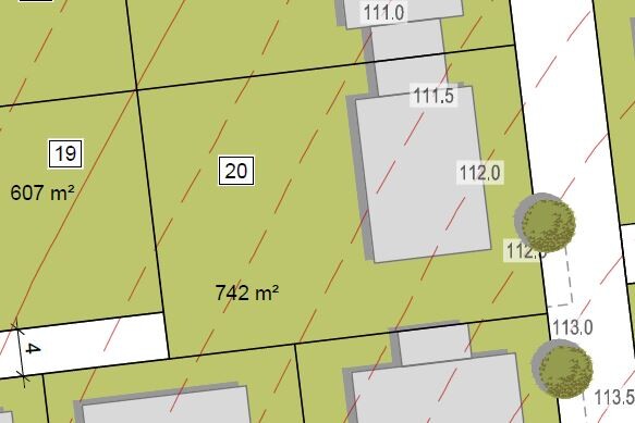

To further illustrate, here is the exact orientation of the plot on a north-oriented plan. This is an urban development design. However, it roughly matches our idea of how the house should be positioned on the plot. Only a 2m (6.6 ft) gap should remain between the neighbor to the north and the garage.
Here is the scanned site plan (not very neat but functional)

. There should be a 2m (6.5 feet) gap only between the neighbor to the north and the garage.
Either you place the garage on the property line (boundary building) or keep it 3 meters (10 feet) away from the neighbor. You probably won't be allowed 2 meters (6.5 feet).
