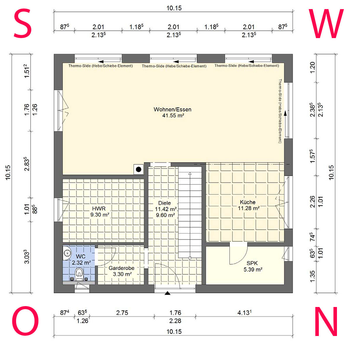

we are almost finished with our planning phase. That’s why we would like to hear your opinion on the floor plan of the house. I have been enthusiastically reading this forum for months now. I especially appreciate the helpfulness and the respectful tone here. However, this does not mean you shouldn’t give criticism. We are grateful for any comments or ideas for improvement.
A small issue is the orientation of the plot. Our main facade faces southwest, but once the house is built, there will be only about 6 meters (20 feet) to the neighboring property (depending on where the double garage is placed). The main garden is also oriented to the northwest. We planned the terrace in an L-shape from southwest to northwest. We will probably spend more time on the northwest terrace (which is why there is a sliding door leading outside there). If the main facade (living/dining area) were oriented northwest, I think the living room might become too dark (north-facing). But I’m open to being corrected if that is not the case.
Initially, there was an office planned on the ground floor. But that would have made the kitchen too small. We have now planned the office on the upper floor, which is fine for us. The bathroom is located on the north side but has a good size (should be sufficient). At first, we wanted a T-shaped layout (probably because it is often seen in model homes and we liked it there). However, I think an L-shaped layout might be better here. In front of the toilet, there is a planned privacy wall about 1 meter high (3 feet).
I have marked the floor plans with compass directions and measurements. The house measures about 10 x 10 meters (33 x 33 feet) externally (this does not have to remain that way). I also sent furnished versions of the floor plans. The plot is included as well, but without a building envelope shown (full width and about 20 meters (66 feet) deep from the street). The attached exterior views match the floor plan, except the street view on the ground floor has changed slightly (kitchen and pantry windows are different from the exterior view). Additionally, in the floor plan, the sliding door in the living room has been shifted slightly inward to avoid the couch blocking access to the terrace.
For the exterior views, the street is unfortunately shown on the wrong side (now southeast as per the floor plan). We had originally planned for a different plot, but there were some issues (slope, etc.). We were able to acquire this plot at short notice. The garage is also shown rotated and does not necessarily have to have a separation from the house.
I’m sure I have forgotten some things but I will try to answer your replies as quickly as possible. We are looking forward to your opinions/criticism.
Best regards from Bavaria

We should definitely be slightly above street level because the plot gently slopes upward away from the street. Or did you mean something different here? Maybe that’s also why both thought it would work without a raised platform.
4 May 2018 01:12
Zisu2000 schrieb:
We should definitely be slightly above street level since the plot slopes gently away from the street. Or did you mean something else here? Maybe that’s also why both thought it could work without a platform.
Without a platform means for the builder: with a small platform. No stairs [emoji6] And the platform would then be one meter deep. This eliminates the entire driveway unit to the left of the house—whether with a garage or carport.
And between us: an entrance area is very important. The front door! The entryway! There should be a step there. You put flower pots, plants… an entryway is designed to welcome visitors.
By “in front of the living room” I naturally mean the space between the driveway and the living room window… there is enough room there.
Z
Zisu2000
4 May 2018 01:26
Ok, I thought so. There really would be enough space there. And the point about the entrance area is true. It should definitely be inviting. Hmm, we’ll definitely think about that again.
Maybe there’s still enough space to the left towards the neighbor if we leave 1-1.2m (3.3-3.9 ft) between the garage and the house. That would be 5m (16.4 ft) up to the property boundary. With a terrace, it might be a bit tight, but it could be worth considering.

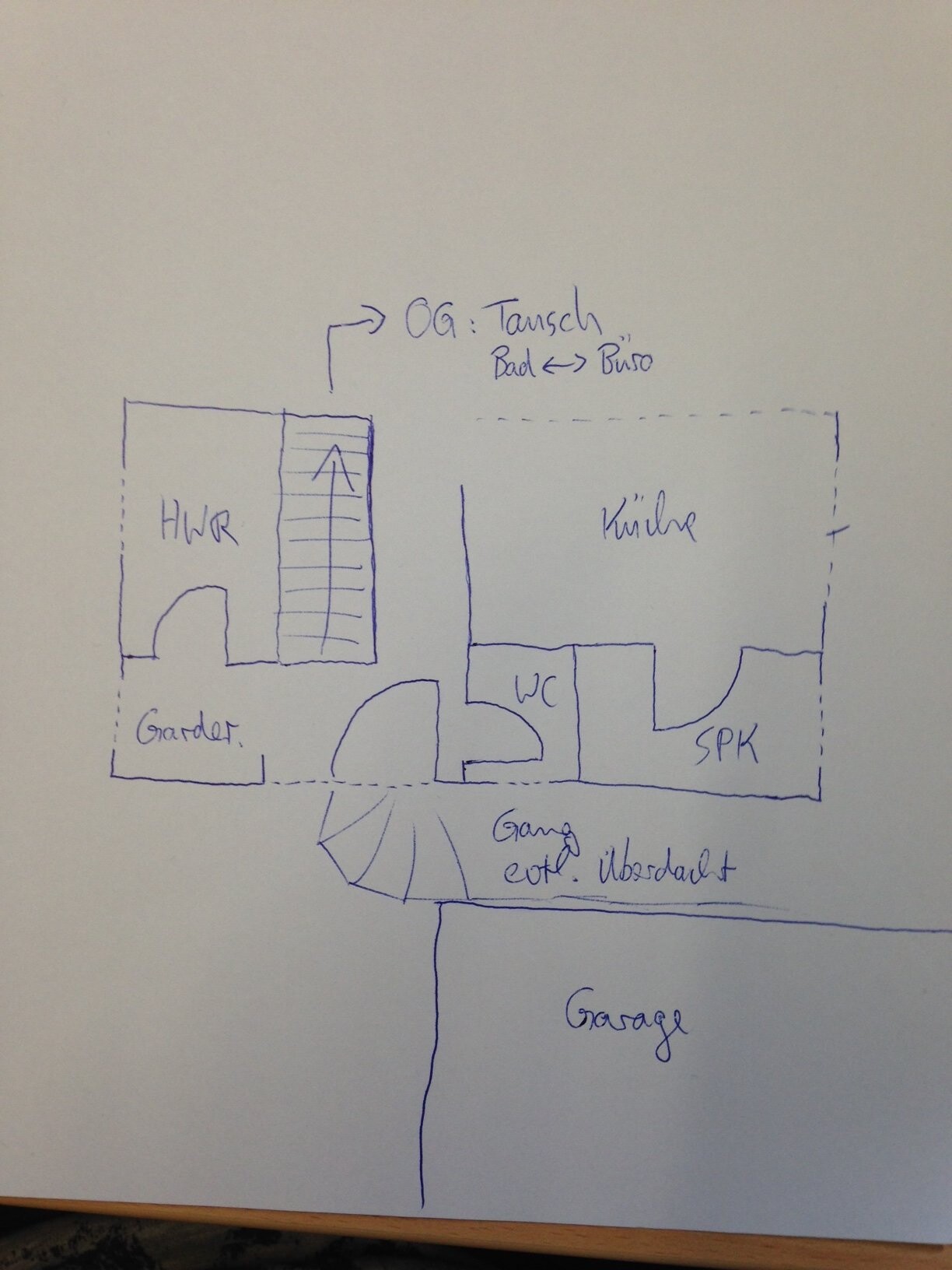

Hmm, I’m definitely better with words than with drawing. Just to roughly visualize how I would prefer it.
In addition, the windows in the living/dining area still need work, but that’s a different topic.
Overall, I compressed the design to the left of the entrance door and expanded it to the right because I think it will make furnishing easier later on, and I also like the wardrobe area better that way.
Everything has been said about the hallway to the garden: that should have priority over the carport. Just my personal opinion.

kaho6744 May 2018 09:47
Chand, I believe your suggestion was already understood but was rejected due to lack of space for the terrace.
Overall, very little has changed from the original design. The drawbacks of this straight staircase, such as the long narrow hallway, unused space underneath, long route to the kitchen when carrying shopping bags, maximum space wasted by the staircase, and resulting loss of living area, all remain. But apparently, none of these issues matter.
A compact square footprint and a straight staircase – an almost boring disaster. To me, it always feels like trying to push a square through a hole that’s too small. It will never fit because, in my opinion, they simply don’t belong together.
But everyone has their own priorities. The house won't fall apart because of this.
chand1986
4 May 2018 09:54
Well, if I had replaced the staircase with a quarter-turn stair at one end, it would have changed the entire floor plan in more ways than just stretching something here and compressing something there.
I don’t see how that would work for the client. So it’s better to try fixing things within the system rather than the system itself. Otherwise, you end up investing a lot and achieving nothing.
I think my idea is better than the one the original poster showed last. You can make space by shifting a few priorities. Of course, not by doing nothing.
Personally, I wouldn’t build like that. Staircases are often overrated. If you have plenty of space, that’s fine, but if not, you should consider it very carefully.
To be fair, I have seen much worse designs that original posters defended stubbornly at all costs.
