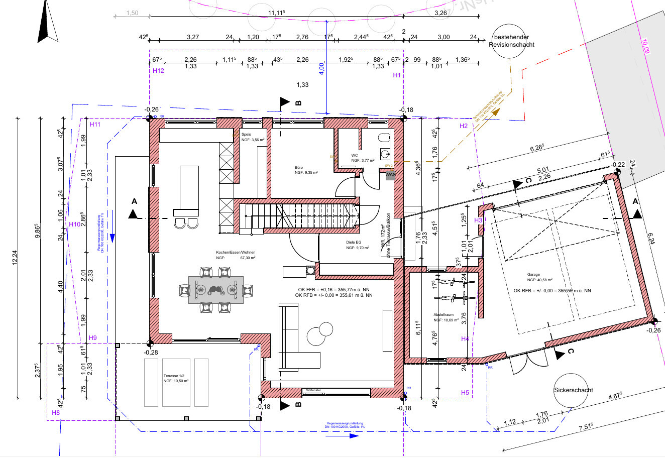

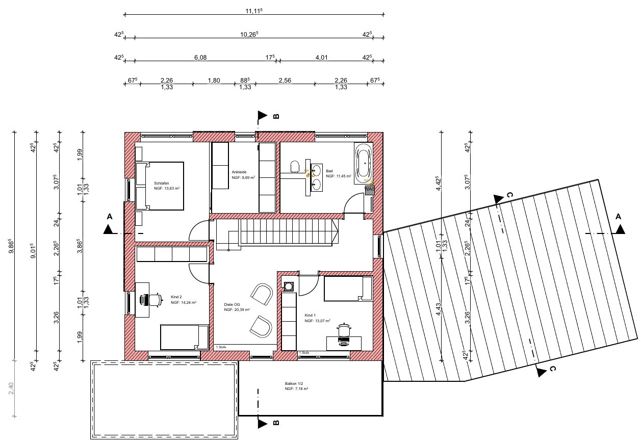

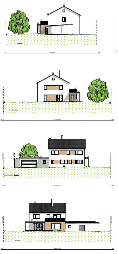

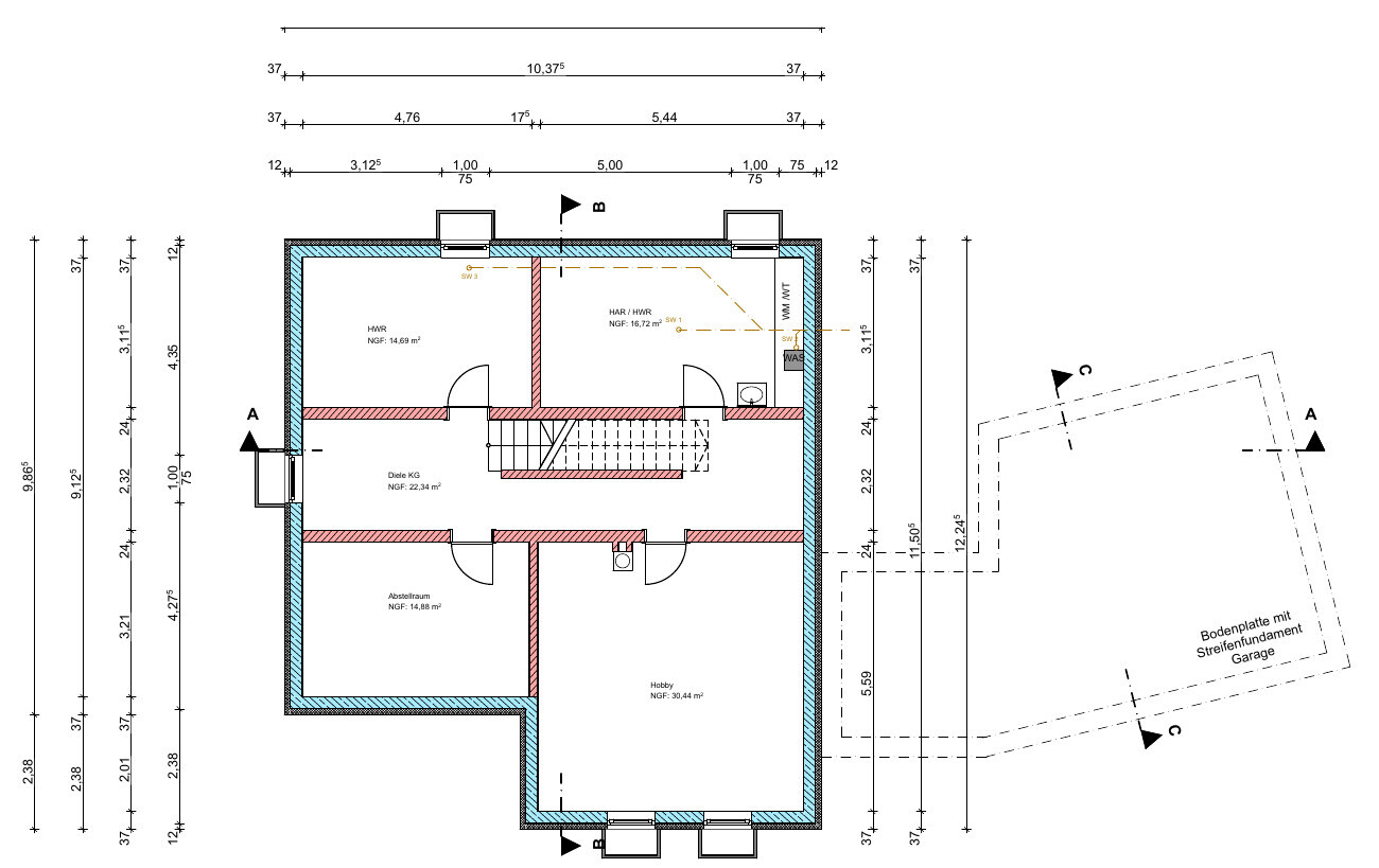

Some time has passed and we have made some updates.
There have been no changes to the house itself, as we are still satisfied with it. No fundamental issues arose during the course of the thread.
However, we have revised the garage layout as well as the positioning of the house and garage relative to each other.
This resolved a problem that ypg mentioned in the last post, which had also been bothering us for some time: the hallway between the house and the garage.
Although we initially decided to include this hallway during the planning phase, we increasingly doubted whether it would work as intended. It had to be removed.
This is the current layout.
We will probably submit the plan as it is.

11ant14 Mar 2023 00:15
Waldbewohner schrieb:
We will probably submit the plan as is.
In a free country, everyone is allowed to ignore advice, although it has all been provided. The arbitrary wall thickness specifications are a matter of personal preference since they don’t harm anyone – unfortunately, this does not apply to the pantry crawl space. I already admire the wizard who will manage to extract a functioning staircase from the confusing drawings. I see that my and many others’ comments and suggestions remain just as relevant today.
