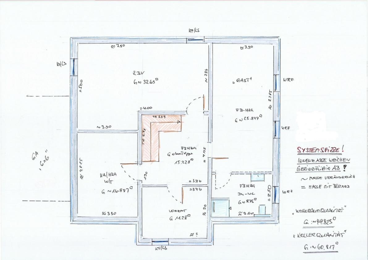

After reading along for a long time, here is my first post. I really appreciate how helpful this forum has been to future homeowners. Now to our plans, and I hope you can give us one or two tips or guidance.
Who wants to build and how?
Number of people: 2 adults + 1 child
Plot size: approx. 1200 sqm (22 m (72 feet) wide)
Building regulations / planning permission: yes (already taken into account in the planning)
House cost: approx. 440,000 €
What is important to us?
Lots of light, stove, gallery, stove, modern (timeless),
What are the technical requirements?
KfW 55 house, basement and wellness basement, later an accessory apartment,
Air-to-water heat pump, photovoltaics + battery storage, KNX system, prefabricated double garage (with storage room), central controlled ventilation system
What are the requirements for the floors?
Basement:
• Technical room (heating, electrical, server)
• Utility room
• Guest room
• Shower bathroom
• Sauna / fitness
Ground floor:
• Guest toilet
• Office
• Separate cloakroom
• Living / dining room (gallery)
• Stove door kitchen through sliding door
• Storage room
First floor:
• 2 separate sections (separated by the hallway or similar)
• Master bedroom
• Walk-in closet
• Bathroom with tub and shower
• Child’s bedroom
• Shower bathroom
• Playroom
• Storage room
Are there any special features?
The child’s area is to be converted into an accessory apartment later.
For the sake of KfW subsidies but also executed this way from the start.
I would appreciate your comments and suggestions for improvement.

Hello Matthias,
You are welcome to remove your last name from your profile as well; we prefer first names only 😉
For me, the priority is first an open and bright house.
I read this while on the go and was a bit disappointed when I saw the design, something like a townhouse, in front of me.
Exactly. A hidden entrance is already contradictory to the idea of openness.
Basically, you want to keep all options open and haven’t noticed that you designed a house where one part will never be used by you.
I fully agree with @MarcWen in #24.
Your son won’t use the playroom in the back corner anyway – he’s more likely to play on the gallery or in the living room, in that 3.30-meter (11 feet) corner.
Later, you’ll have strangers living above you.
Just take some time to think about that.
Well, actually the space above just serves as a passage and room distributor. Besides, the layout looks somewhat old-fashioned – like a country house, which often has a similar stair design... now you plan to have the west side of the hallway as a glass wall: then I wonder how you’d sit comfortably in the living room.
TV in the south, seating area partly under the open space, next to it you see the stairs behind a glass wall... cozy is something else. Open, modern... there’s nothing open about that, I see more compartmentalization and a south side where the cloakroom, toilet, and a small living room window cluster. In winter the sun doesn’t set exactly in the west. That area will be more dark than bright. And then there’s the garage adjacent.
The dining area in front of the kitchen is rather small relative to the rest. Basically, I find the dimensions of 350/330 centimeters (11.5/11 feet) borderline: a sofa in the corner (if planned) feels cramped in the niche, and a kitchen unit of this length is more like an apartment kitchen. Also, the kitchen door hits the fridge door or the oven.
Upstairs the hallway or gallery is so convoluted that you can hardly put a sofa there.
Then the chimney must be planned to go through the upper floor as well.
Shouldn’t the idea be to first achieve light and openness without a gallery, then add the open space above as an extra?
I would try to place more windows facing south. If the neighbor is too close, then plan an L-shape with the main window directions facing south and west. Then a staircase that is open but also offers privacy for teenagers from parental views.
And I would definitely not put the garage on the south side, but exactly on the opposite side.
The children’s room deserves more sun, an in-law unit should have its own exit as well as a basement storage room.
Edit: an in-law unit also requires a parking space; the son probably doesn’t need one at first 😉

Sorry, I need to say this again:
A house with 230 sq m (2,474 sq ft) of living space, but all the rooms are under 13 sq m (140 sq ft). Although the living area is generously sized, the kitchen/dining and the living room are divided and only 330 cm (11 ft) wide.
Only the basement has large rooms, as well as the extra space on the upper floor, which is questionable in terms of personal use.
Lots of criticism, but better now than paying 400,000 and losing 150,000 because of it.

toxicmolotof28 Jul 2016 23:10At least 50 sqm (540 sq ft) is dedicated to circulation space—others actually live there—what you are wasting on hallways and passageways...
Honestly, much more could be done with the house. I can’t imagine this was designed by an independent architect. It looks more like a Model Erika house with a few extras...
