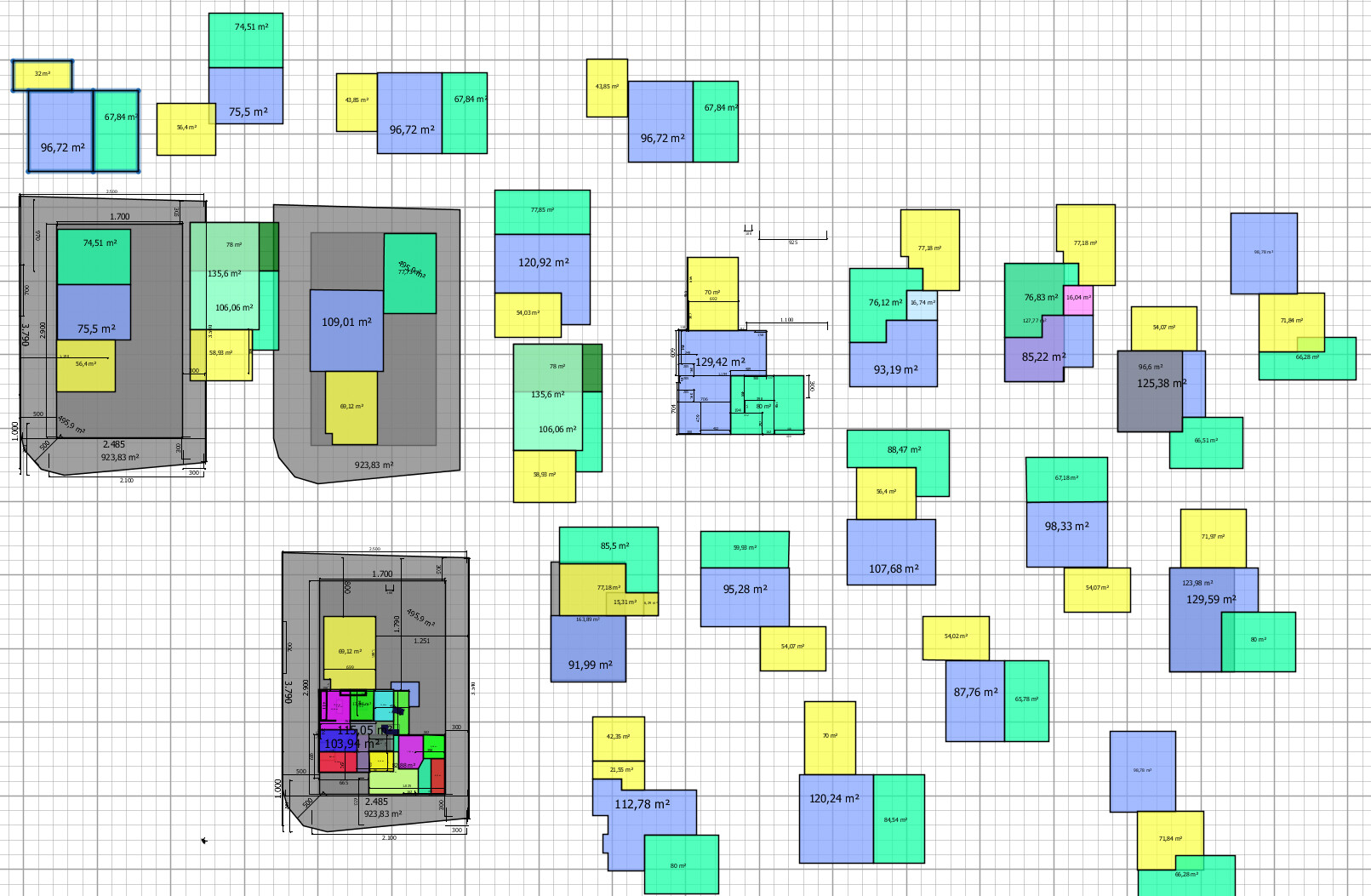

schustrik22 Apr 2017 23:36You are all right in many ways; most things developed naturally.
I have already considered many layouts and drawn them, as you can see in the photo below.
Yellow: Garage
Blue: Single-family house
Turquoise: Granny flat
However, I am still not 100% satisfied with any of the layouts because several factors must be taken into account.
- Driveway only from the west side.
- Garage and granny flat should be attached to the house.
- Sunny side
- The main house should preferably face the sunny side to the south, southeast, or southwest.
- The single-family house is intended to be a townhouse-style villa; if the granny flat is on the side, the upper floor of the single-family house would also need to be built over it.
Yellow: Garage
- Sunny side
The toilet behind the garage is mainly for summer use, so you don’t have to walk through the whole house dirty to shower. The sauna will be heated as needed, so it will be warm there. Where else should it be located? It should be on the ground floor.
“Is there a reason why the house is angled away from the southwest ‘cream spot’ (aside from the street, which should only be a residential street)?”
Do you mean why the house isn’t positioned facing southwest? It could be; there is no particular reason.
No, why is the house facing away from the southwest side?
South-facing windows are important! Orientation matters.
