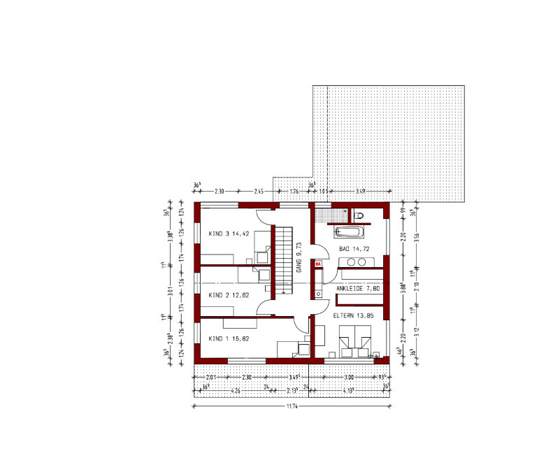

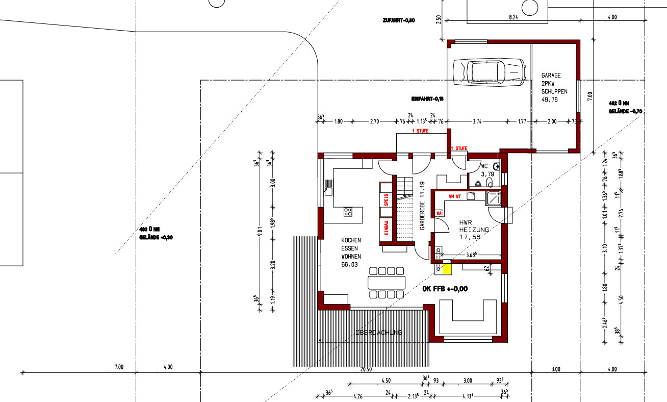

Here is our floor plan.
Our main requests are:
- straight staircase
- 3 children’s bedrooms
- no basement
- open living area plus kitchen
- direct access from the master bedroom to the bathroom
What do you think of this plan?
One more question:
Would it make sense, or do you have any ideas, to use the flat roof of the garage as a potential extension? Maybe creating direct access from the upper floor to the flat roof, so it could eventually be raised with a pitched roof (there is enough distance from the neighboring property). Is this possible, and what do you think it would cost to use this space as a hobby room and office? I am currently missing spaces like that in the plan.
Thank you.

. . And presumably this is an urban villa with a hip roof, which also lacks any storage space for suitcases and similar items?!

Is north at the top?

markus.stetter schrieb:Then it is probably not the right house if at least one of these rooms is needed.
Hobby room + office
