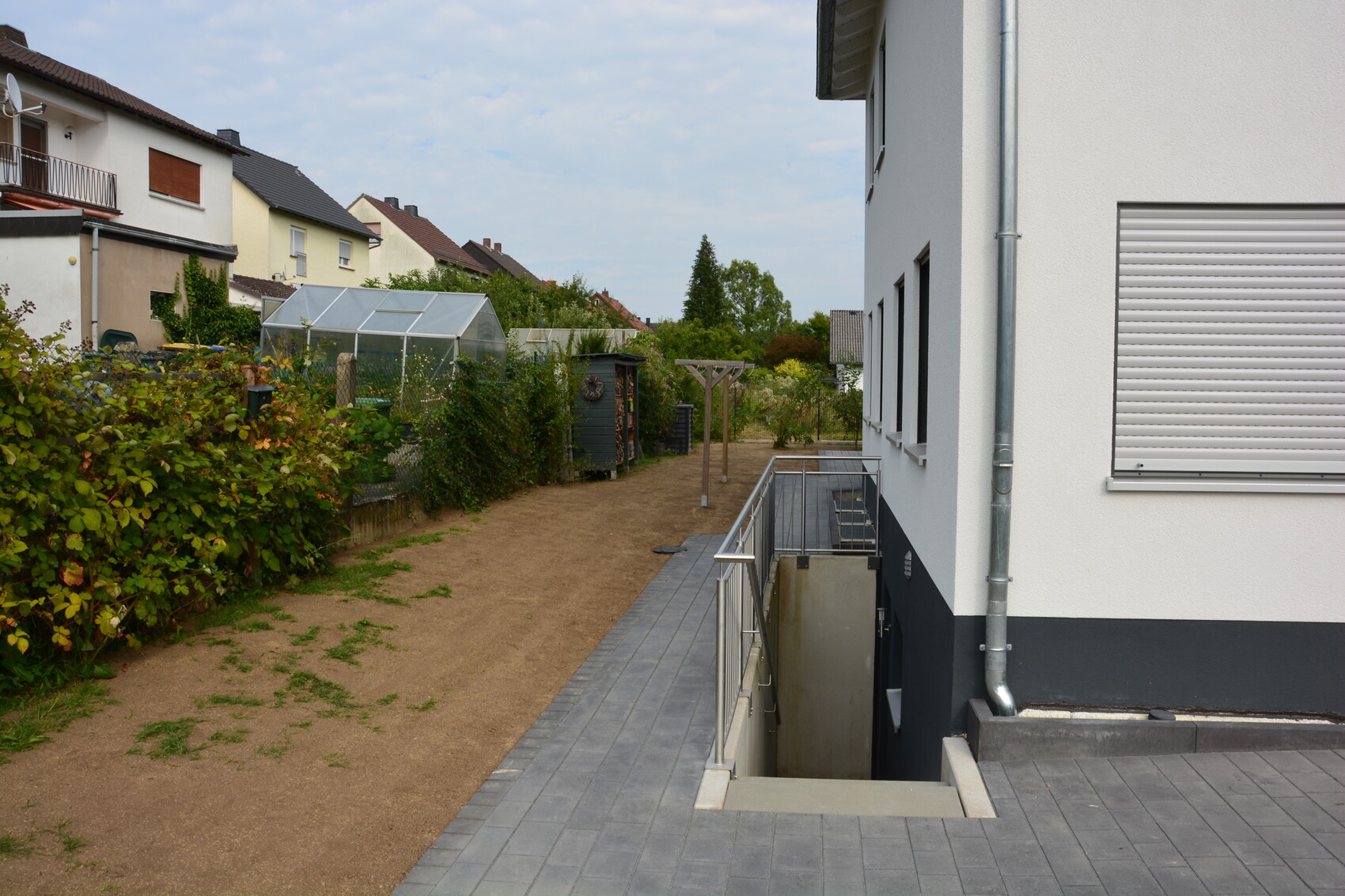

That was the intention. When coming in from outside, potentially dirty or carrying tires, greasy bicycles, or any kind of wood material, you should be able to access the basement without passing through the living area.That’s exactly why you build an exterior basement staircase... 😉 AxelH. schrieb:
For something like this, you build an exterior basement staircase ... 😉
It’s an option, but not a necessity. A lot of money for a potential moisture problem.ypg schrieb:
You can do it, but it’s not necessary. A lot of money for a potential moisture problem. But it’s a huge convenience for dog owners. In bad weather, you enter the house through the basement. The dog towel is on the workbench next to the basement door. The dog stops just inside the door, has its paws wiped, and then continues into the house. The owner is happy too … 😉
AxelH. schrieb:
That also makes the lady happy ... 😉That might reflect your personal situation, but it probably won’t help here, because the original poster has chosen a different option that seems much more suitable as a living space than entering through the basement.ypg schrieb:
That may reflect your personal situation, but it probably doesn’t help here because the original poster has chosen a different option that seems much more livable than an entrance through the basement.Sorry, but we still have a livable entrance as well.And of course, you can also access the basement from there. The advantage of an external staircase is simply that not everything that belongs in the basement has to go through the living area. That is something worth considering during the planning phase of a new build.
