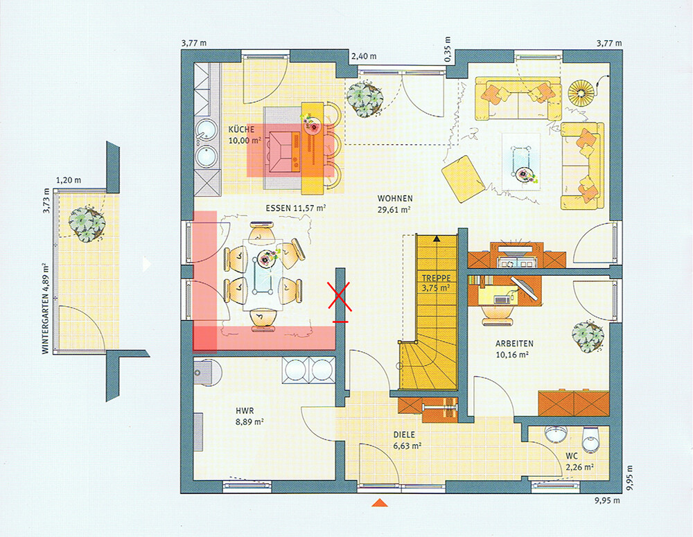

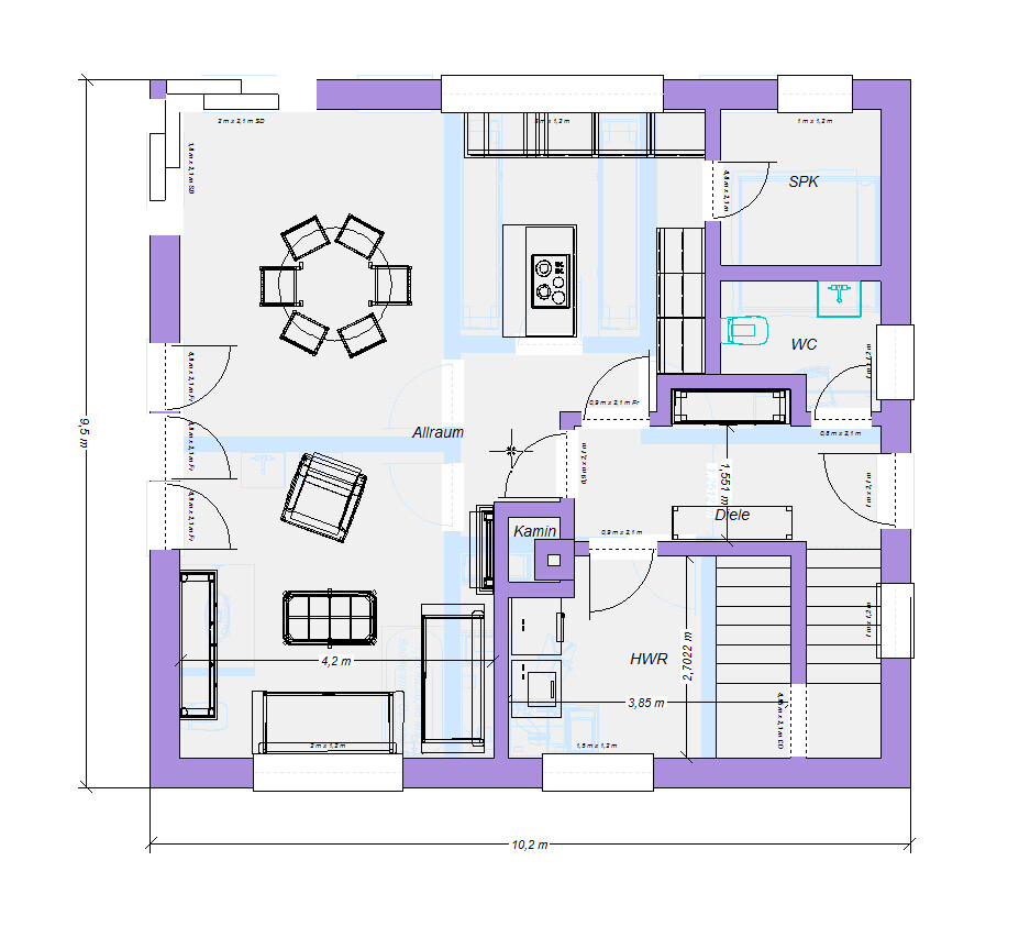

we are almost finished with our planning phase. That’s why we would like to hear your opinion on the floor plan of the house. I have been enthusiastically reading this forum for months now. I especially appreciate the helpfulness and the respectful tone here. However, this does not mean you shouldn’t give criticism. We are grateful for any comments or ideas for improvement.
A small issue is the orientation of the plot. Our main facade faces southwest, but once the house is built, there will be only about 6 meters (20 feet) to the neighboring property (depending on where the double garage is placed). The main garden is also oriented to the northwest. We planned the terrace in an L-shape from southwest to northwest. We will probably spend more time on the northwest terrace (which is why there is a sliding door leading outside there). If the main facade (living/dining area) were oriented northwest, I think the living room might become too dark (north-facing). But I’m open to being corrected if that is not the case.

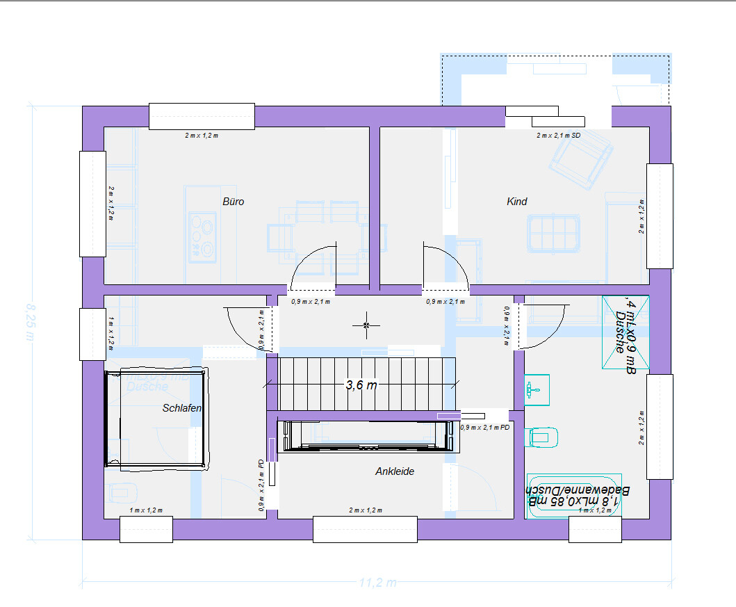

Initially, there was an office planned on the ground floor. But that would have made the kitchen too small. We have now planned the office on the upper floor, which is fine for us. The bathroom is located on the north side but has a good size (should be sufficient). At first, we wanted a T-shaped layout (probably because it is often seen in model homes and we liked it there). However, I think an L-shaped layout might be better here. In front of the toilet, there is a planned privacy wall about 1 meter high (3 feet).
I have marked the floor plans with compass directions and measurements. The house measures about 10 x 10 meters (33 x 33 feet) externally (this does not have to remain that way). I also sent furnished versions of the floor plans. The plot is included as well, but without a building envelope shown (full width and about 20 meters (66 feet) deep from the street). The attached exterior views match the floor plan, except the street view on the ground floor has changed slightly (kitchen and pantry windows are different from the exterior view). Additionally, in the floor plan, the sliding door in the living room has been shifted slightly inward to avoid the couch blocking access to the terrace.
For the exterior views, the street is unfortunately shown on the wrong side (now southeast as per the floor plan). We had originally planned for a different plot, but there were some issues (slope, etc.). We were able to acquire this plot at short notice. The garage is also shown rotated and does not necessarily have to have a separation from the house.
I’m sure I have forgotten some things but I will try to answer your replies as quickly as possible. We are looking forward to your opinions/criticism.

Zisu2000 schrieb:
@kaho674
As you have drawn it, it is correct. Not mirrored again? In my opinion, that would make more sense:
Please ignore the small red letters! Confusion now at about 300% zoom.
You’re probably thinking of having breakfast with the morning sun, right?
How long and at what times do you usually spend in the kitchen? For me, it’s only a fraction of the time in the morning compared to the evening... of course, natural light is important in the kitchen, but a west-facing orientation also has its appeal.
A pantry with those dimensions and two doors plus a window will hardly have any practical space left for storage. Try realistically drafting a layout and don’t forget that plaster or drywall will take up about 4–5 cm (1.5–2 inches) as well.
@Maria16
Yes, that’s exactly what I had in mind. However, the west-facing orientation is correct. Maybe I’m overthinking the sunlight issue. I was just concerned that there might be little sun in the kitchen, especially during winter. If that’s not the case, mirroring the layout could definitely make sense.
We can definitely make the pantry larger. For now, we have planned the kitchen to be a bit bigger than necessary anyway.

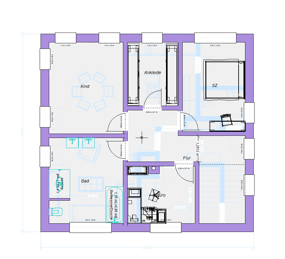

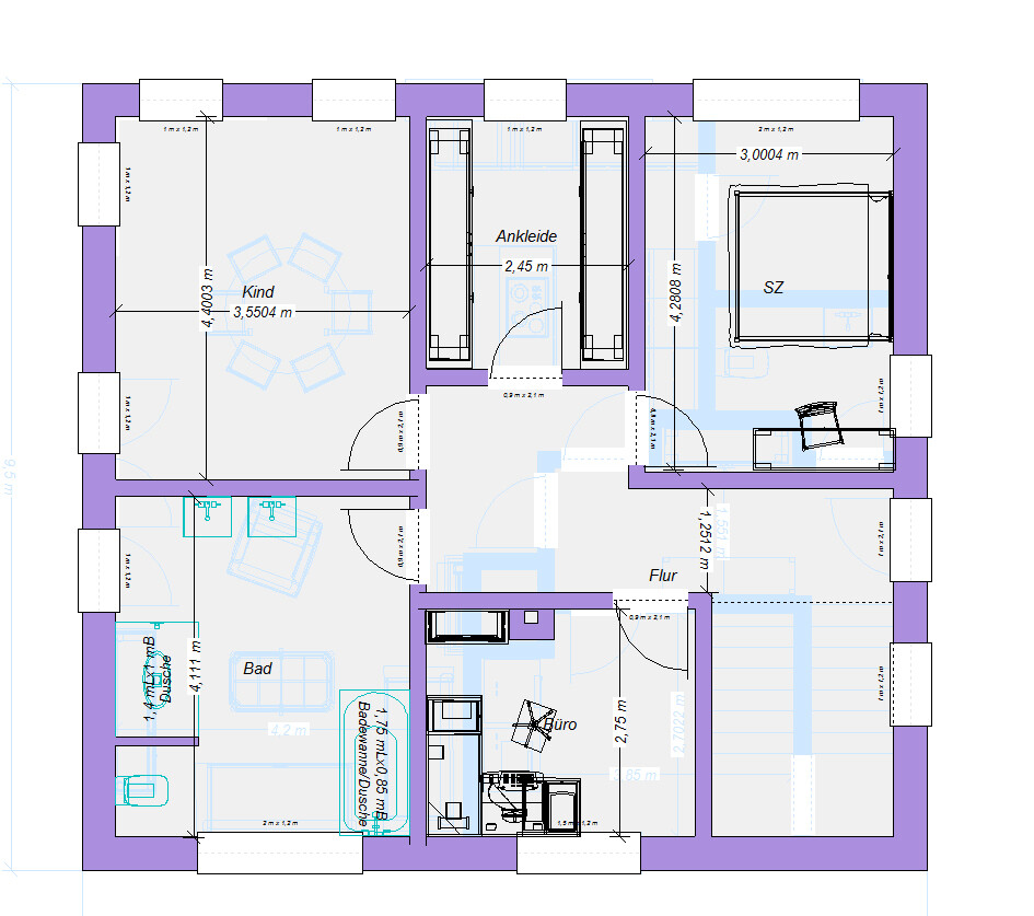

@all
Thanks for your previous answers and opinions. There have been some really good points to consider.
@all

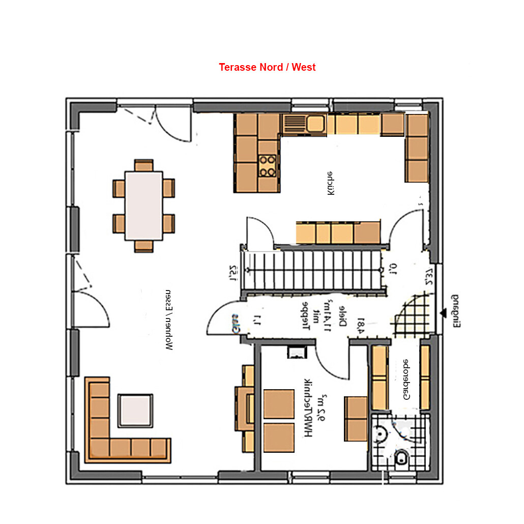

I would mirror the ground floor and first floor as previously mentioned, so the kitchen faces the garden. That’s also where I would place the terrace – even though it’s northwest-facing. Having it right next to the neighbor feels too close for me, but that’s a matter of personal preference.
In addition, I would move the pantry under the stairs and add a door near the entrance for quick access to the kitchen. Since the kitchen will be larger, there will be enough space for big storage cabinets, perfect for stacking lots of jam jars.
@kaho674 ... exactly, if the terrace is northwest-facing, then the kitchen/dining area should be located there as well. Usually, people don’t go out onto the terrace just to sit comfortably on the sofa, but rather when they want to take food or drinks outside for grilling or enjoying themselves.
