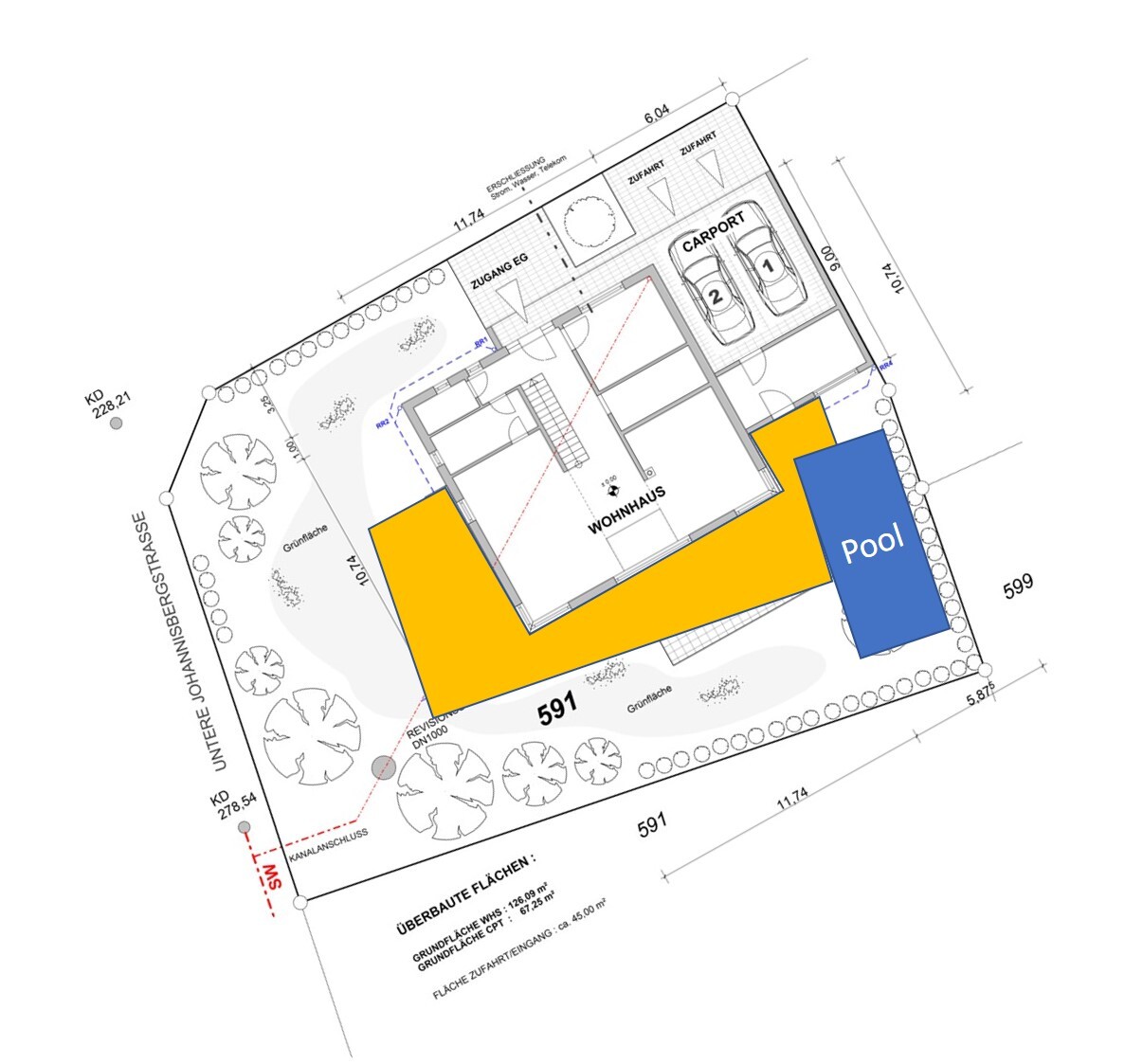

my name is Alex and after quietly following the discussions for some time, I have finally decided to register here. Since my single-family house is already in the shell phase and we plan to move in on April 1, 2020, we are currently thinking about a practical and stylish design for the outdoor area...
our main concern is the positioning of the terrace, which should face more towards the main garden instead of the direction shown in the plan.
The next question is how large the terrace should be. There should also be enough space later for a pool.
Since the house already has clear, simple lines, I want the garden design to be a bit more daring. That means that more playful shapes and softer forms could be integrated here. So far, we have not been satisfied with the proposals from the local landscape designers.
I would really appreciate your tips and suggestions.

hampshire10 Mar 2020 18:03Is the plot completely flat? Where are the neighboring buildings located? Is there a view in any direction?

I tried to roughly position your plot.
The house seems to be rather modern (corner windows), so I wouldn’t choose overly ornate shapes for the terrace.
One idea (see sketch) would be to use the property boundaries as a reference for the terrace orientation.
This results in a southeast-facing terrace and a southwest-facing terrace.
Also keep in mind that a pool requires equipment and at least electricity. Having space for pool cleaning supplies nearby is also practical, so I would place the pool close to your storage room.
