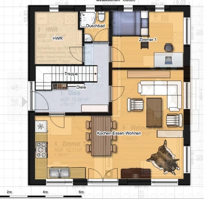

Regarding the staircase again: We received a message from the architect’s office stating that there is not enough space to continue the standard staircase into the attic because there is insufficient headroom at the staircase landing. That was exactly what I had noticed as well. Am I correct in understanding that this could only work with a completely different staircase design? And what might that look like?
Ok, we have been working hard on the room layouts, taking into account our existing or planned furniture and the intended use of the rooms.
First, we tried to make the kitchen-dining-living area a bit larger in the original layout (kitchen on the east side) by taking some space from the hallway, utility room, and guest bathroom.
We removed the gable and kitchen counter and moved a few doors so that the different areas (kitchen-dining-living) can be more flexible and flow into each other. There is a floor play area planned around the cowhide rug.
Then we tested ypgs’ version with the kitchen on the west side, but kept the glass corner for the floor play area.
In both versions, you can still see the original architect’s design faintly for comparison. You can find the complete images here.
Regarding our dining table, I should mention that it will usually be a smaller size in everyday use and is shown with an extension leaf in the plans. Windows in the rest of the house and some other details are still missing or not completely accurate yet, so please excuse that...
Now, here are some numbers for the room sizes, and I would really appreciate your feedback: Which version do you prefer? To what extent does it improve the aspects we had concerns about before? Are there any features of our changes that you think might not work at all?
Room dimensions West kitchen
Utility room 7.5 m² (plus possibly space under the stairs)
Shower bathroom 2.5 m²
Room 1 12.4 m²
Hallway 9.3 m² (plus possibly space under the stairs)
Kitchen-dining-living area 39.4 m²
For the east kitchen version, the dimensions are almost identical, except the east hallway is probably too narrow (1.10 m (3 ft 7 in)), but the utility room is a bit larger (7.9 m² plus possibly under the stairs).
Finally, the architects suggested the following options to widen the living space (based on their original design, not on our rearrangements). What do you think about these?
There are several options to widen the living area:
1. The staircase can be shortened, which would allow the wall between the hallway and living room to be moved further toward the hallway. However, a shorter staircase reduces the ceiling height on the ground floor.
2. The house can be made slightly wider overall, but then it would need to be shortened in the other direction to avoid exceeding the total living area too much. This would come at the expense of Room 1. The wall between Room 1 and the living area can also be moved toward the living area, depending on how deep the niche for the closet and fireplace in the living room should be.
As always, many thanks for your effort and suggestions

Good morning, does anyone still have time and interest to comment on the floor plan changes from the previous post? I would really appreciate your feedback!
Regarding the staircase, I think I have understood it now... if we want to extend the main staircase all the way up to the attic, we would need a half-turn staircase roughly in the center of the house, right? Or are there other solutions?
Thank you very much
Thank you very much
I am missing the final measurements (widths and lengths of the rooms) to complete the item.
You already know my arguments regarding the west kitchen. I also don’t like the kitchen furniture in the east kitchen (long, narrow layout).
Tentatively (due to missing measurements), I would plan the downstairs bathroom as a rectangle to accommodate a standard washbasin, which means straightening the wall at the shower. Possibly consider moving the door wall further "up" so that you can shift the door to room 1 enough to create a deeper wall section behind the door.
Place the coat closet inside the enclosed staircase area, and move the kitchen door slightly. Maybe move and widen it enough so that you can eliminate the living room door (creating more space for furniture). The table can be turned and centered—there’s enough space.
Relocate the washer and dryer into a niche with doors opening into the bathroom (I don’t have your attic floor plan in mind right now).
I won’t comment on the staircase, as I am not an expert. The logic of the staircase is straightforward: it must be positioned so that you have at least 2 meters (6 ft 7 in) of ceiling height under the roof slope upstairs. However, the actual design is a bit more complicated...
