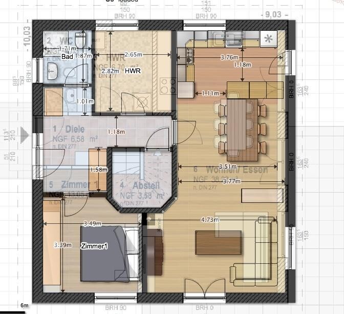

We have further developed the latest design and before we have the architect put the finishing touches on it, we would appreciate more feedback from you on the images and the following questions:
From our point of view, the ground floor is now better because the hallway area is more usable and the utility room is larger – OK?
We designed the kitchen with an additional section, so hopefully it will now be sufficient for all five of us – OK?
As you might notice in the ground floor image, we have widened the house by 25cm (10 inches). More would probably not be feasible price-wise. What do you think – is it dispensable (the "old" exterior wall is still faintly visible for comparison), a good idea, or pointless because it hardly makes a difference?
I’m not yet completely happy with the closed staircase enclosure in the center of the house; we were also told that an open wooden staircase might save us about 1500 euros per floor. We are now considering foregoing the storage room and instead using the space under the stairs as open storage with some nice built-in furniture. However, I might keep the coat wall directly opposite the front door. Another option would be concrete at the bottom and wood above, leading into the attic, but I am not quite sure the transition would look appealing. What are your thoughts on these options?

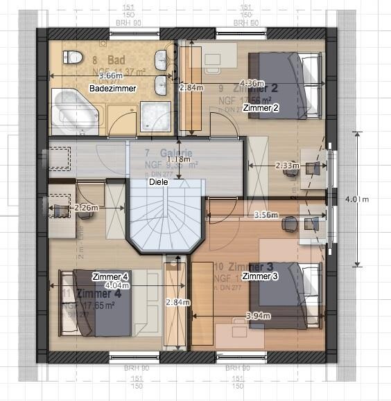

On the upper floor, at the expense of the previous "entrance corridor" to room 4, we created more hallway space to allow natural light in and to have room underneath for a shared chest of drawers. How do you like this?
In room 4, I would also add a skylight to make the entrance corner a usable workspace or dressing area separated from the main room by a room divider. Does that sound good?
In rooms 2 and 3, additional windows on the south side should also enable a similar room division or improve lighting. Here, we are still undecided between a large dormer in the middle (like the one in the Flair 134 from Town & Country) and skylights. The architect advised against skylights because they can overheat the rooms, but I have since heard that external blinds can manage this well while saving a lot of money compared to the dormer. In terms of space gain, I don’t really need dormers in the rooms, so if there’s nothing else speaking against skylights, we could allow ourselves the dormer mainly for aesthetic reasons. However, I am increasingly warming up to a look without dormers, so I wonder if the money for dormers might be better spent elsewhere. What do you think?
Otherwise, we want to increase the roof pitch from 45 to 48 degrees to gain more space in the attic. Does that make sense?
Any other suggestions on different aspects are, of course, very welcome.

Regarding the latest floor plan:
Overall, there are only a few rooms not negatively affected by the central staircase.
Ground floor:
The hallway is convoluted, and you walk straight into the wardrobe area—lots of space, little practical use, poor impression.
The guest room offers maybe 70cm (28 inches) of clearance between bed and closet. Acceptable for occasional guests, but it could be better.
The kitchen and dining area are awkwardly intertwined with no clear zoning.
The living area seems carelessly squeezed in; the residents must also decide whether to watch the home theater with a tilted neck or look into the living room. Outside there appears to be something very unpleasant that you are better off not seeing.
Upper floor:
Which room is supposed to be the master bedroom?
Room 4 can’t be it—around a 2-meter (6 ft 7 in) wide bed leaves only about 40cm (16 inches) clearance between stairs and wall, which is unsafe.
Room 2 is also not suitable, for the same reasons as above; the sloping roof worsens the situation, or is the wardrobe still from the previous plan?
That leaves room 3—an experienced designer could probably make something of it, but unfortunately, you don’t have one, which is a pity.
I would like to hear how the house seller sugarcoats these flaws; hopefully, they are at least good at that.
In the end, they can at least say: But you planned it this way yourselves, so what was I supposed to do?

Wanderdüne schrieb:
Even if you don’t want to hear it now, you’re at a dead end.I appreciate all feedback, even if it’s a bit sharp.
The hallway is complicated, and you walk straight toward the wardrobe, lots of space but little use, poor effect.The front door can be easily slid upwards, so you don’t walk directly toward the wardrobe but into the entrance hall. I thought having the opening toward the wardrobe might be good for dropping things off at first, but I’m happy to be convinced otherwise. Are there more opinions on this?
The guest room offers maybe 70 cm (28 inches) of passage width between bed and closet. Acceptable for occasional guests, but it could be better.I assume you mean room 1? It’s true it is a bit tight there but still acceptable, in my opinion. What exactly would you suggest to improve it? That would only be possible at the expense of the already rather small living area, right?
The kitchen and dining area are awkwardly intertwined without clear zoning.Could you explain more precisely what is problematic about that? It seemed like an advantage to me to have the dining table connected directly to the open kitchen for everyday use. The table will probably be shorter as well. For larger gatherings, we can easily move the table farther away from the kitchen or rotate it 90 degrees. Is this all a wrong approach, and if so, why? How could we improve it?
The living area was also crammed in without care; residents must choose whether to experience home cinema with a tilted neck or look into the living room. Outside there is something really ugly, so you shouldn’t look that way at all.The selection and arrangement of seating furniture is still completely open; we need to replace it anyway. I just want to definitely place the large cabinet in that area, as I believe it would make other rooms too cramped, right? What would help more is an assessment of whether the living corner, roughly from the room divider shelving unit (which could be pushed up a bit), can work overall in terms of shape and size.
Upper floor:
Which room is the master bedroom?
Not room 4; with a 2-meter (79 inch) wide bed, the clearance between stairs and wall would be 40 cm (16 inches), so no.
Not room 2 either, for the same reason, and the sloped ceiling makes it more difficult, unless the wardrobe is from the initial planning.The white wardrobes in the image are from the rough initial plan but may be roughly necessary if a wardrobe longer than 3 meters (10 feet) is needed (see my previous post). For our own use, any of the rooms would work for sleeping.
That leaves room 3; a skilled planner might be able to create something out of it.What are your ideas on how to improve it?
@ Building expert: Your comment about the constraints within which the design must work is exactly how I feel. Of course, with 20+ square meters (215+ sq feet) more, I could design something much better, but financially that’s just not an option. As I mentioned in my second-to-last post, only an additional 25 cm (10 inches) of width and/or a dormer are feasible.
Therefore, I would really appreciate if further improvement suggestions take this framework into account and are constructive enough that, with some effort and determination, we can make progress. In particular, I am very grateful for answers to my specific questions in the last two posts, as those are the areas where we still feel the most uncertain.
Many thanks,
