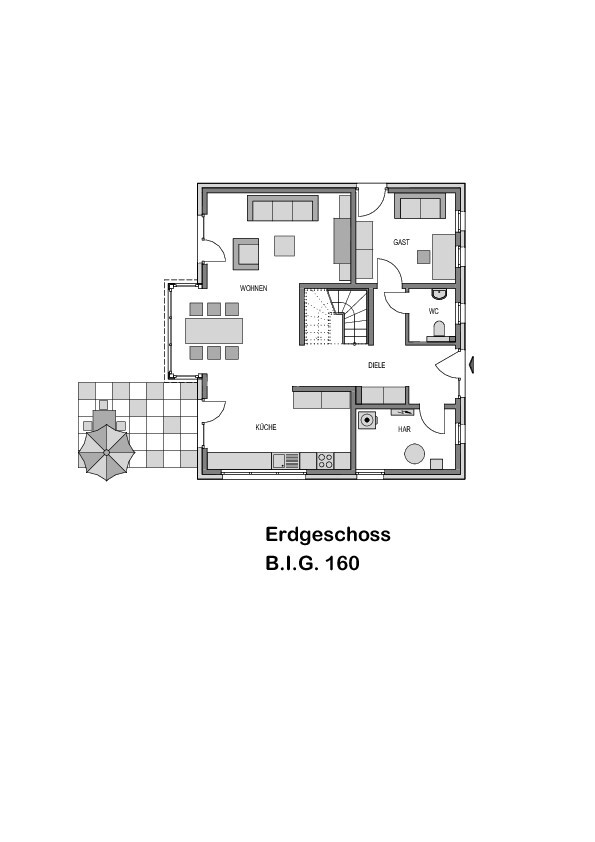

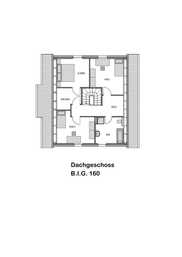

Bauexperte24 Jan 2014 15:34Hello,
regardless of our "conversation" via private message, I searched online and found an alternative for a centrally located staircase. This floor plan could work for you as well, with slight modifications to the entrance area. In terms of dimensions, it should fit, except perhaps for the bay window; the staircase or access would also have enough space in the attic. Let’s not bother the provider for now.
Regards, Bauexperte
Regards, Bauexperte
P.S.: By the way, I don’t understand why the architect offered you the floor plan with the open staircase, especially considering you have three small children...
