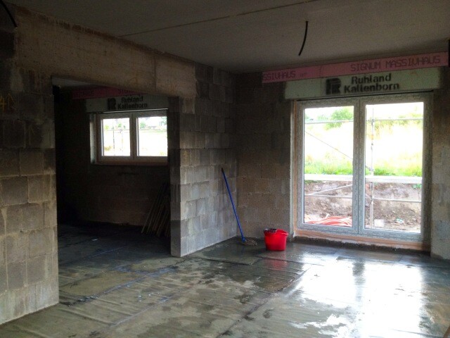

Bauexperte14 Jan 2015 10:26Hello,
A pocket door typically requires about 10cm (4 inches), so the remaining wall thickness would be quite thin. In addition, such a modified load-bearing wall might have lost its structural function. Was a beam or lintel planned?
Regards, Bauexperte
Masipulami schrieb:I can hardly believe that...
In our case, the element is installed in a 17.5cm (7 inches) thick load-bearing interior wall. There is no doubling up.
Regards, Bauexperte
The load-bearing wall was specifically designed for this purpose. The bricks used for the entire wall are specially heavier bricks. A suitable lintel was poured above the 2m (6 feet 7 inches) wall opening.
Of course, all of this was discussed with the structural engineer and has been implemented by the general contractor several times before.
There is no "leftover masonry" in the opening. The entire wall was built with these heavier/more stable bricks and includes a 2m (6 feet 7 inches) wide wall opening. The sliding element is installed in this opening, and the section where the door recesses is covered with drywall, then wallpapered, etc.
Bauexperte14 Jan 2015 10:43Hello,
Then this is indeed a variation described by Doc. In your building project, the builder simply installs a drywall partition in front of it; this means the wall is doubled up at this point (whether masonry or drywall is irrelevant). This also works fine with the required brick and lintel... I was already a bit alarmed.
This shows once again how important clear and detailed information is. If I had known the construction details before responding, I would have saved myself the typing
Edit: Are you building with lightweight concrete blocks?
Regards, Bauexperte
Masipulami schrieb:
There is no "remaining masonry" in the opening. The entire wall was built with "heavier"/"stronger" bricks, featuring a 2m (6.6 ft) wide wall opening. The sliding element is installed in this opening, and the section where the door slides into is then covered with drywall, followed by wallpapering, etc.
Regards, Bauexperte
No, the drywall cladding ends flush with the wall on the left. So, including the drywall cladding, the system fits into the wall opening.
