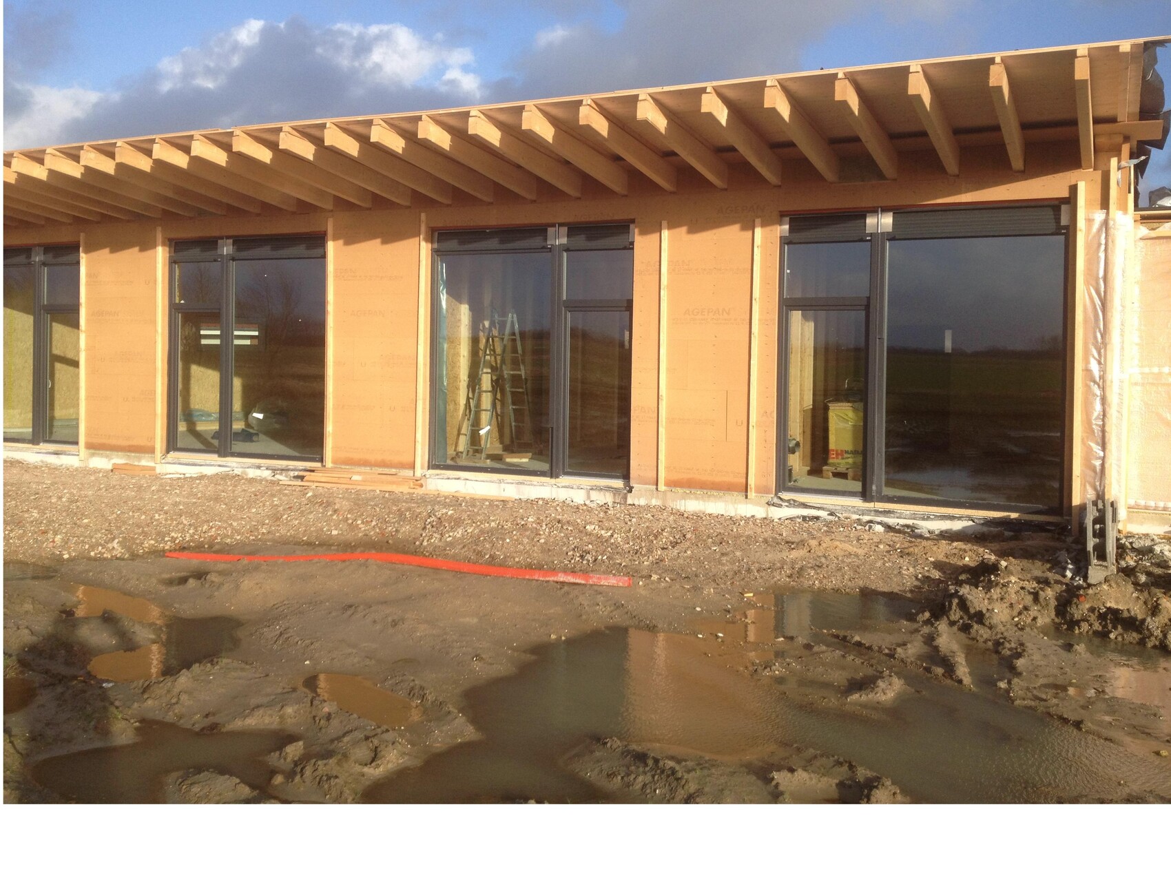

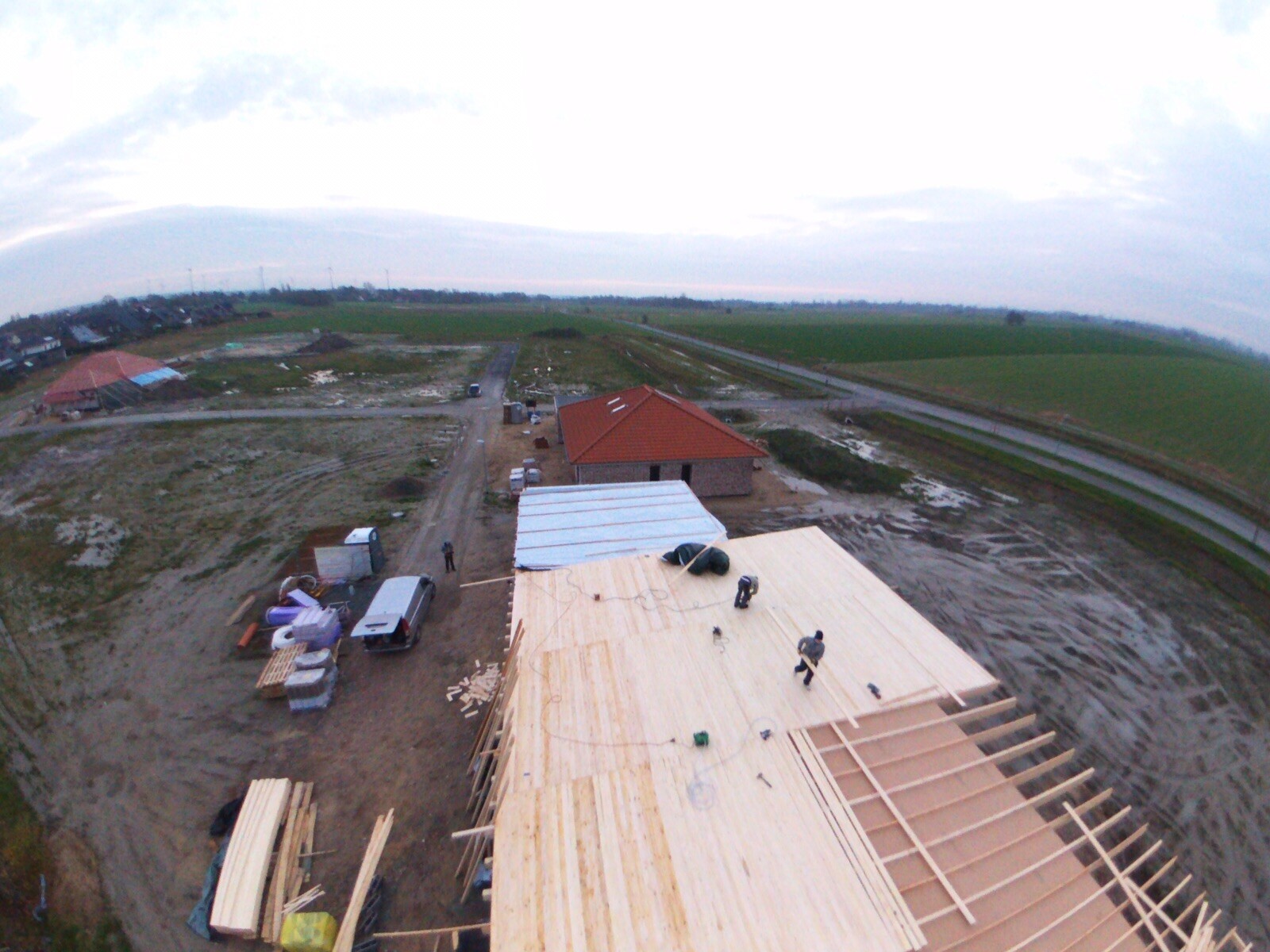

Hello again,
a few details about the photos:
In the fun photo, the roof surface looks even larger, but it’s actually just under 325 m² (3500 sq ft) of shuttering wood on the roof.
The exterior and interior shots were taken around midday on December 23, so during the winter solstice.
You can clearly see that all the sunlight possible at this orientation enters the house. It’s less obvious that the rafters decrease in thickness from the house wall to the edge to avoid making the roof overhang look too bulky when it’s clad.
The view is great, but the visibility into the house is also quite high. I’ll have to come up with a solution for that.
I’m not a fan of planting out the garden too densely. Does anyone have experience with slightly reflective films? Other ideas?

@ Olli
Were you the one who shared your experience with the "community greenhouse" in the Green Forum?
A few looks shouldn’t bother you there.
The mirror films seem to only work during the day. At night, you can probably still see through them, but you likely have roller shutters or external blinds for that.
Here in our residential area, some people have south-facing houses with three large terrace windows facing the street. However, they keep them covered with opaque pleated blinds featuring a floral pattern for most of the day. I always wonder why they invested so much money, only to block their view and light all day with such unattractive coverings.

Hello
Yes, I now live in the glass house. We are five units here on about 8000 m² (86000 sq ft) of private land right in the middle of the village.
The new building faces a quiet lane on the garden side. This is clearly visible on the aerial photo.
Roller shutters are installed for the evening and nighttime. For the reasons mentioned, pleated blinds are also not an option for us. I will keep an eye on the film solution.
