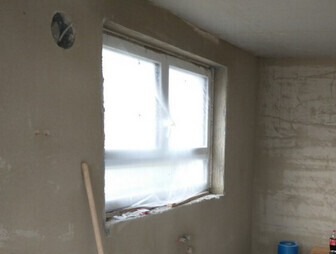

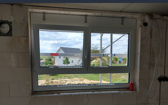

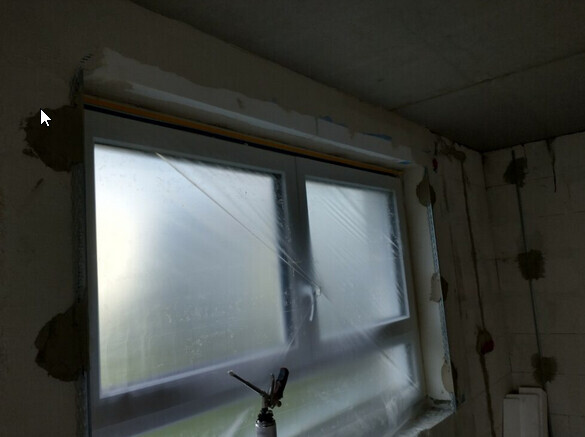

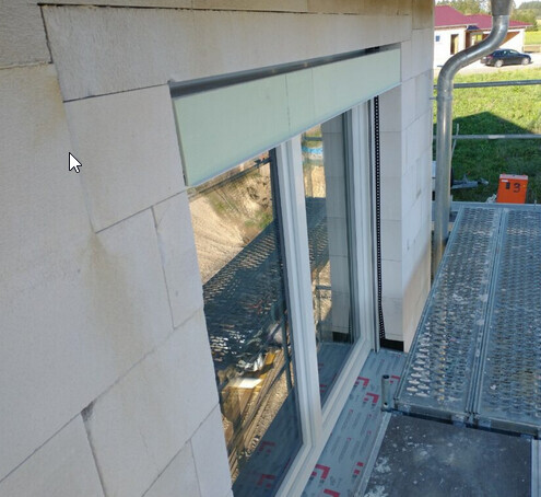

Here, for example, at the kitchen window. Unfortunately, I only have a good picture from above for the exterior. But it’s like this everywhere, including the floor-to-ceiling windows.

Ok, with 42.5 you have 6cm (2.4 inches) more again.
I’m still surprised that you still have a visible reveal inside at all...
