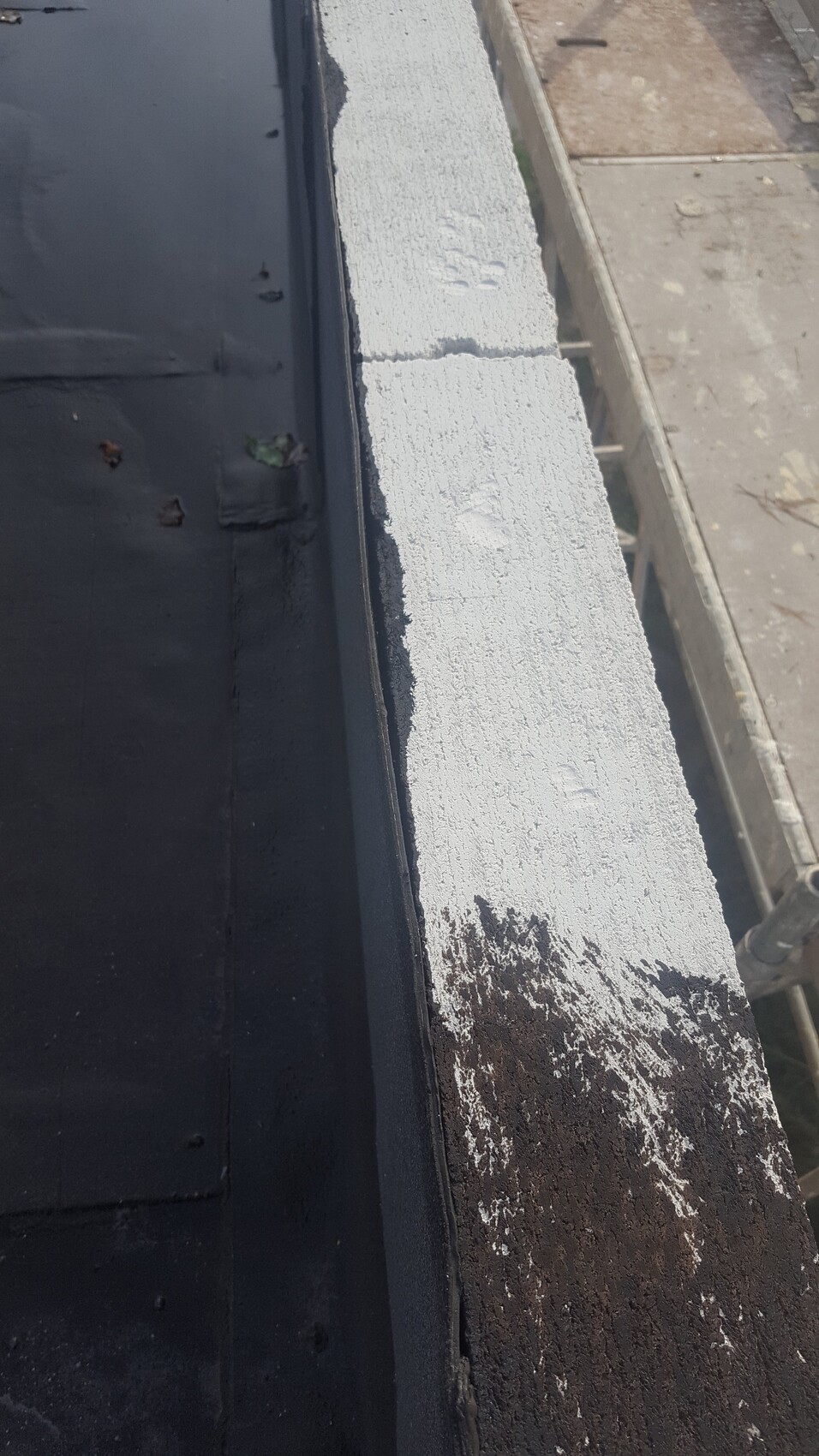

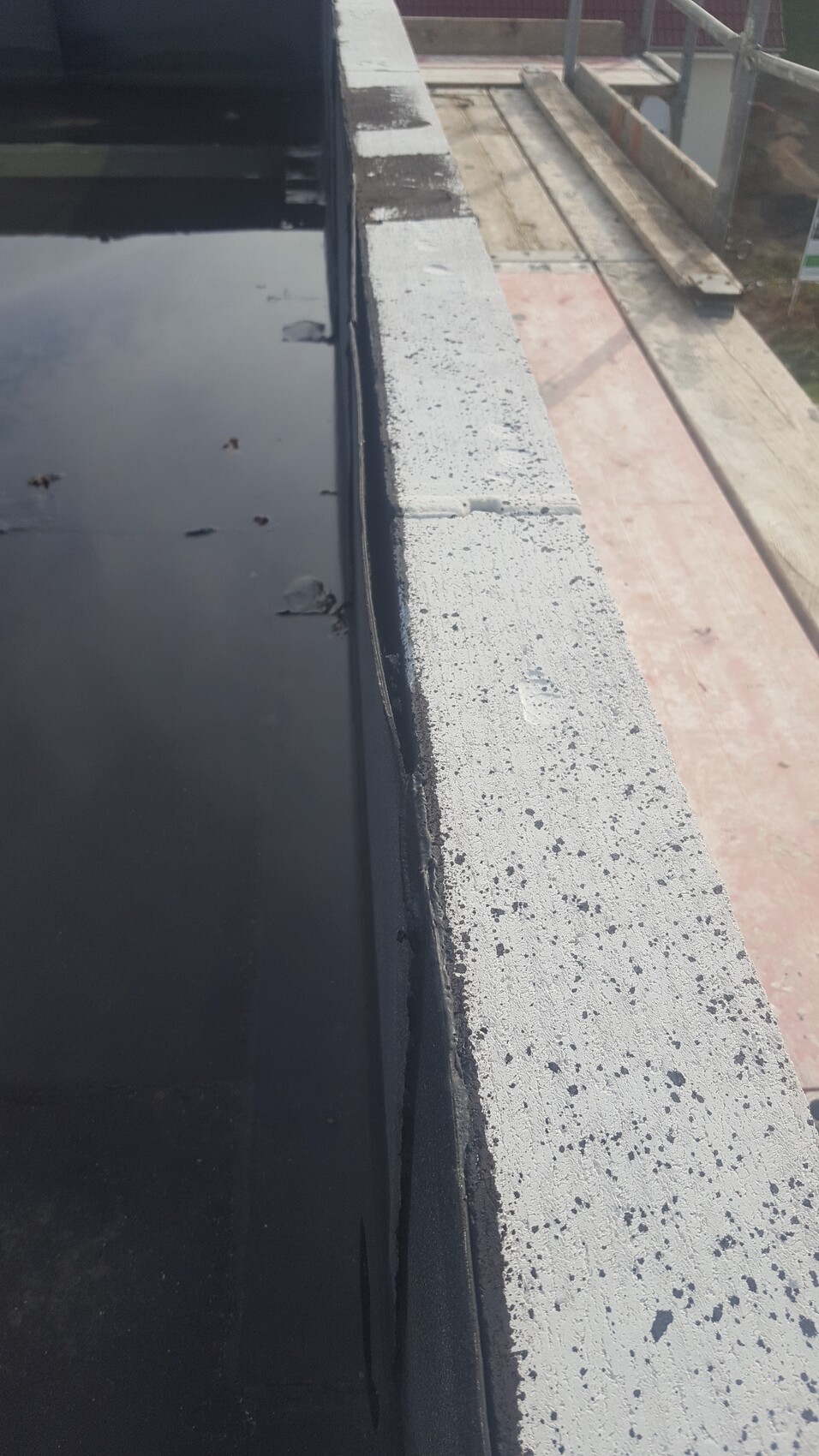

We have exactly the same problem, in the same spots. Also only on the upper floor, but only at one window. We are still in the shell construction phase and building a flat roof. It puzzled me a lot why only this one window on the inside was wet until I went up to the roof and basically saw the fault for myself.
We had two days of heavy rain here, and apparently the water from the roof seeped through the gap in the parapet into the masonry and from there into the window.
Karstenkrass20 Oct 2019 12:18According to the engineering office, this should be resolved with the roof sealing work.
