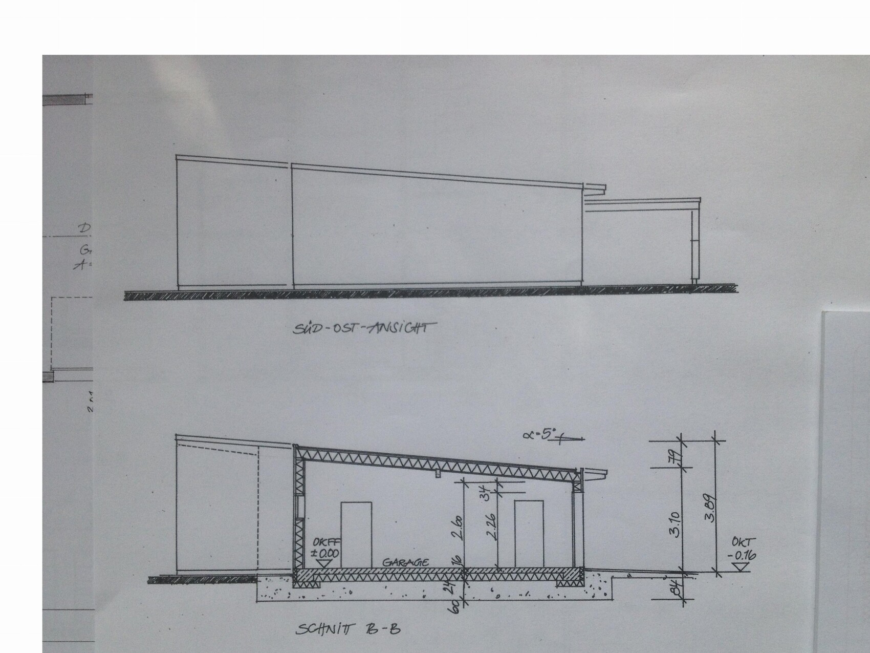

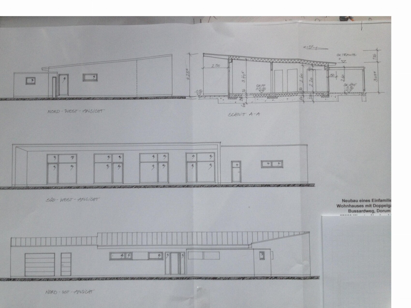

The plan is for a single-story bungalow with a shed roof designed for two people. The roof pitch will be between 3 and 5 degrees, so quite flat, to keep the living room height just under 3 meters (9.8 feet) while allowing for a ceiling height of 2.6 meters (8.5 feet) in the entrance area.

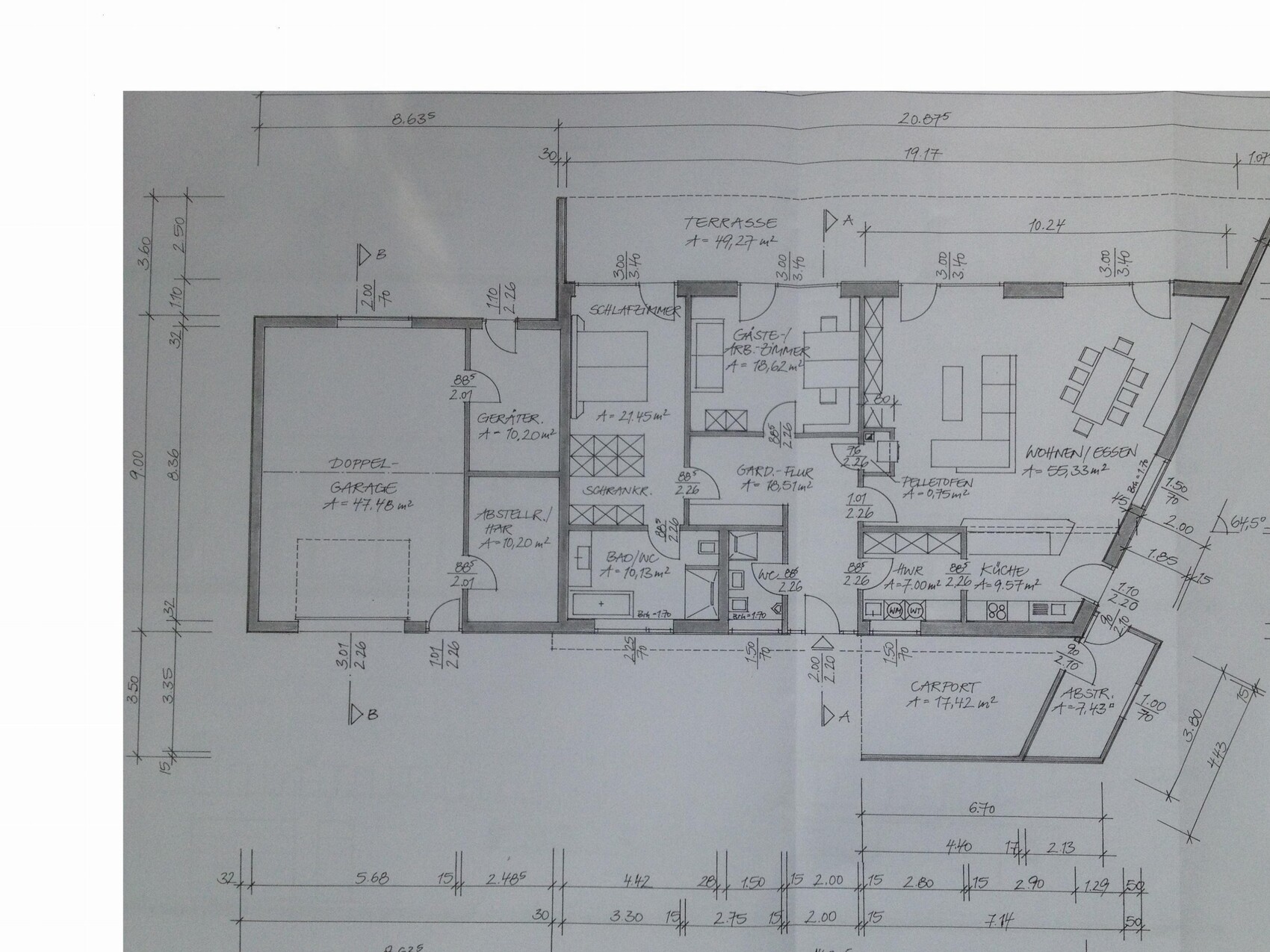

Living, sleeping, office/guest room, and bathroom will face southwest. A glass facade across the entire width of the house is being considered here (similar to the H_F house).
On the northeast side, a garage measuring 9.0 by 7.0 meters (29.5 by 23.0 feet) is planned.

I’ll upload the floor plan and would appreciate both positive and negative feedback.

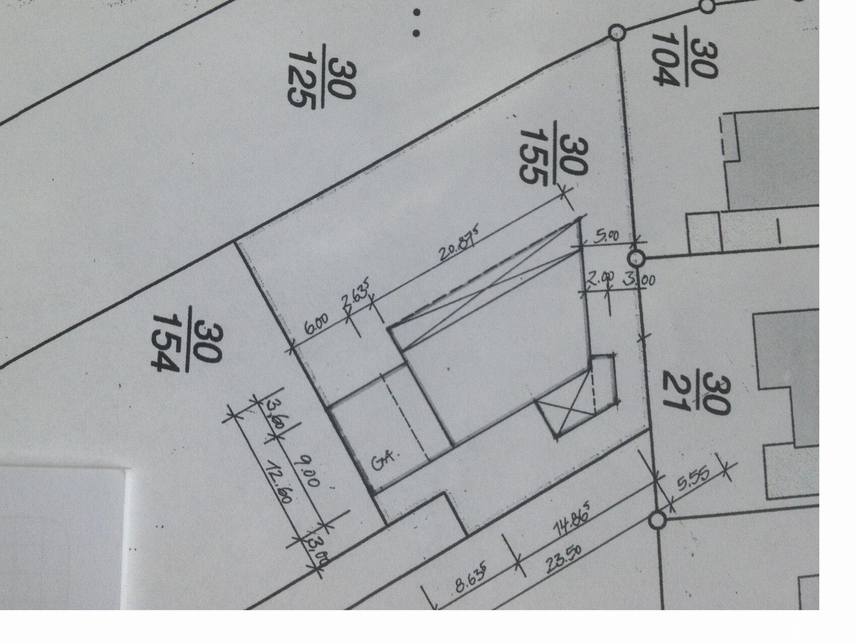

From the preliminary design to the status for the building notification, there have been some changes in the garage area. The garage has now been reduced to 9 m (30 feet) but has expanded up to the property boundary. I didn’t see any possibility to mirror the floor plan because building on the boundary would then not be possible, and the street is only 6 m (20 feet) wide at the plot.

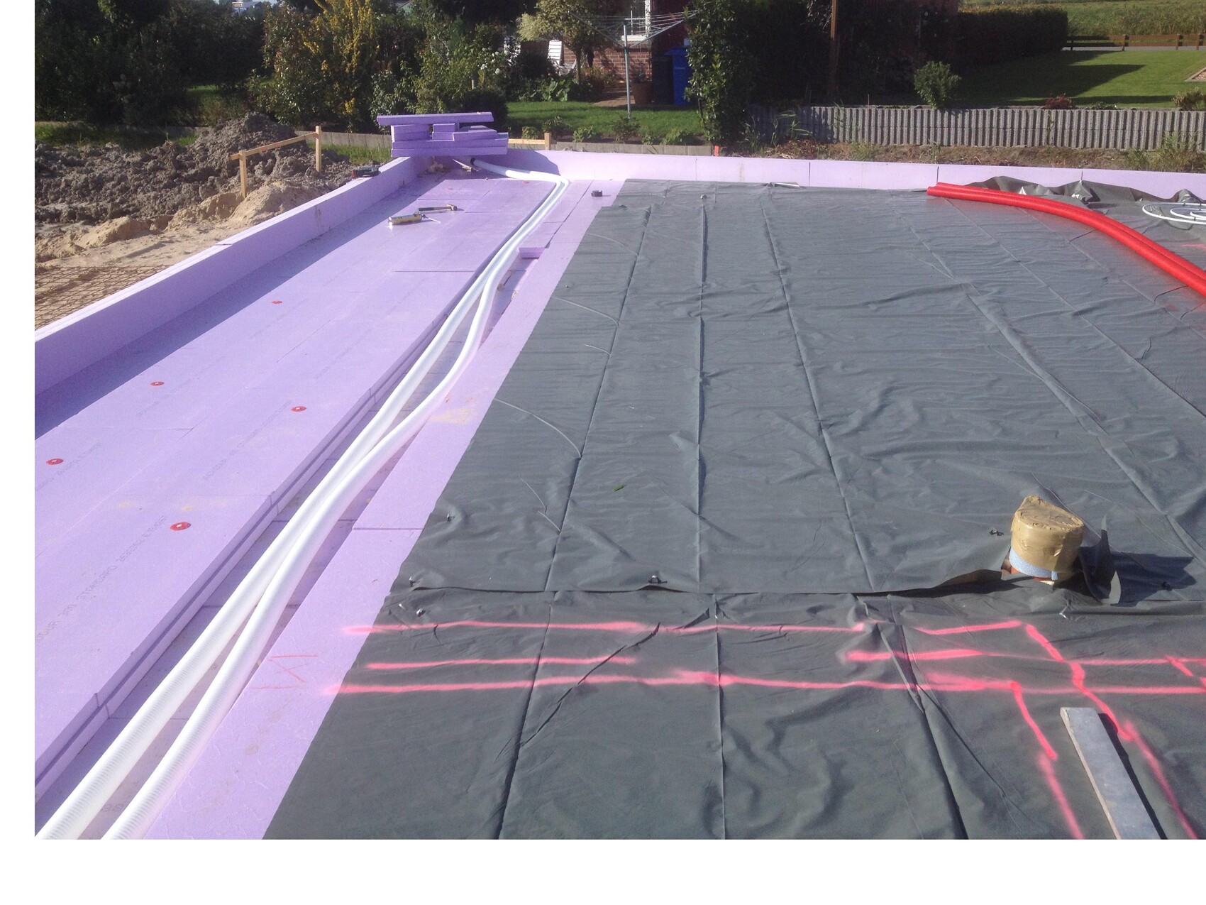

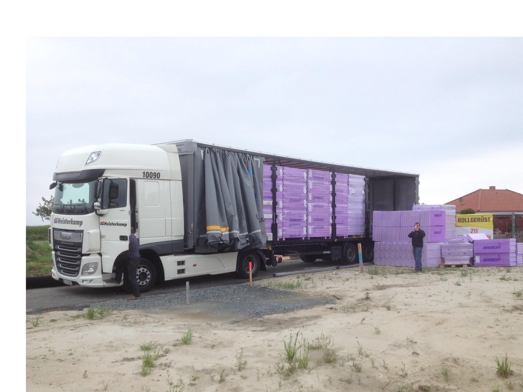

A truckload of perimeter insulation... all for me
Insulation and formwork elements installed.
The second insulation layer contains the supply air ducts
A membrane to prevent concrete ingress
on top of which the underfloor heating, reinforcing steel, and concrete are placed

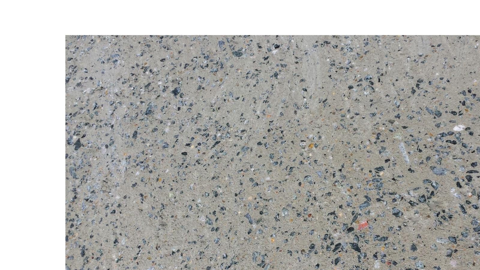

The concrete floor after several days of grinding work with a dual-disc grinder and diamond tools
The surface is still rough, so I need to work on it again, but I’m not quite sure how yet

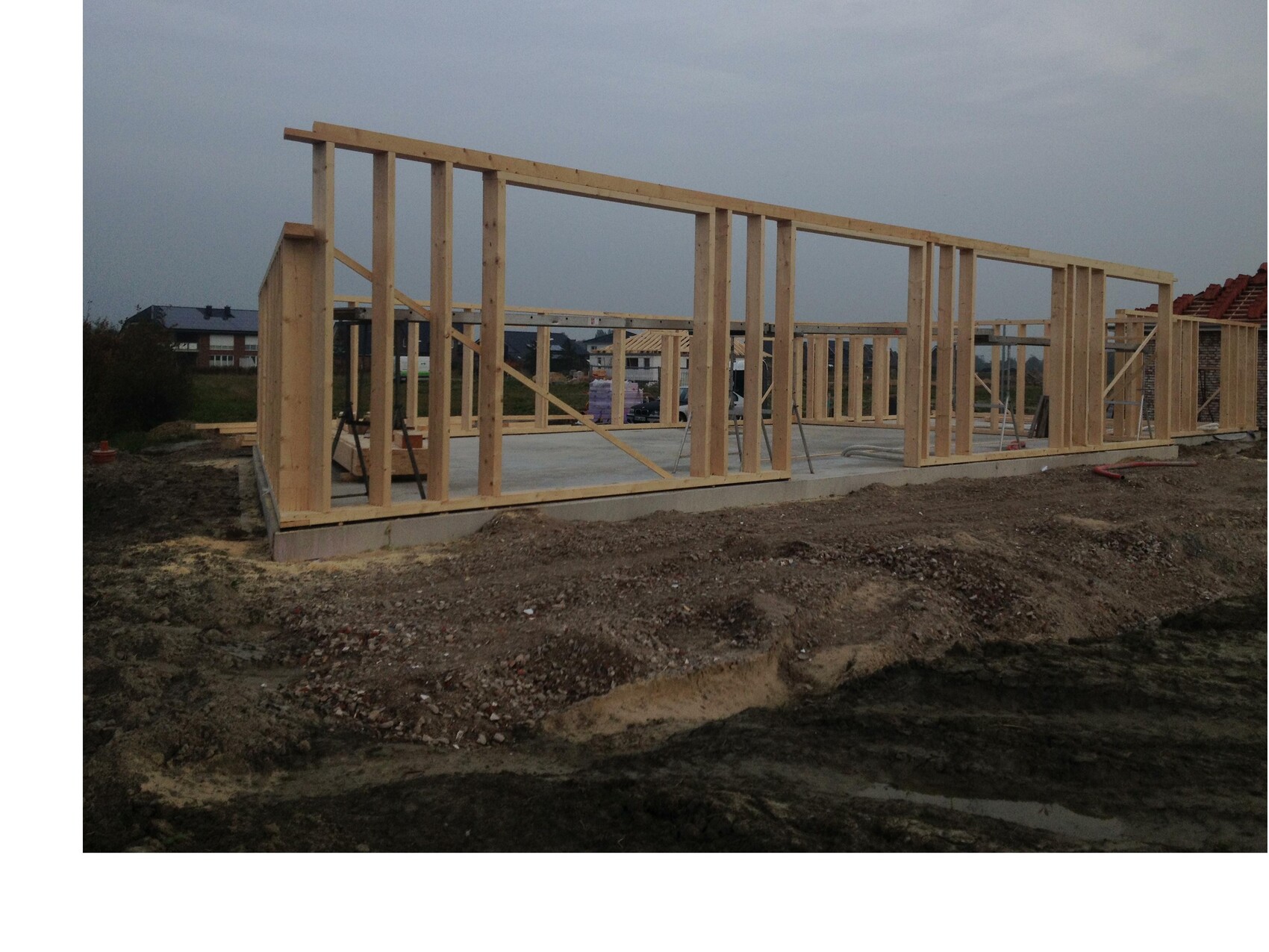

The stud frame is up
to give an idea of the dimensions;
I can comfortably walk under the scaffolding visible in the window openings at my height of 187 cm (6.1 feet).
