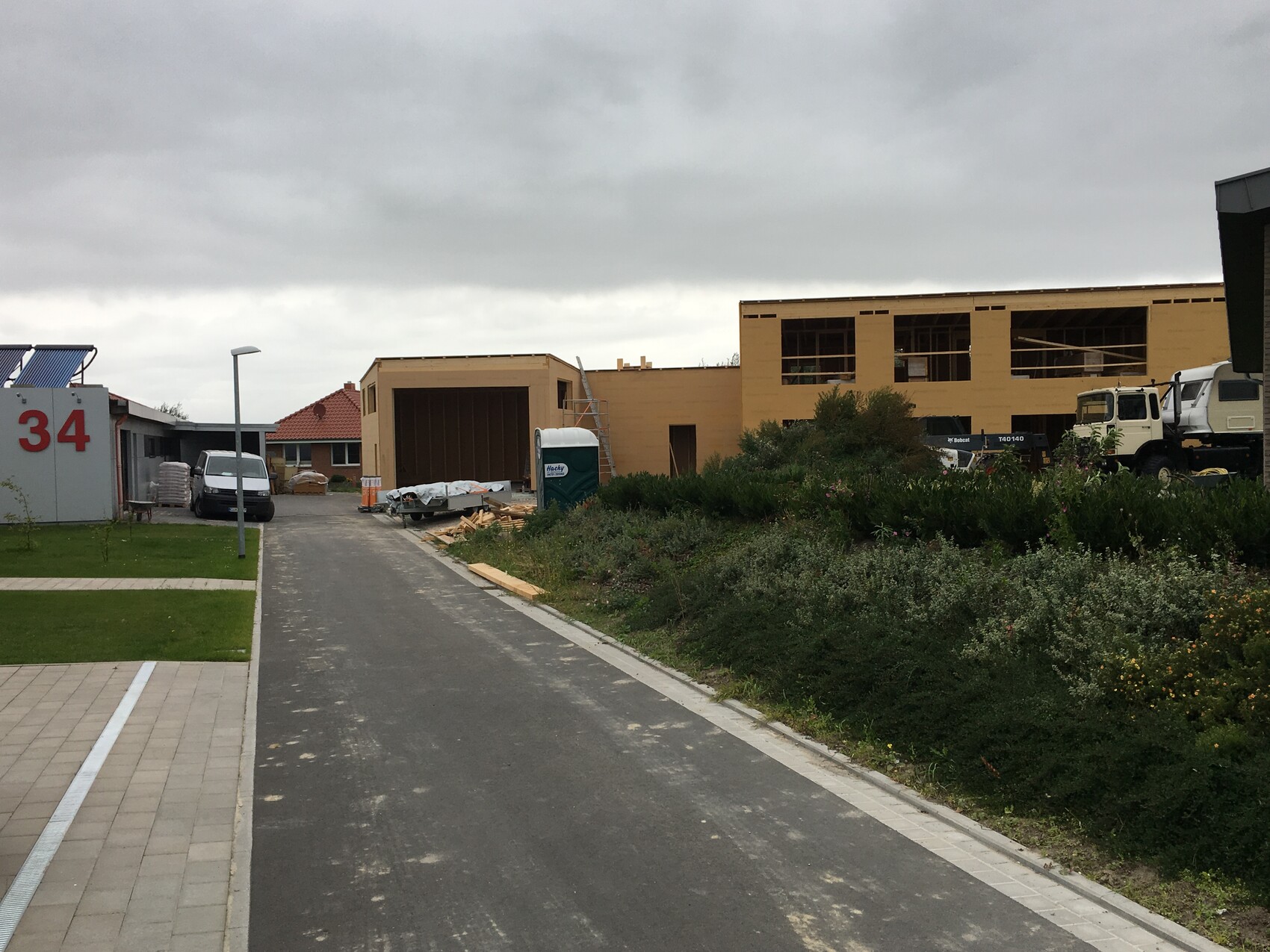

We are now building a single-pitched roof house with two residential units and a large garage.

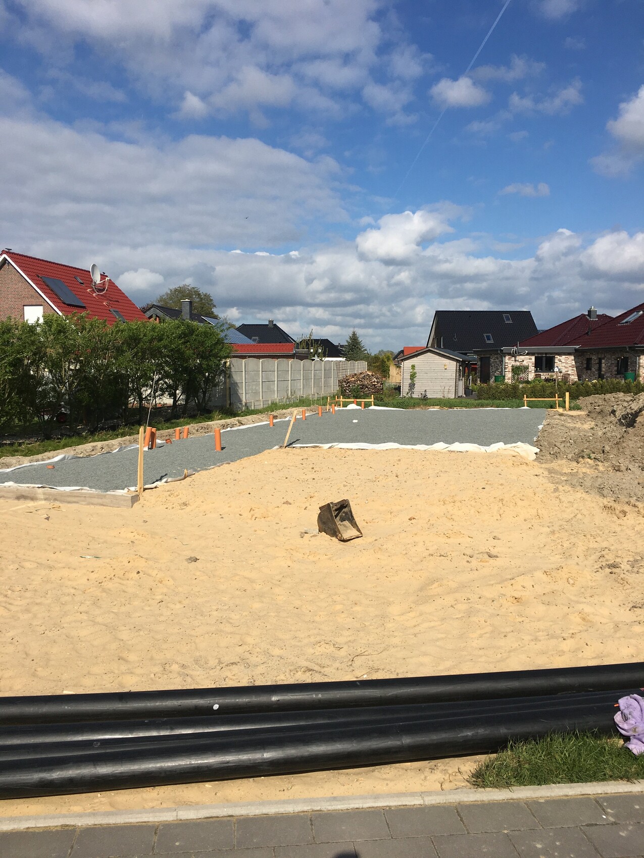

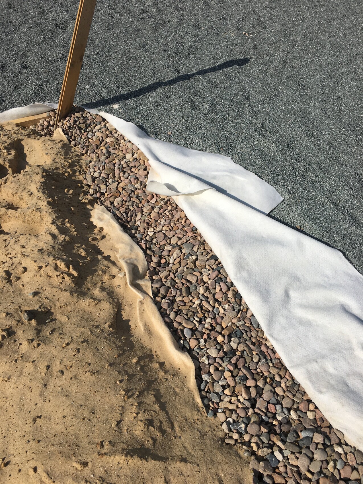

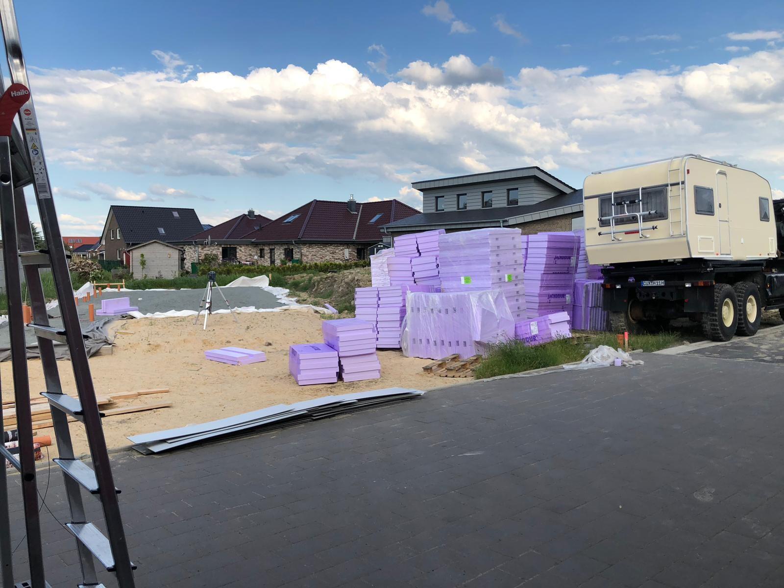

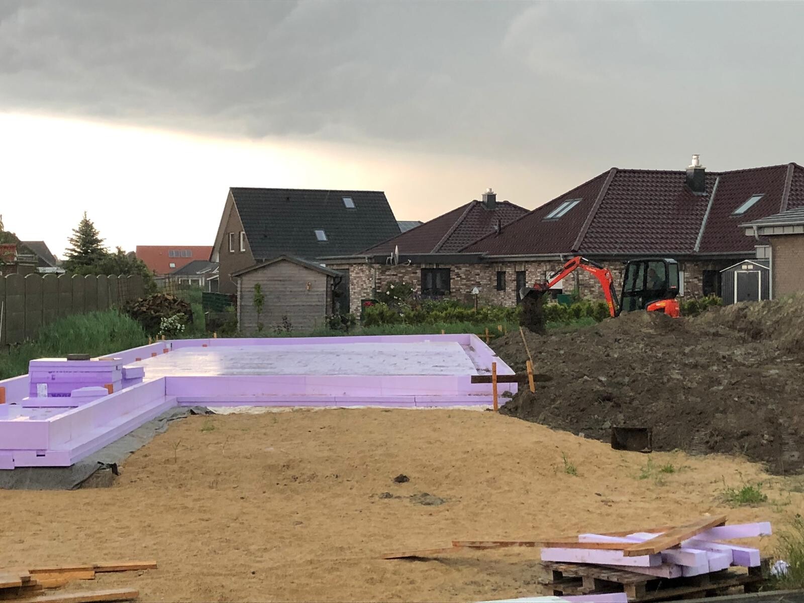

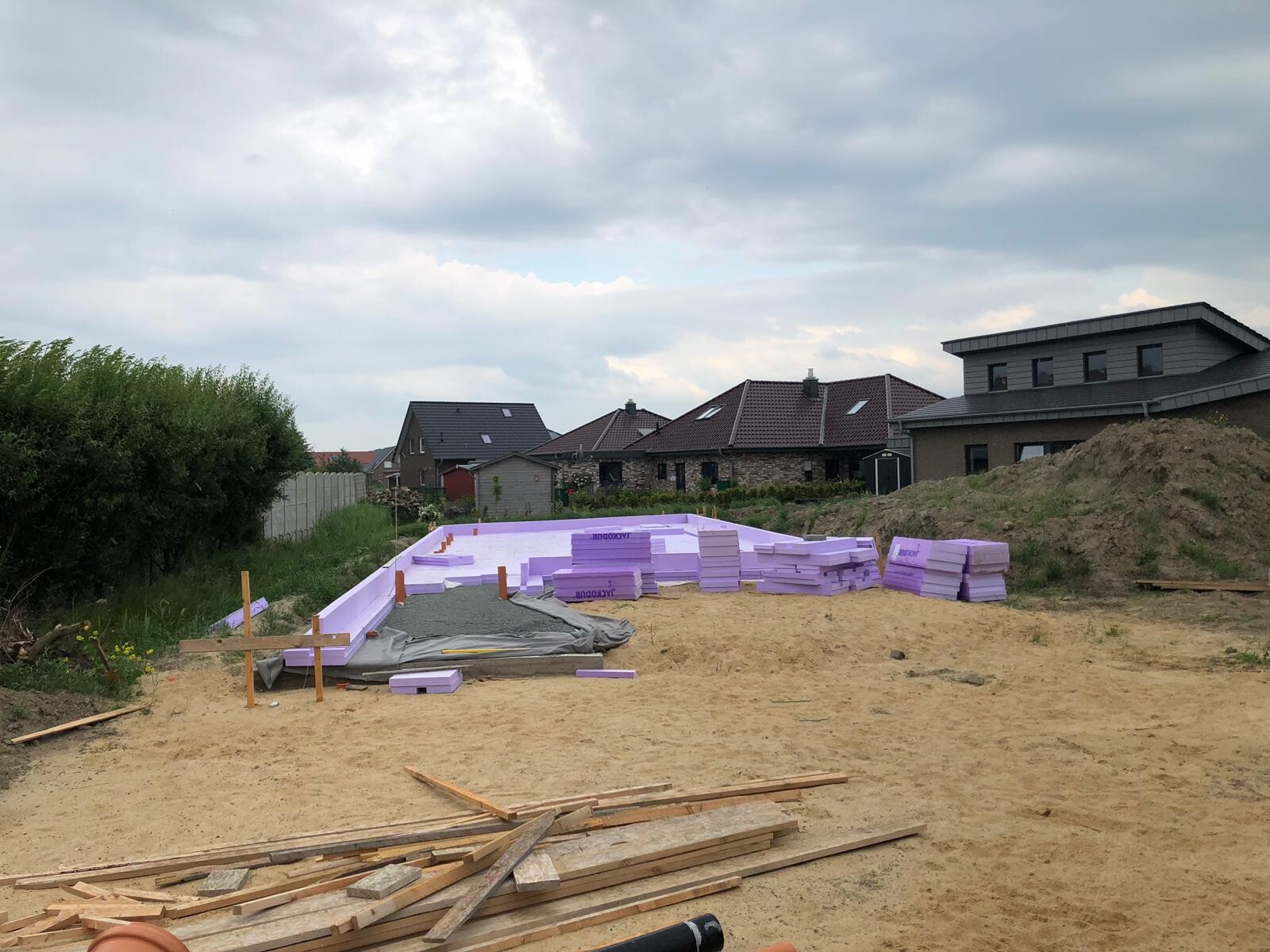

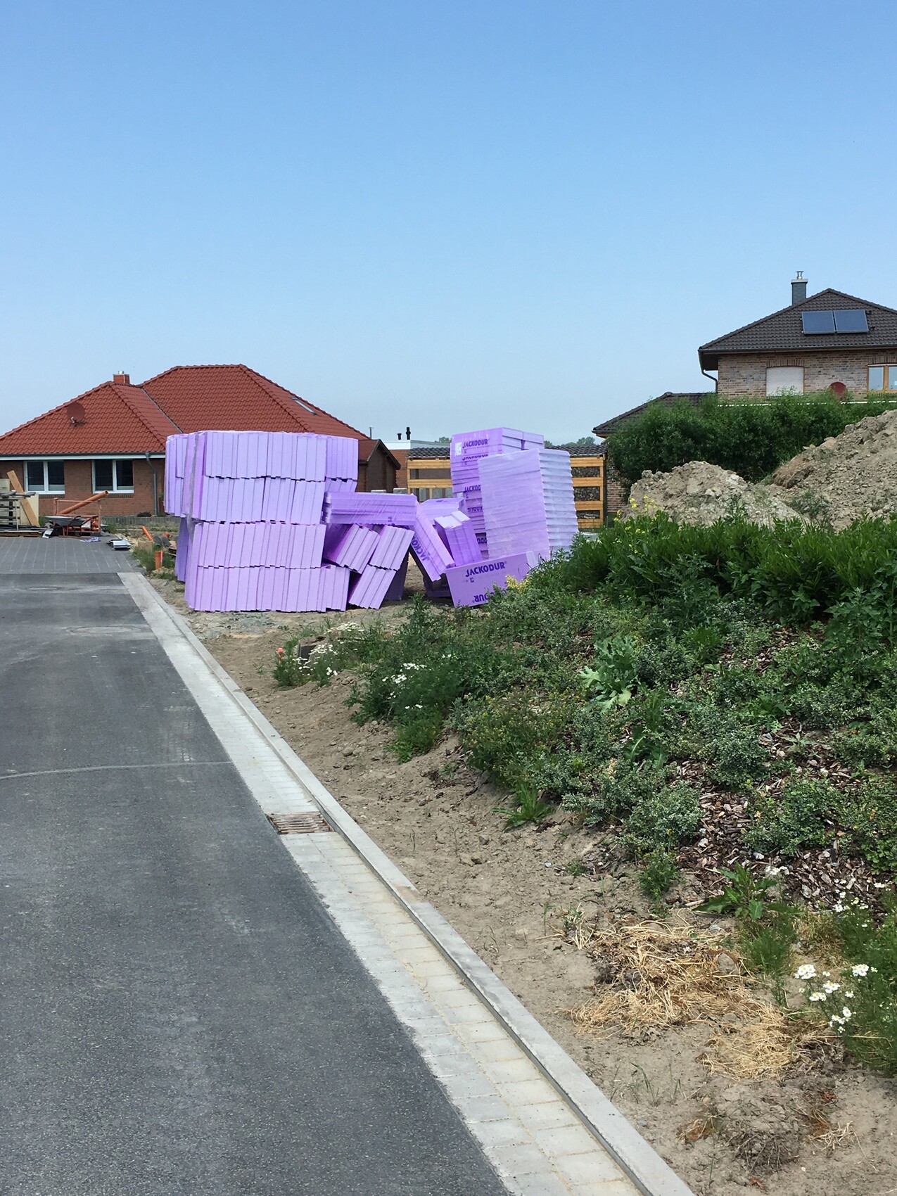

Here are a few pictures

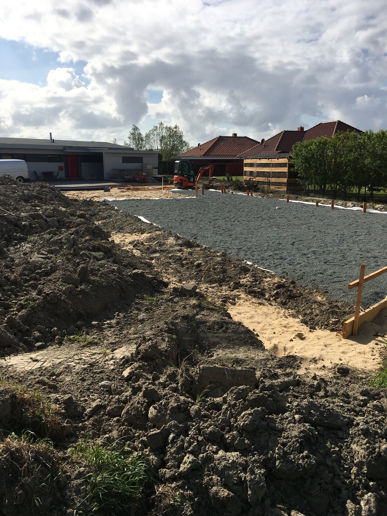

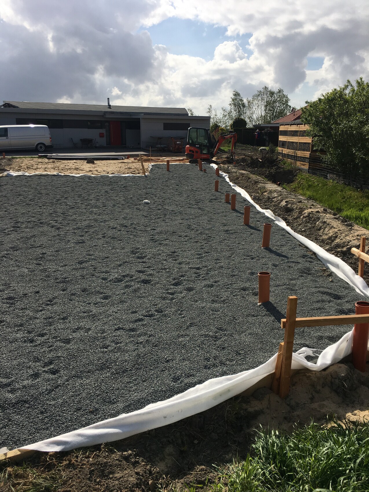

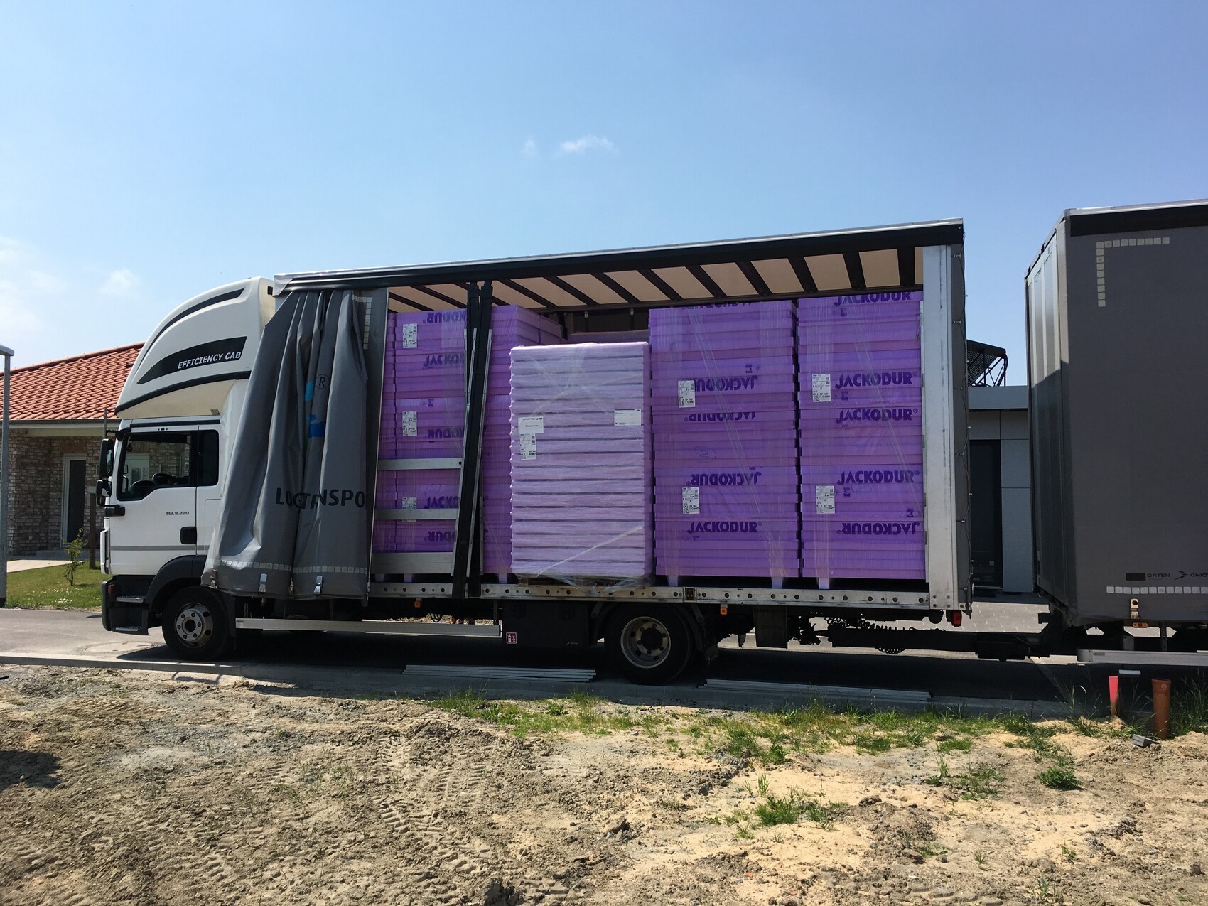

The slab-on-ground will again be constructed using Jakodur Atlas insulation formwork.
Insulation thicknesses are at least 18 cm (7 inches) at the edges, 30 cm (12 inches) across the floor area, with 12 cm (5 inches) formwork.
The base is a sand leveling layer, followed by a separation layer, 30 cm (12 inches) of 16/32 mm gravel, another separation layer, and crushed stone.
The garage will have a conventional strip footing.
Olli

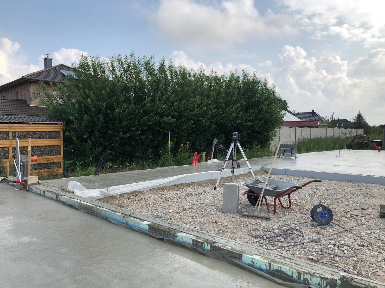

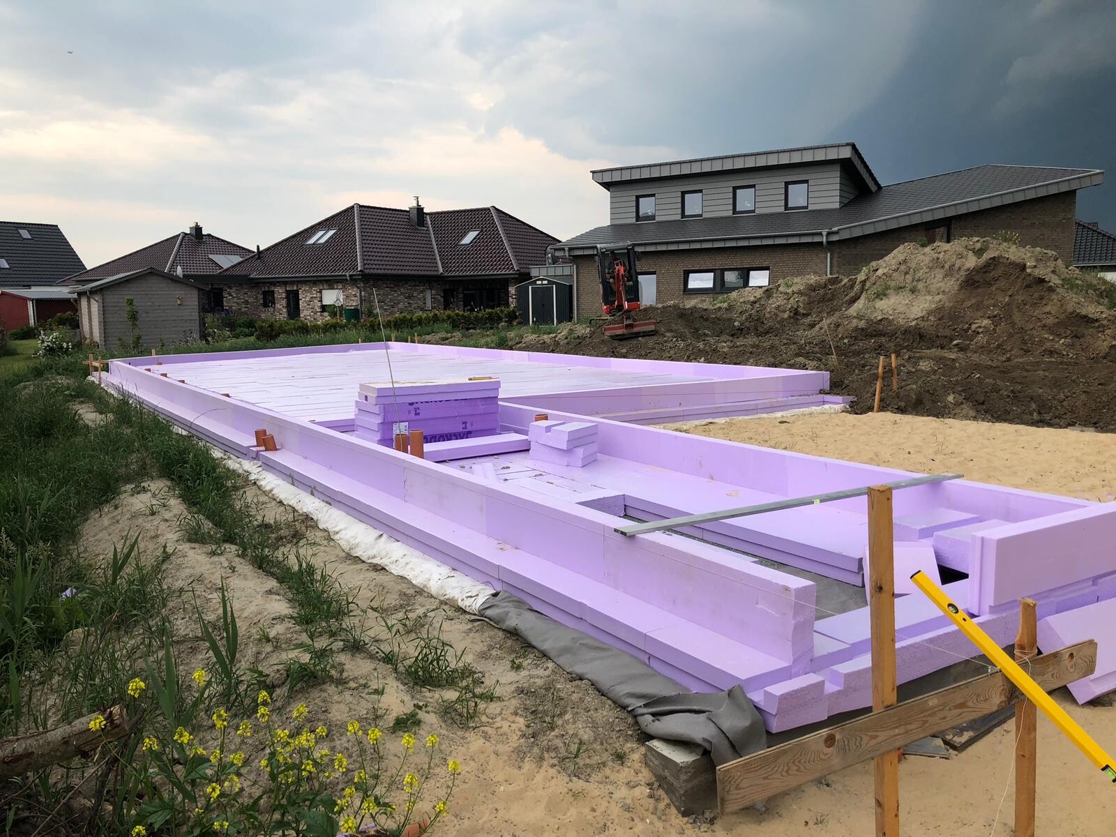

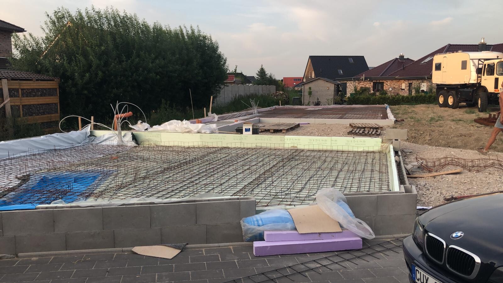

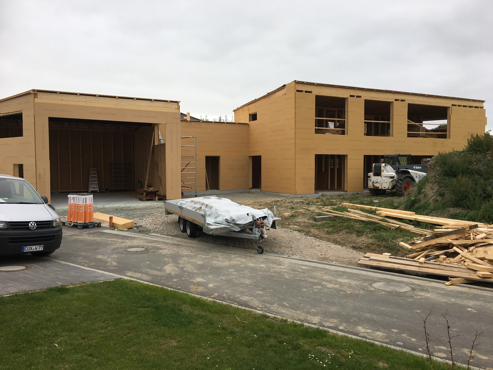

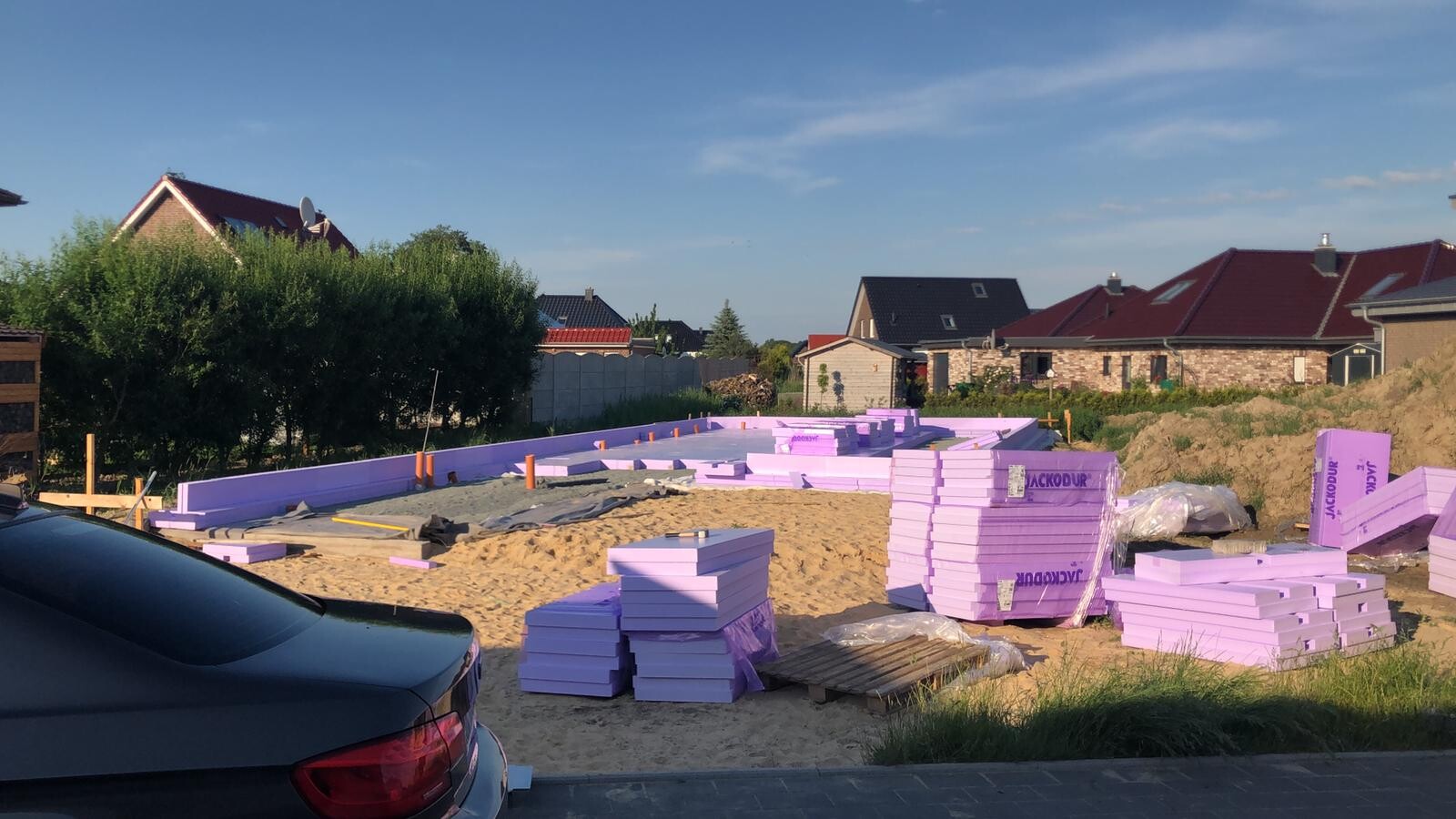

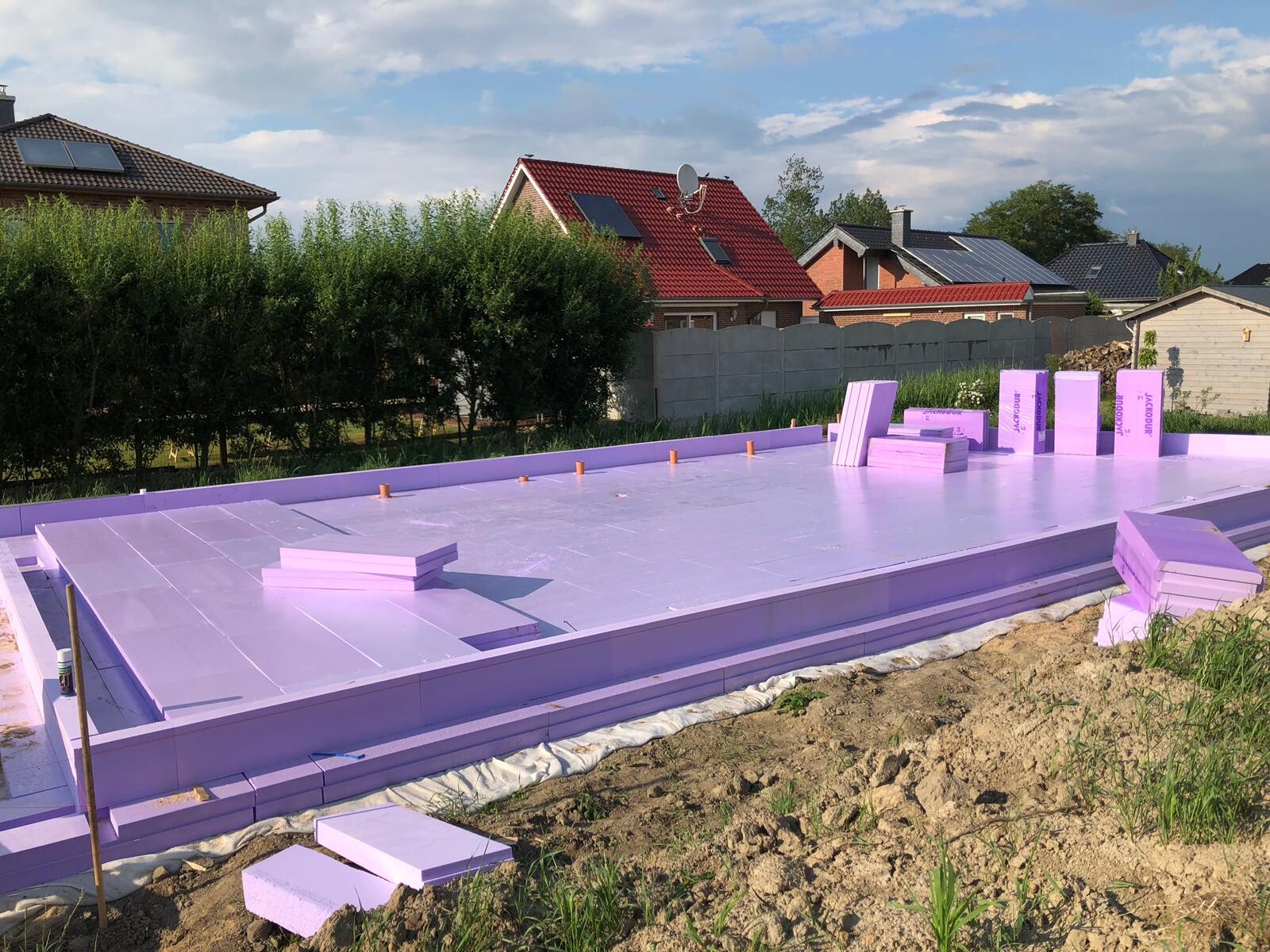

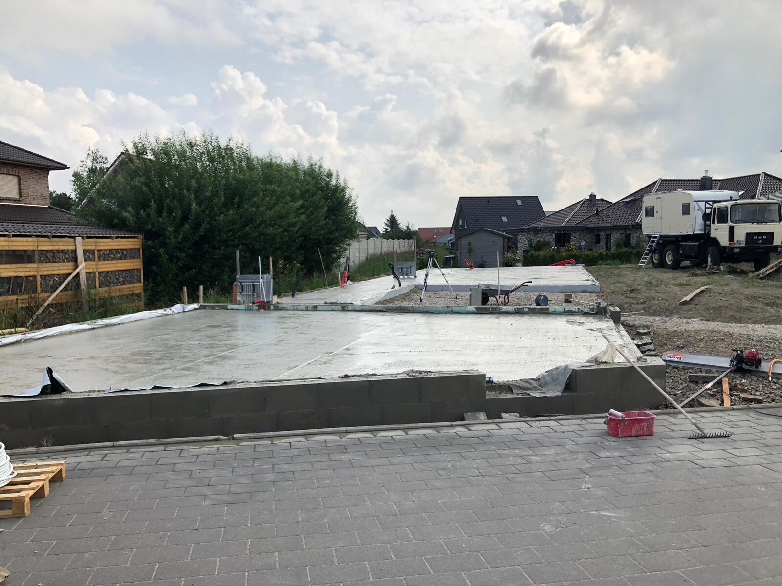

I still owe you a few pictures.
Due to the final road construction and a vacation, there was a 6-week break.

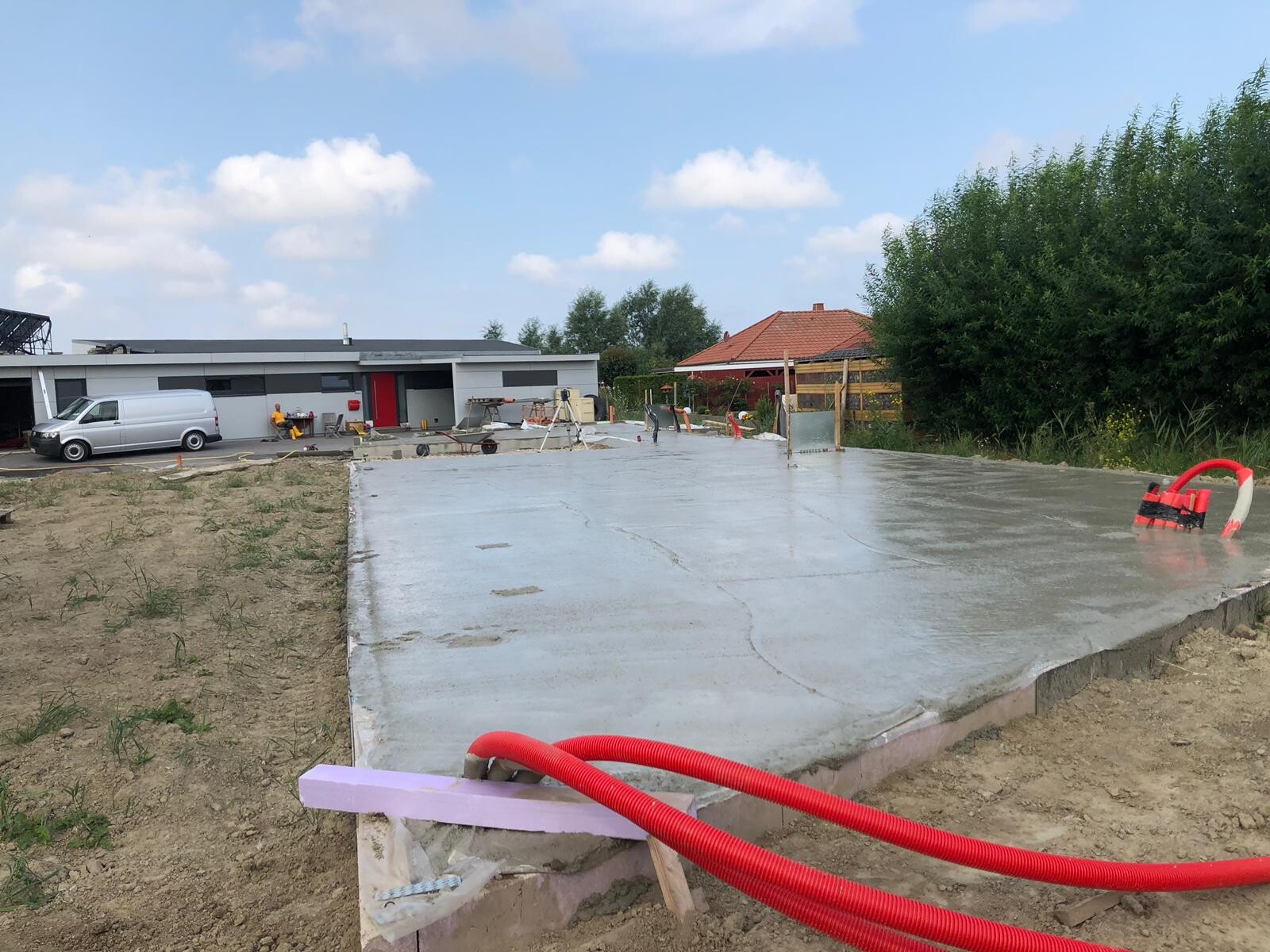

The strip foundation, formwork, and insulation for the garage, as well as insulated formwork for the house and technical room, are now complete.
Underfloor heating and reinforcement have also been installed, and concrete is scheduled for Friday morning.
Pictures of this will follow as well.
Olli

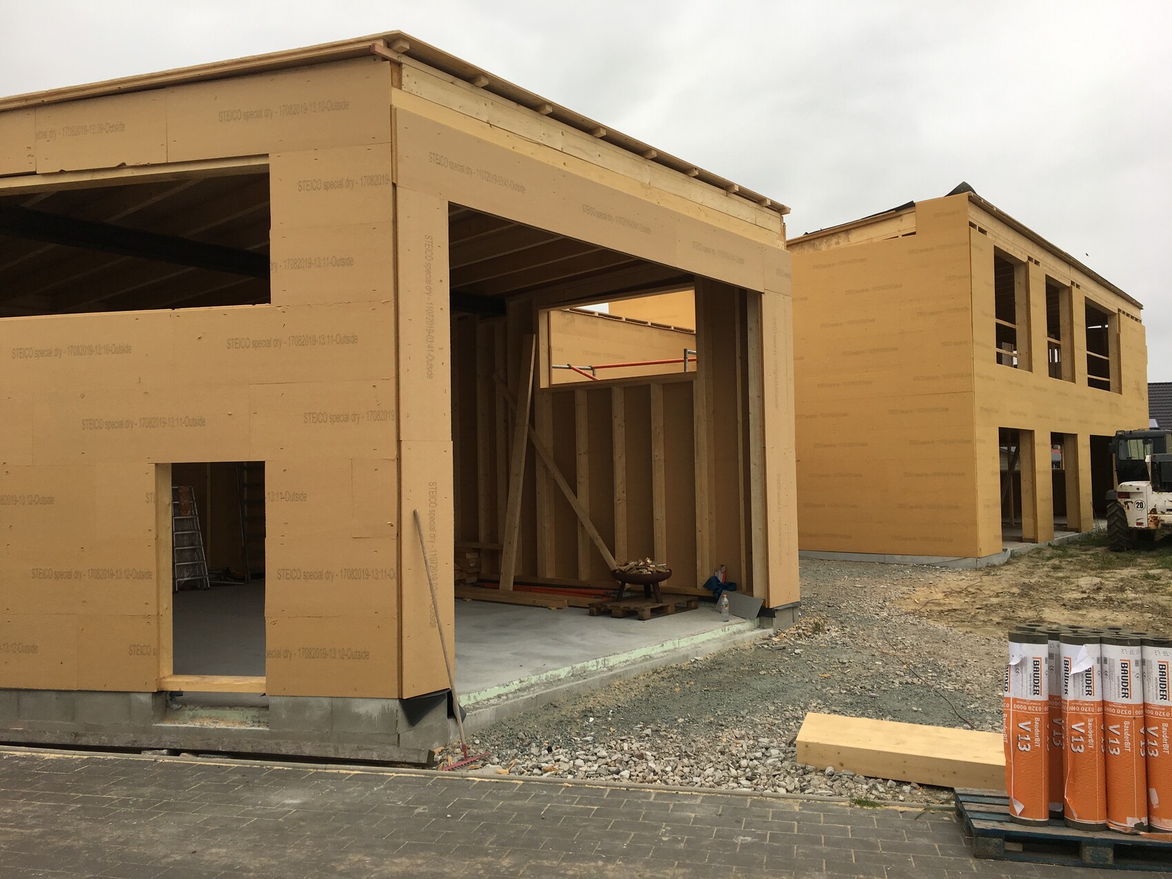

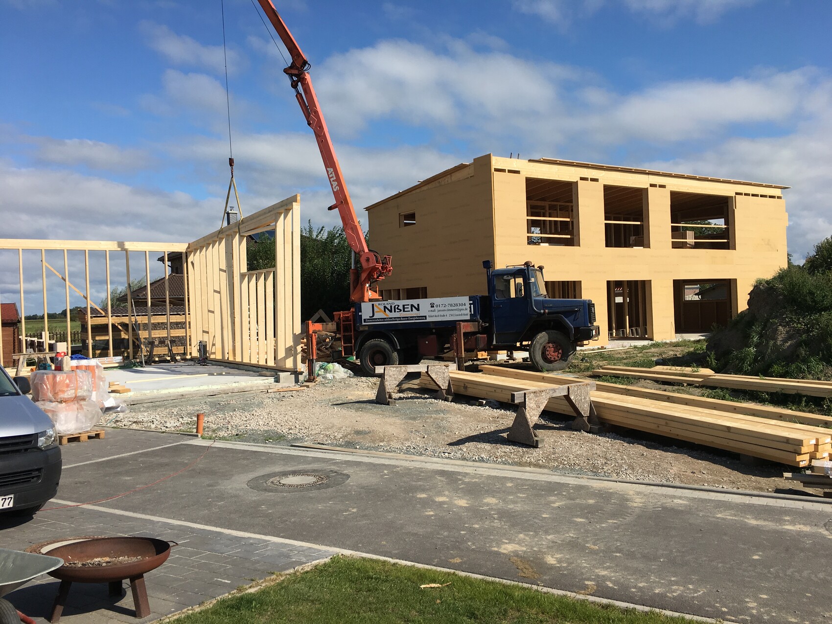

Hello again,
I’ll share updates during the construction process about what we are doing. I will also try to provide an overview of the costs.
The planned construction costs including land, connections, and additional expenses are 320,000€ (approximately $340,000). At that time, the garage was still planned to be unheated.
My goal is to keep the total under 300,000€ (approximately $318,000).
Most of the work will be done as self-build. Earthworks, screed, timber frame construction, and possibly the windows will likely be contracted out.

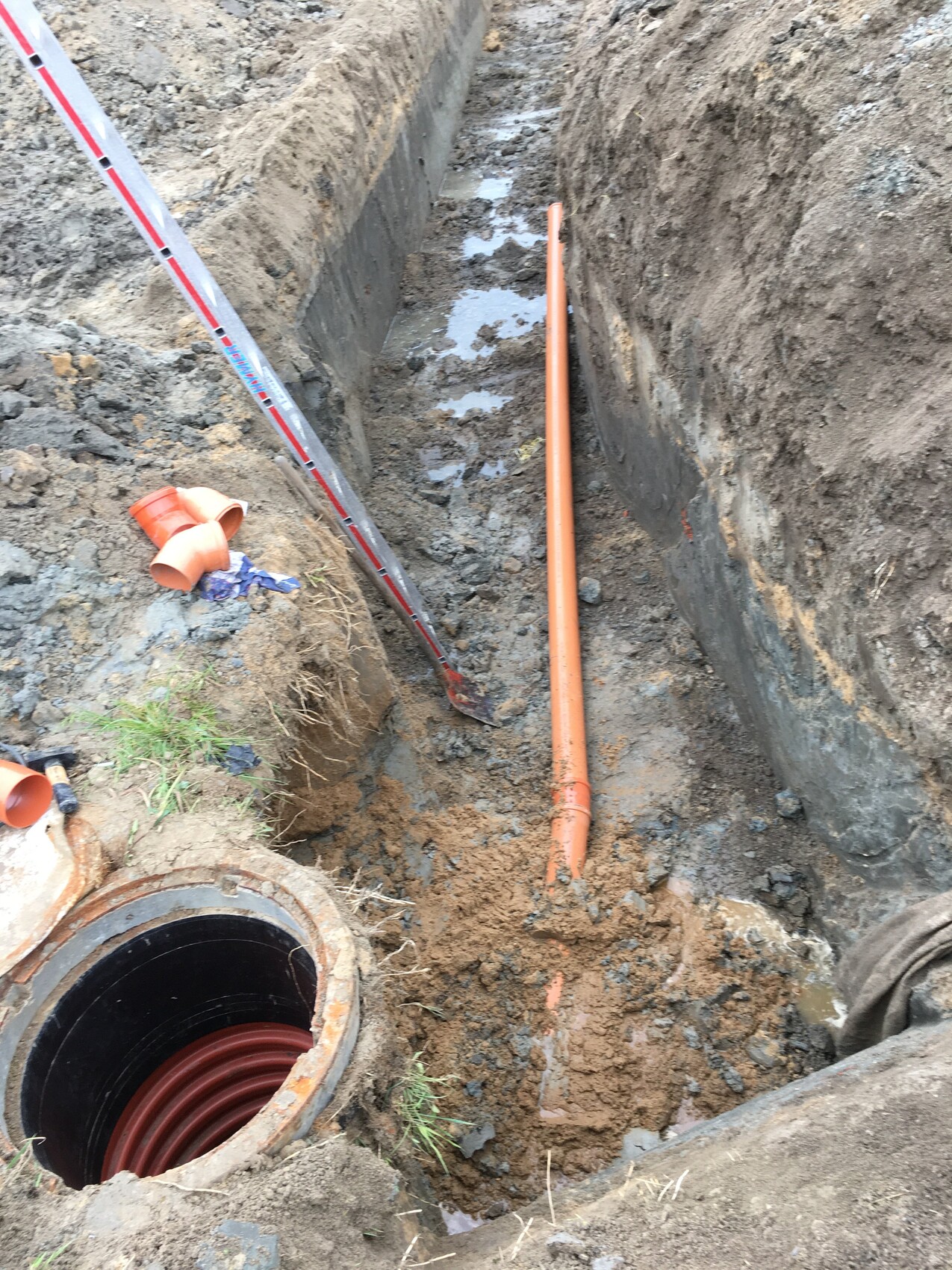

Rainwater and wastewater piping 800€ (about $850)
