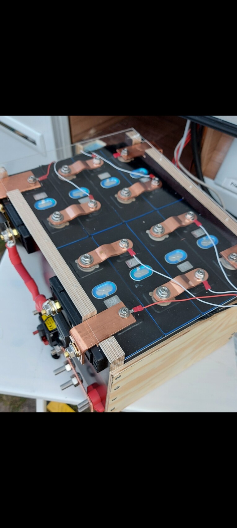

Hausbau 5515 Jan 2022 15:27Last year, I built a battery pack myself using 2 x 200 Ah 12.8V cells sourced from China. I did a lot of research beforehand. Out of the 400 Ah total capacity, you can discharge about 80 to 90%, so you can use approximately 320 to 360 Ah. Previously, I had 2 lead-acid batteries from Büttner, each with 120 Ah. With lead-acid batteries, you can only use about 50% of the 240 Ah total capacity. Switching to LiFePO4 was very beneficial for off-grid living in the motorhome. The motorhome has a 2000W inverter from Solartronics... theoretically, you can run it at 2 kW load for 2 hours.
Our bungalow is almost ready for handover, and the 13.68 kWp (kilowatt peak) photovoltaic system is already operational. Now I am considering whether the motorhome’s battery could also be used in the house.
barfly66615 Jan 2022 16:14@Durran: That really doesn't make sense and what you’re saying isn’t correct (except that you should know what you’re doing, meaning reading up thoroughly).
“Single-phase”? You’re mixing things up. Multi-phase comes from the inverter if that’s what you want.
@Hausbau 55: Great, looks good. Nothing stands in the way of your own DIY battery system!
