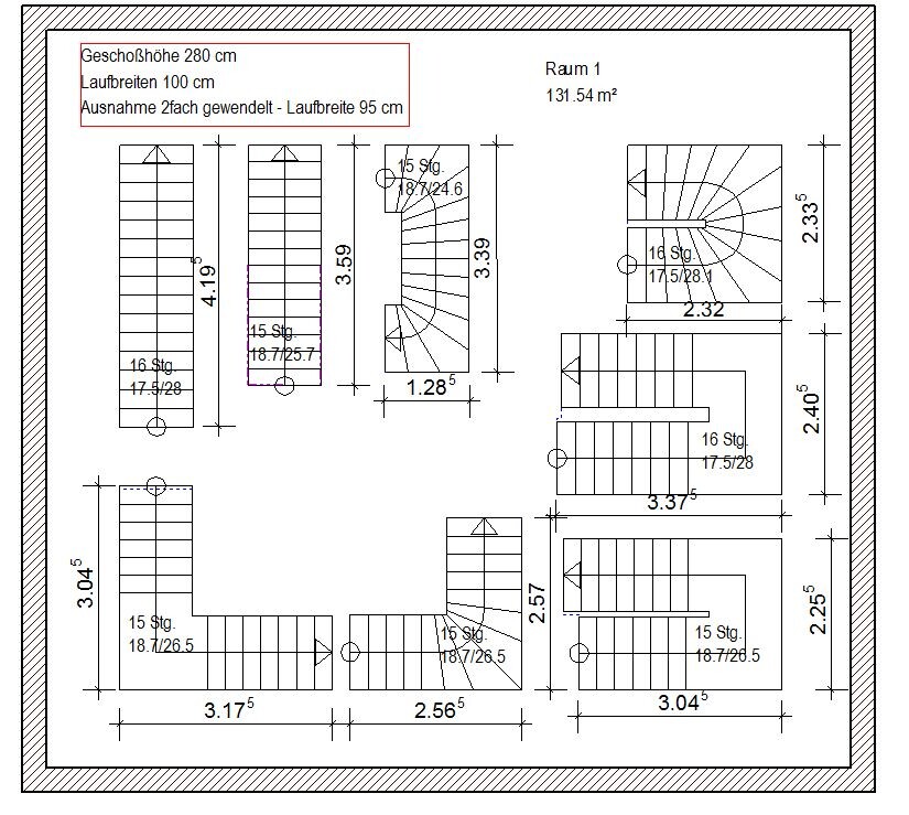

I planned the staircase with a width of 80cm (31.5 inches). I find this sufficient for “just” children’s rooms upstairs. I currently have the same in my terraced house and manage well with it. I have even carried very bulky items, such as a sofa, upstairs.
I imagine the attic floor plan simply as shown in the attachment. The green rectangle should approximately represent the 2m (6.6 feet) ceiling height limit.
Unfortunately, I cannot estimate to what extent the stairwell will need to be enlarged.
