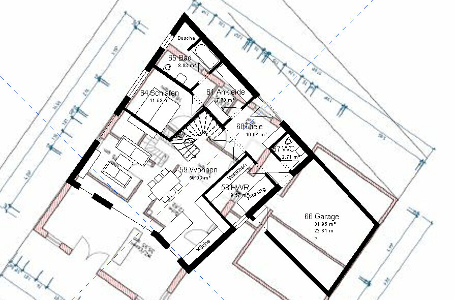

Hello everyone and Happy New Year.
I have been following along for quite some time since my partner (31) and I (33) are now ready to start building our house.
For the past few weeks, I have been working on the floor plan and would appreciate some feedback—perhaps you will spot areas for improvement. North is at the top of the site plan.
Plot size – 754 sqm (8109 sq ft) in the northern part of Mecklenburg-Western Pomerania
Floor area ratio – 0.25
Building envelope, building line, and boundary – 17 x 20 m (56 x 66 ft)
Edge development – garage on the property boundary
Number of parking spaces – 2
Number of stories – 1 full floor
Roof type – 25° hipped roof according to the development plan
Architectural style – bungalow as per the development plan
Maximum heights / limits – eaves at 4.2 m (14 ft) above street surface
Owners’ Requirements
Basement, floors – no basement, but attic expandable with knee wall about 1 m (3 ft)
Number of occupants, age – 2 people, first child due in July, second planned at some point
Ground floor: kitchen, living room, bathroom, master bedroom, small guest room / office
Upper floor: children’s room
Utility room adjacent to the living room, where an aquarium will be built into the wall
Dining space for up to 8 people
Fireplace
Garage and double carport
Designer:
- Do-it-Yourself by us
Personal budget for house including fittings: 180k
Preferred heating system: gas condensing boiler + controlled ventilation system
Good luck Kai

@BeHaElJa ... not bad .. 😉 I had also considered extending the house like that. So far, I just hadn’t come up with a good solution for the sharp corner. The shower is great.
A hip roof might be complicated, and unfortunately, that’s probably a requirement.
And no, don’t move the garage too far forward, then there won’t be any space for a car in front of it.
