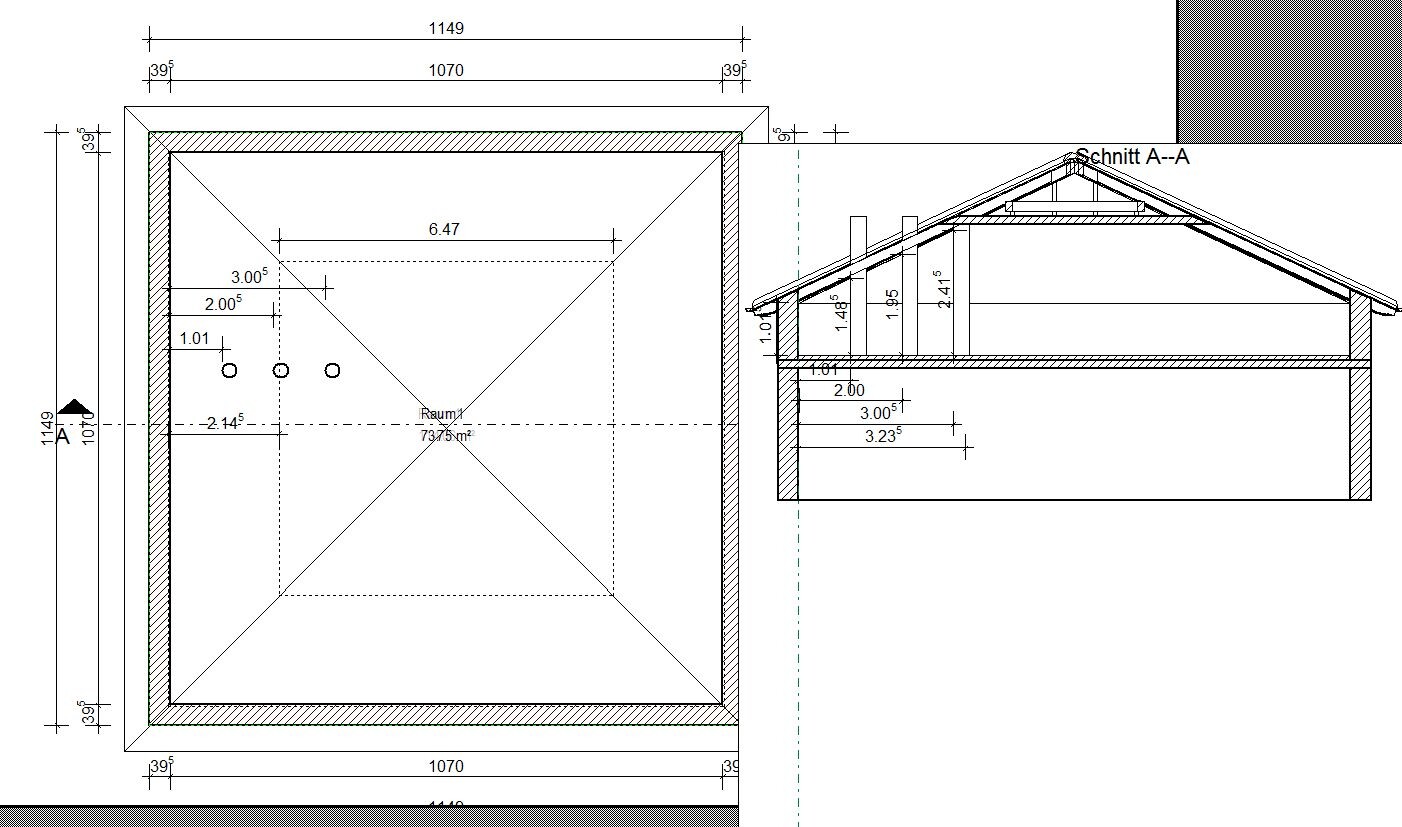

For the past few weeks, I have been working on the floor plan and would appreciate some feedback—perhaps you will spot areas for improvement. North is at the top of the site plan.

So, what kind of windows are planned for the roof? Only skylights? And where do you see 60 sqm (645 sq ft) with a standing height of at least 200 cm (79 inches)? I only see just under 42 sqm (452 sq ft).

Okay, the 60 sqm (645 sq ft) was my mistake; I had considered a knee wall height of 1.25 m (4 ft 1 in). Ultimately, I want to fully use the 4.2 m (13 ft 9 in) eave height (even if it might look a bit odd from the outside for a bungalow).
The lighting in the attic floor is planned to come from roof windows, or are there other options? (Dormers are not allowed).
