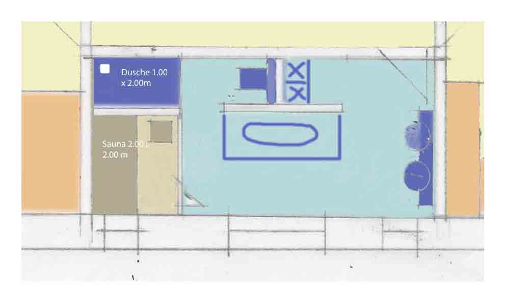

We will probably revisit the floor plan for the upper floor, possibly reduce the size of the office and maybe remove one room to provide more space for the children. However, we will stick to the bathroom size. Besides, I haven’t yet come up with the perfect idea on how to fit everything into 16m² (172ft²) 🙁

If anyone has any creative ideas about the bathroom layout, I would be grateful, since we are really stuck on that one. Thanks!
Bauexperte5 Sep 2014 22:32youpy1978 schrieb:
If anyone has any creative ideas regarding bathroom layout, I would really appreciate it because it’s quite a puzzle for us. Thanks!The shower, sauna, toilet, and cabinets can also be rearranged.
Best regards, Bauexperte
